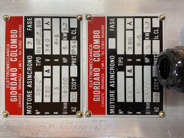

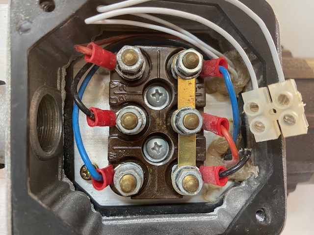

I have purchased a 5hp colombo spindle and a 10hp baldor/abb vfd to upgrade my cnc router from its 3.25hp portercable router. I have also pourchased a 12g 6 wire SAB vfd cable. I will be running the vfd of of 220 30amp single phase, which the vfd says I can do. I have no been able to find any information for pairing this spindle to a vfd. It has 2 small white wires that ive been told are for heat protection, but im not sure how to hook up or program this feature to the vfd, as I cant find a manual for the spindle. If anyone has any information on how to get this going it would be greatly appreciated.

In the picture of the wiring connections for the spindle, The 3 brass jumpers (jumping from stud 1-2 and 2-3) are configured for 380V. For 220v the jumpers need to be turned 90 degrees so the jump across all 3 wire studs. If I remember correctly, the other 2 wires are for the fan. It could be 24VDC or 220VAC you will have to verify. as for the programing of the inverter, call whoever you purchased it from and see what they can tell you. Otherwise, the key programming elements are Voltage (220VAC), Amperage (15A), Frequency (0-300 (Max rpm/60)), and how you are controlling the RPM. Analog (0-10VDC) is common, but other methods are used on more complex machines.

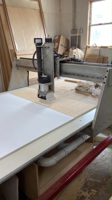

Thanks. The machine is a 2004 Warthog 4x8. I purchased a new controller for it that runs UCCNC control software, which I am told is similar in function to mach 3, but better. It is currently not set up for spindle control, so I will need to add this feature as well. The fan is shaft driven, and I have been told on a facebook group that the two white wires are some sort of thermal protection. For the life of me I cant find an operators manual for the spindle. As far as mounting the spindle I am making a new mounting plate out of .5" T6 aluminum.

Here is a picture of the machine
