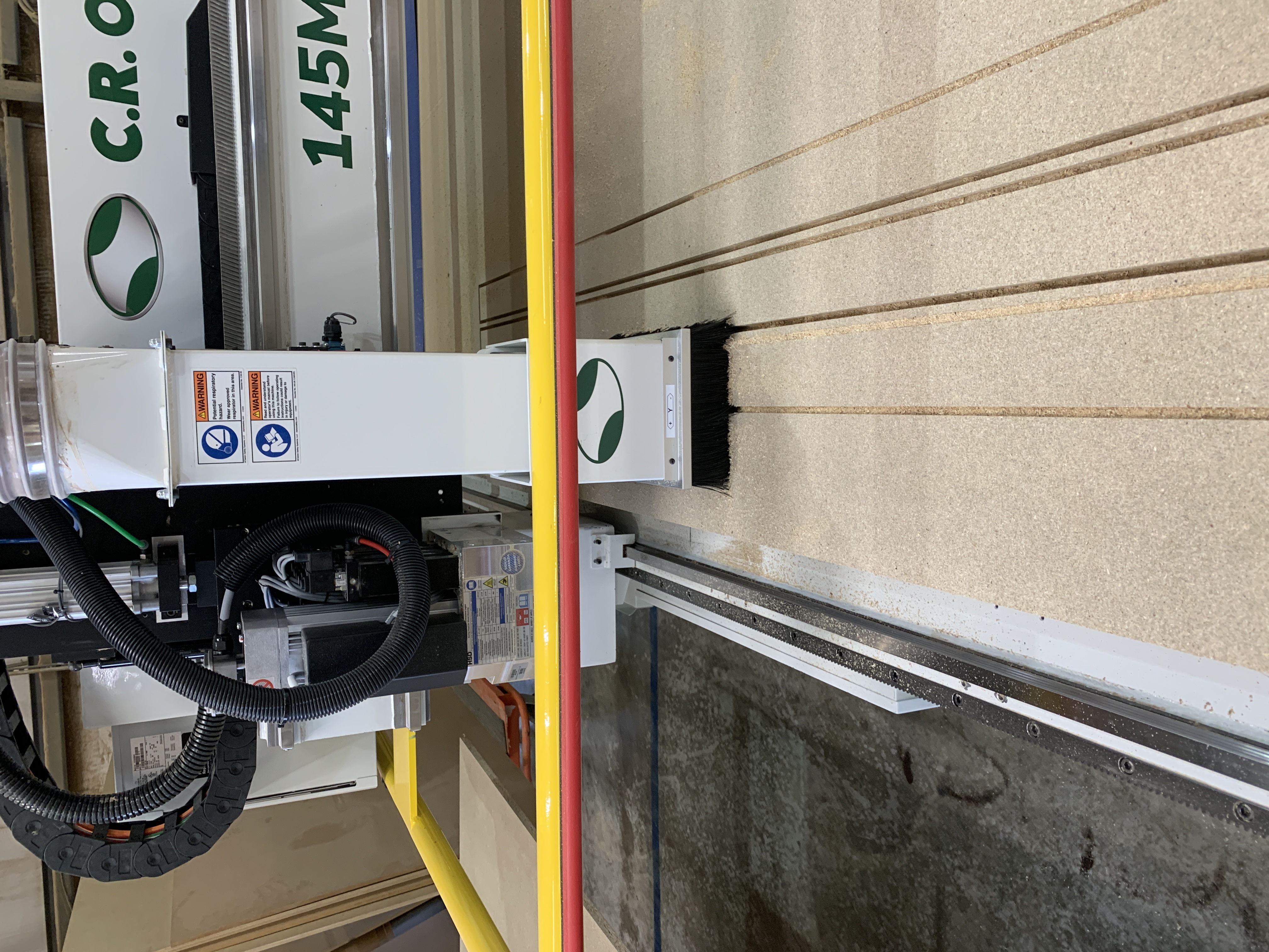

We have 2024 CR Onsrud cnc router we purchased fall of last year and our most recent problem is the Fanuc pendant controller.

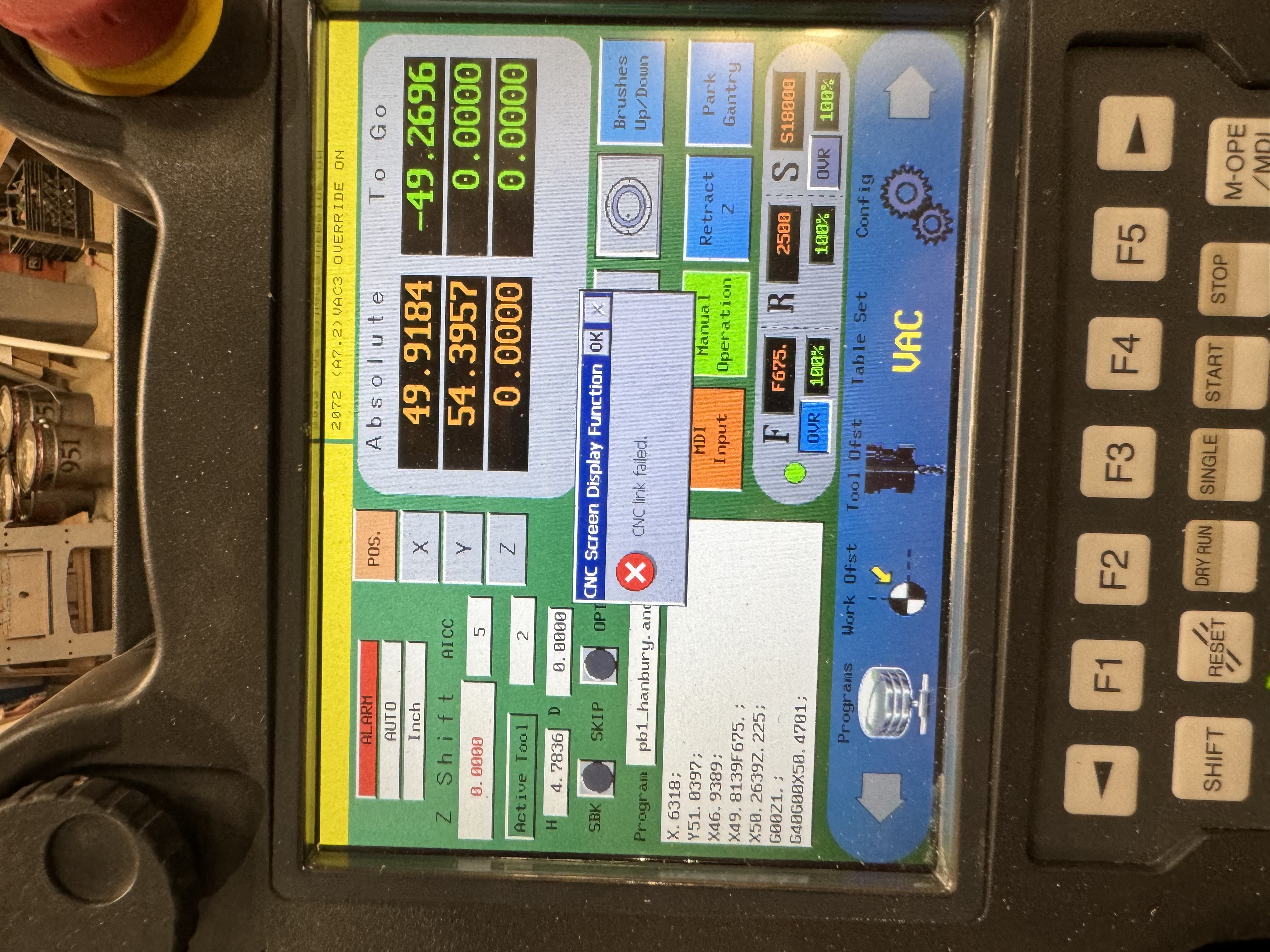

The controller will randomly freeze and lock up. It normally happens while the machine is in operation? But has happened when sitting idle as well. When it occurs the router will stop moving but the spindle will keep spinning until we do a hard power cycle.

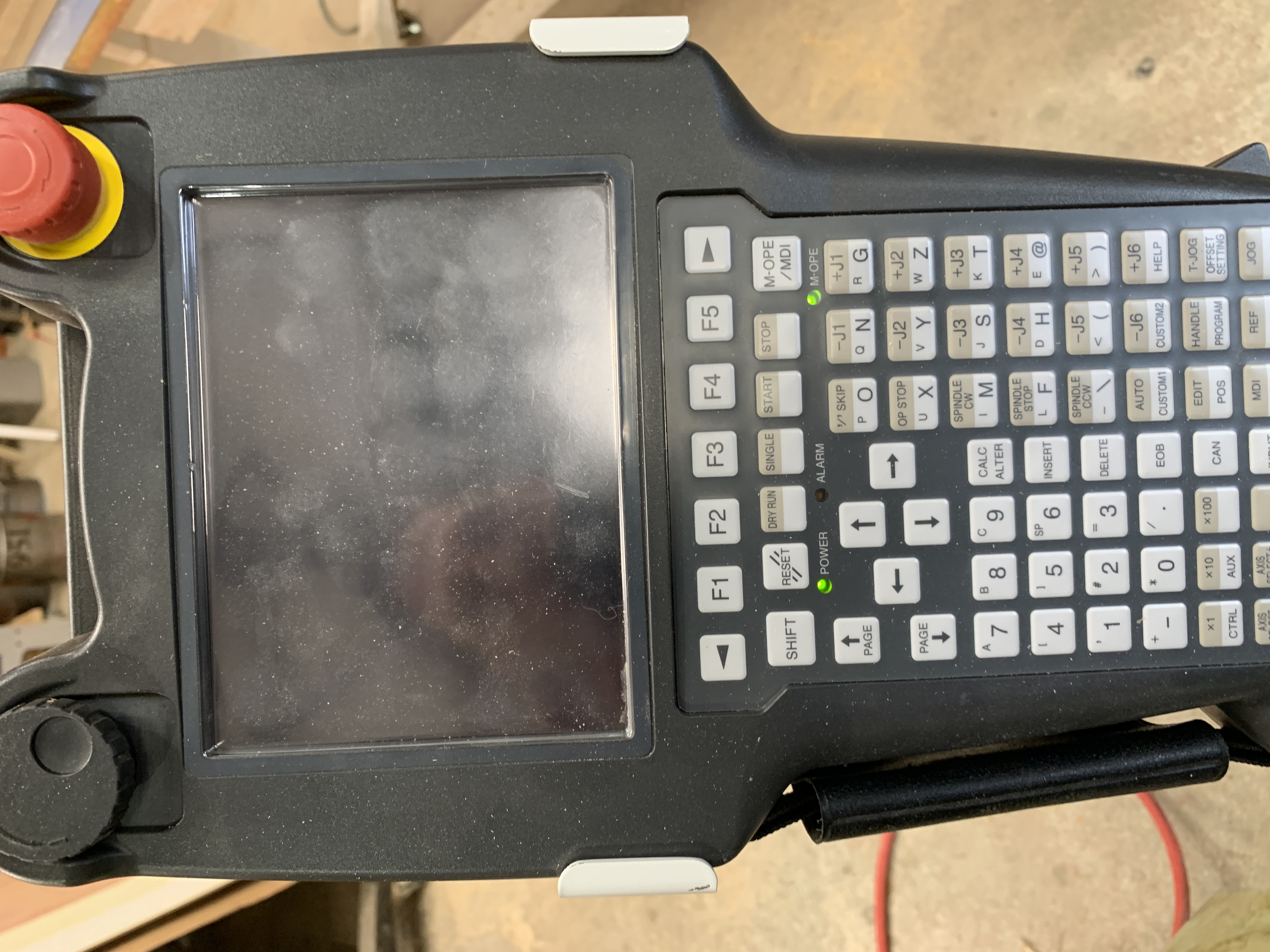

We get a screen that pops up on the controller. However, the only way to get out of the popup window is to shut down the machine since the screen is frozen and we loose all functionality from the handpad. Once the spindle stops spinning, we turn the machine back on.
Most of the time it only takes 1 restart to clear the screen. But on a few occasions we will need to restart the machine a couple times for the screen on the handpad to load properly and function.
CR Onsrud does not cover ethernet wiring under their "2 year full warranty". But since we have had more problems with their machinery than I like to admit. They sent us the cables as a goodwill. But without a warranty the disassembly, removal, and reinstallation of the wiring throughout the cnc was on us. After the service was complete it worked for a week+ and then it just happened again.
There is no rhyme or reason as to why this is happening which makes diagnosing that much more difficult.
I have attached some photos for reference.
Anyways, if anyone has any ideas it would be greatly appreciated. Thank you!

In my experience, randomly occurring issues like this are electrical connections or bad wires 99% of the time. I would power it down and go through the connections at the pendant and the control cabinet. I would also make sure there are no loose connections on the incoming power. if you are dropping a leg momentarily, it could shut the controller down for a quick second locking everything up.

You have a wire that is not connected properly. When you installed the new ethernet cable you probably jostled the wire enough to temporarily make good contact. Onsrud needs to send a tech out to remedy this. if these American companies aren't going to stand by their products we might as well buy Chinese for half the price.
