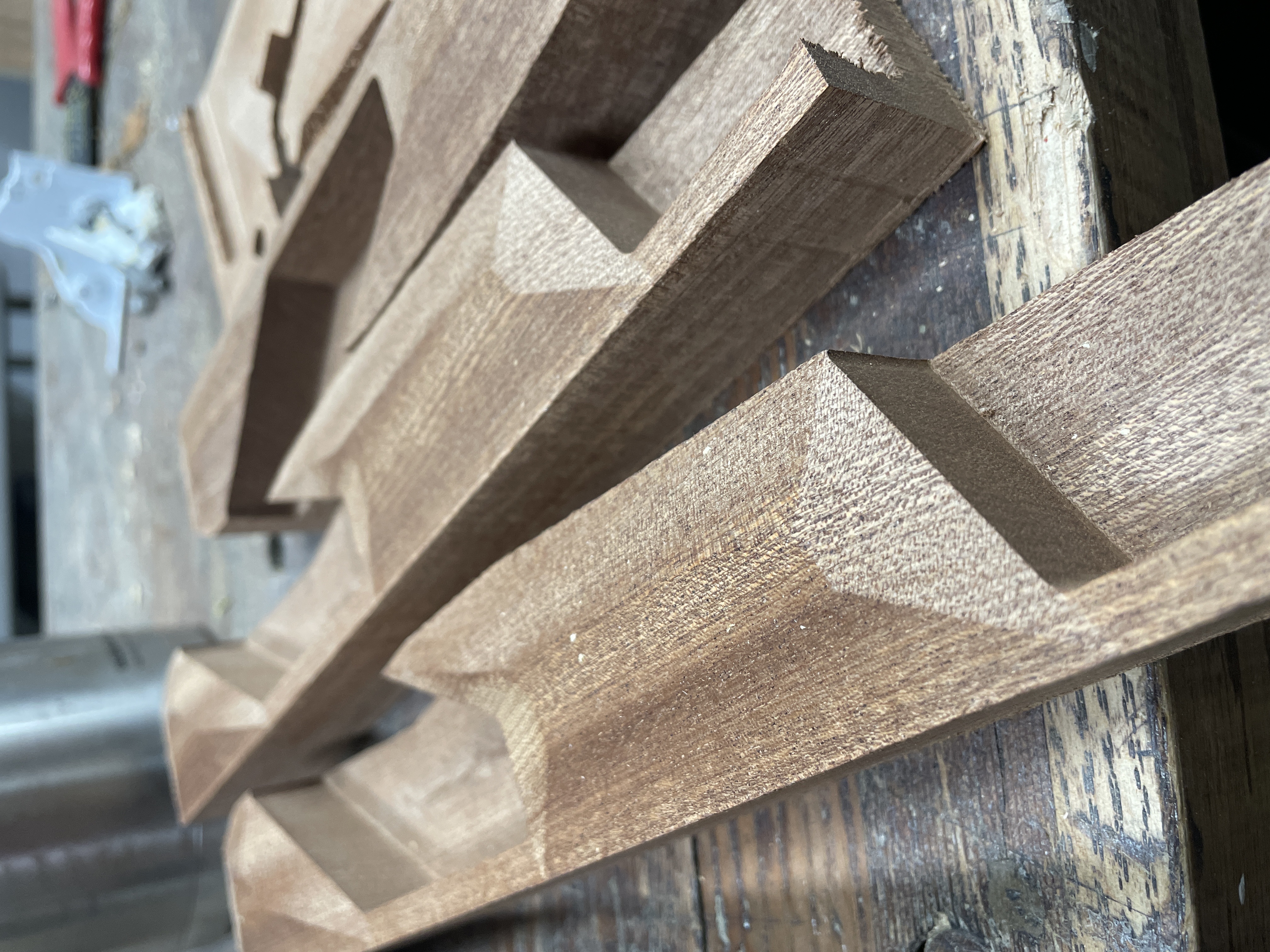

I’ve been roughing these parts with a 1/4” compression, then final pass with a 1/4” ball nose, which seems commonly suggested. I’m seeking a faster alternative. For various reasons I can’t go more than a 3/8” cutting edge diameter, but a 3/8 ball didn’t save much. The bevel angle varies, but never less than 60 deg. If I can find a 60 v bit, wouldn’t that make more sense than a ball? Or is there a reason ball seems to always be suggested for finishing on something like this? Thanks!

A ball is suggested mainly because any 3 axis machine can perform that function. Secondly, since the stepover is small, you tend to get a good finish. I have a 60° Insert cutter. Since it is an insert, its only 1 flute. That will not give as good as a finish as a ball end mill, especially on the end grain. I have put chamfers on hardwood tilting my saw at the desired angle and cutting it that way on my router, but not everyone has an adjustable angle aggregate. Still the finish on that cut needed some cleanup with sandpaper. Fast though.

One thing to keep in mind if you choose a 60° v bit is you wil get a sharp transition from bevel to flat if that is what you desire. I'm sure you can find a V bit out there (probably called 120°). Or you can have something custom made which is not all that expensive. You will get a bevel with way fewer passes with a bevel cutter and will reduce the sanding time as well in my opinion.

Enroute software has a PYRAMID feature where you can take a small diameter chamfer bit and step it up a slope.

These replies are much appreciated. Enroute would seem like big shift and another learning curve, and likely pricey (no pricing is posted as far as I can tell)
Yes, hard edges are optimal in this case.
If I can at least configure to a 1/2” ball, can I expect a significant reduction of passes? (initial attempts were problematic, but thinking that might be worth resolving)

120º V tool would make quick work of that. Aspire or vcarve would do the math quickly. It's a simple shape though, and the trig is pretty light just doing it in cam software.

Since you know the angle of the tool, you don't need fancy software to calculate the step over and z height. You can do that on paper. I have done this in the past before I got a seat of AutoCAD.
