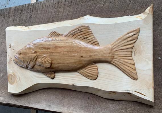

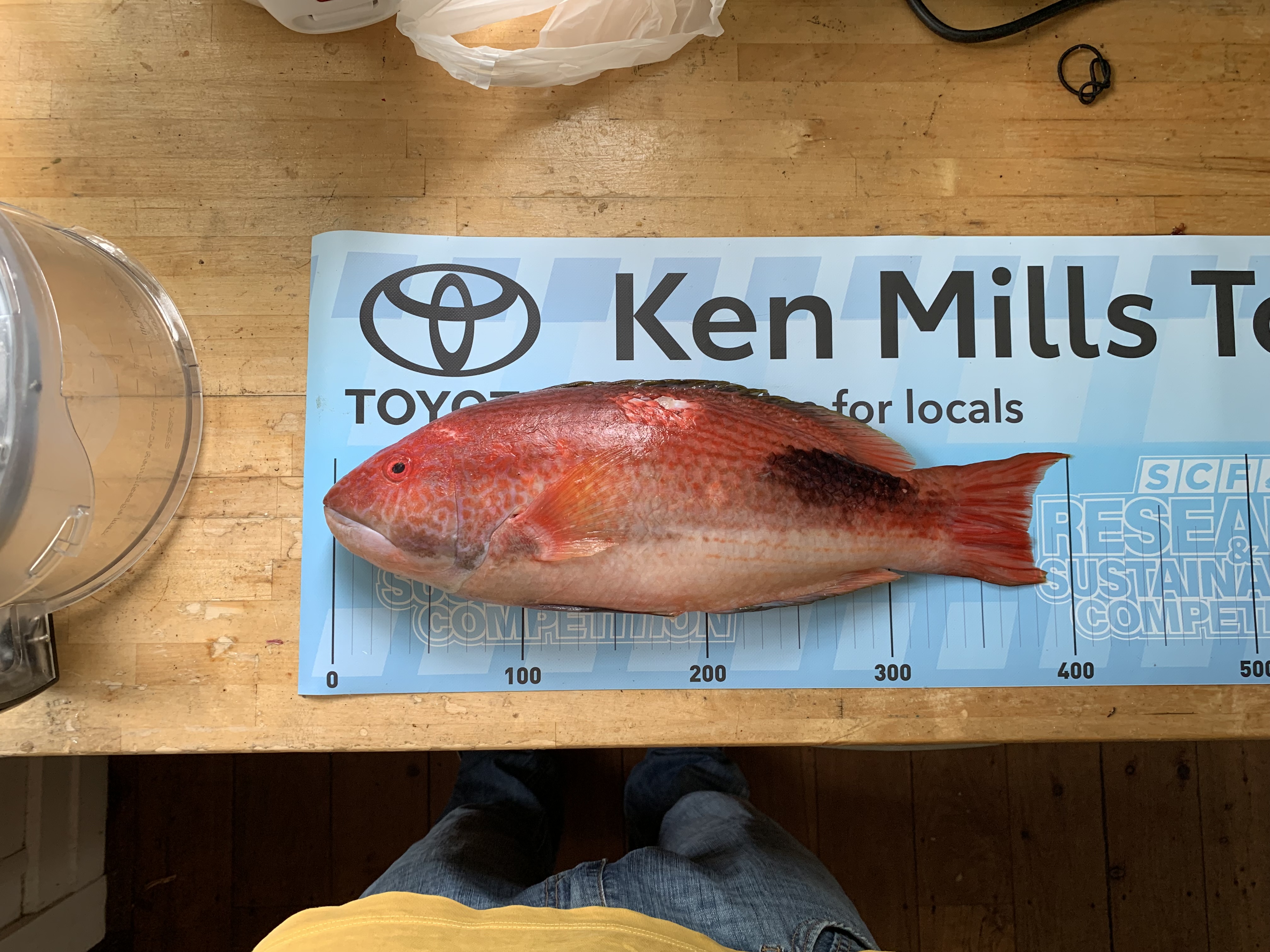

I can’t see anyone doing what I want to do online (maybe there is a reason for that) but I have included a couple of photos that may help to explain the sort of thing I am trying to achieve.
The first photo is just something as close as I can find on Etsy. The second is a fish, I would essentially like to scan one side of the fish import into appropriate software and have the machine carve it out of the timber. Essentially making custom pieces of my catch maybe friends catches and see what happens from there.
I hope that makes sense? Once again thank you for the time.

It is hard to make money doing 2.5 carvings as the time it takes to do the cut is hours long.
