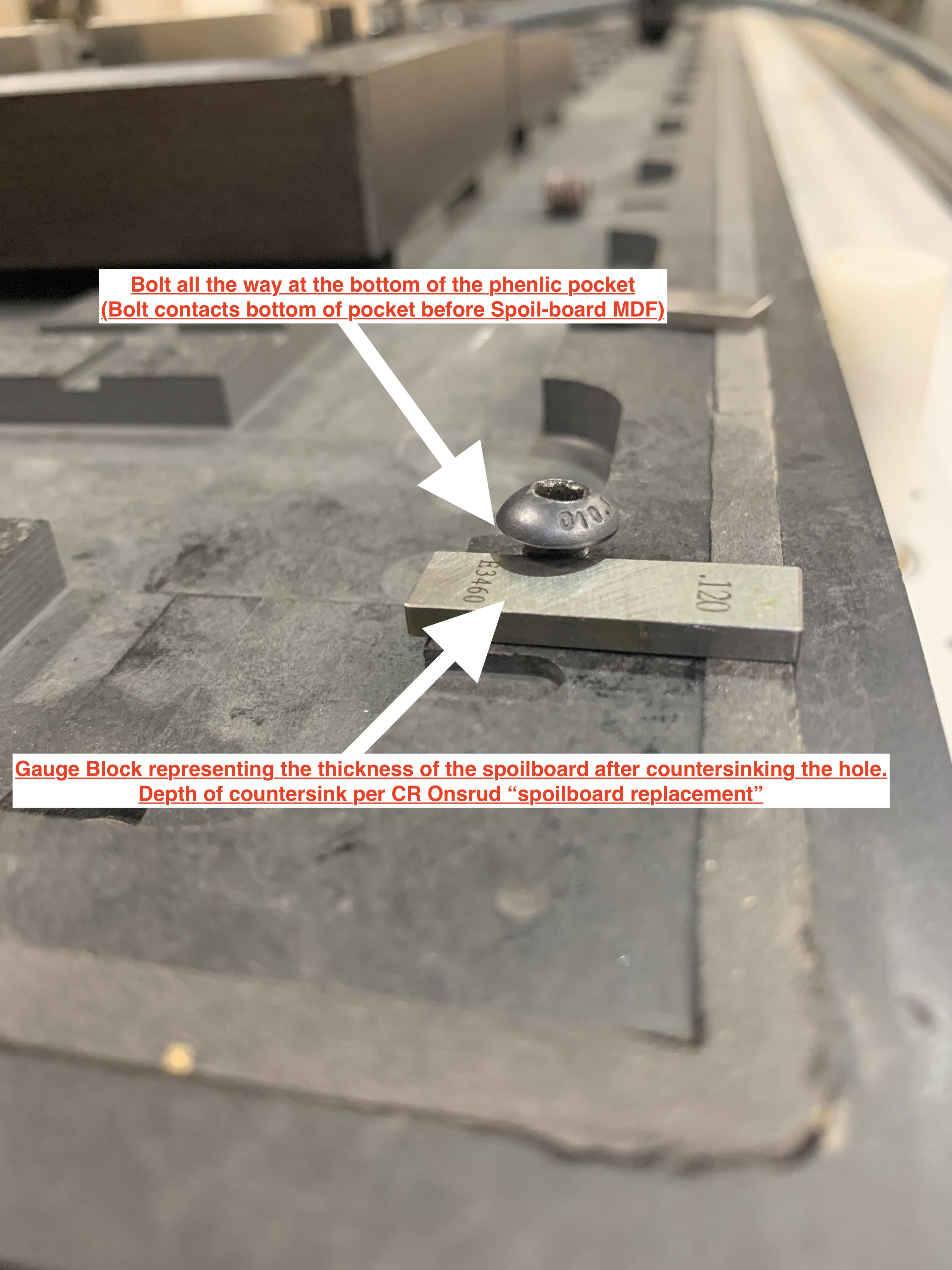

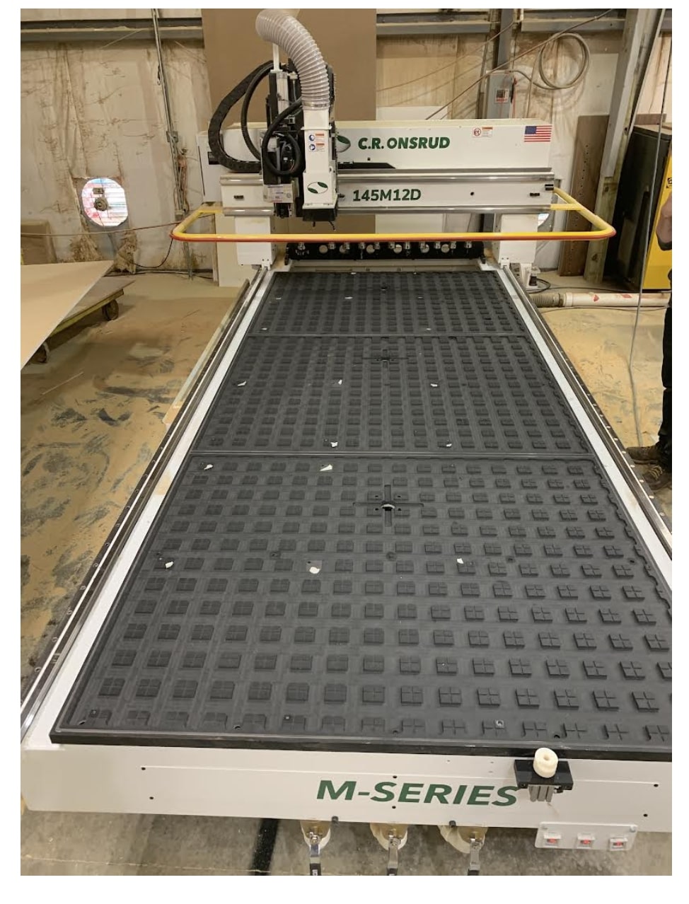

We purchased a brand new cnc router from CR Onsrud August 2023 to replace one of our aging Komo routers. Unfortunately this machine has created more problems than we had originally with the 23 year old komo that was removed.
Nonetheless, I was hoping to get some opinions from other industry professionals on our machines' phenolic spoilboard, the manufacturing defects, and whether I am asking too much for CR Onsrud to replace the faulty component under warranty.
This issue started when we were doing our first spoilboard change. As we were unbolting the CR Onsrud provided MDF spoilboard some of the bolts started to remove and then would “pop” back down into their hole and spin freely.
We continued on to remove the remaining +/- 30 machine bolts. As we were going through attempting to remove the bolts one of the bolts ripped through the mdf spoilboard with the insert still attached to the bolt...... (see photo).
After sending a picture to CR Onsrud tech support, it turns out that CR Onsrud had mistakenly thread-locked the bolt to the insert and NOT the insert to the phenolic table. Tech Support made mention that this has been an ongoing problem and they were just as frustrated with their “final assembly team” that it had not been resolved and were waiting for them to reach out to provide a way to fix.
Tech support called back and recommended that we cut the spoil-board into small pieces around the stuck bolts to be able to remove it in small pieces. After removing the MDF we saw that the threads on the phenolic housing the insert were stripped and in many locations this pressure had actually broken the phenolic mound from the table all together.
Very frustrating situation. But we are only human. And as a business owner I know that people make mistakes. Per CR Onsrud tech support recommendation we used a torch to heat the bolt/insert softening the thread-lock. Then we picked a new location for the inserts in a nearby undamaged section of phenolic, tapped a new threaded hole in the phenolic and installed the threaded insert.
We moved 7 of the inserts and then continued on to running the flycut program to machine the countersunk holes and surface the top and bottom of our spoil-board. We followed the provided instructions that were in our user manual under the section “replacing MDF spoil-board”
Unfortunately the thread-locked bolts were just the beginning…
After installing the new spoil-board and hold-down bolts we noticed that our spoil-board was still loose and the bolts were not coming into contact with our MDF spoil-board. We double checked the program to confirmed that we had correctly machined the spoil-board. All was correct so we decided to remove the new spoil-board to further investigate.
Once we removed the spoil-board we noticed that 17 of the phenolic mounds had been completely sheared from the table!
Immediately contacted tech support and provided them with our “flycut” file for their review, included an in depth explanation of our process, and included photos of our phenolic table. All of which was confirmed correct by CR Onsrud Tech Support and eventually they admitted that they had incorrectly made the phenolic table.
Tech support offered to send a technician to move all of our bolts/inserts to a different location on the table and install them at the correct depth. But I would be responsible for the cost of all hardware that is replaced (inserts and bolts??? Seems petty to charge me for a handful of nuts and bolts after they sold me a machine with defects)
They also said that IF I felt that I needed the phenolic to be repaired they could glue new mounds onto my table.
I explained my dismay and how I never expected to be charged for something that was sold to me defective. This machine was purchased brand new (at this point only 3 months old) and was still under the CR Onsrud “FULL 2 YEAR WARRANTY” displayed proudly as the FIRST line item on their “standard features” list.

I have been going back and forth with them for the past 8 months about this
-Am I wrong to expect a major component defect to be replaced by CR Onsrud?
-Am I asking too much for them to stand by their product?
-Should I just pay to fix their problems and move on? Or should I count my losses and wait to replace this machine with a different manufacturer that stands by their products?
-If a manufacturer offers a trade in due to their defects/lack of quality control/poor workmanship. Would you expect to cover their cost of doing so?
If this is happening to me, it will happen to you. And more than anything I want to warn the rest of you. They have had months and months to make it right and lock in a customer for life. But they put profits first.

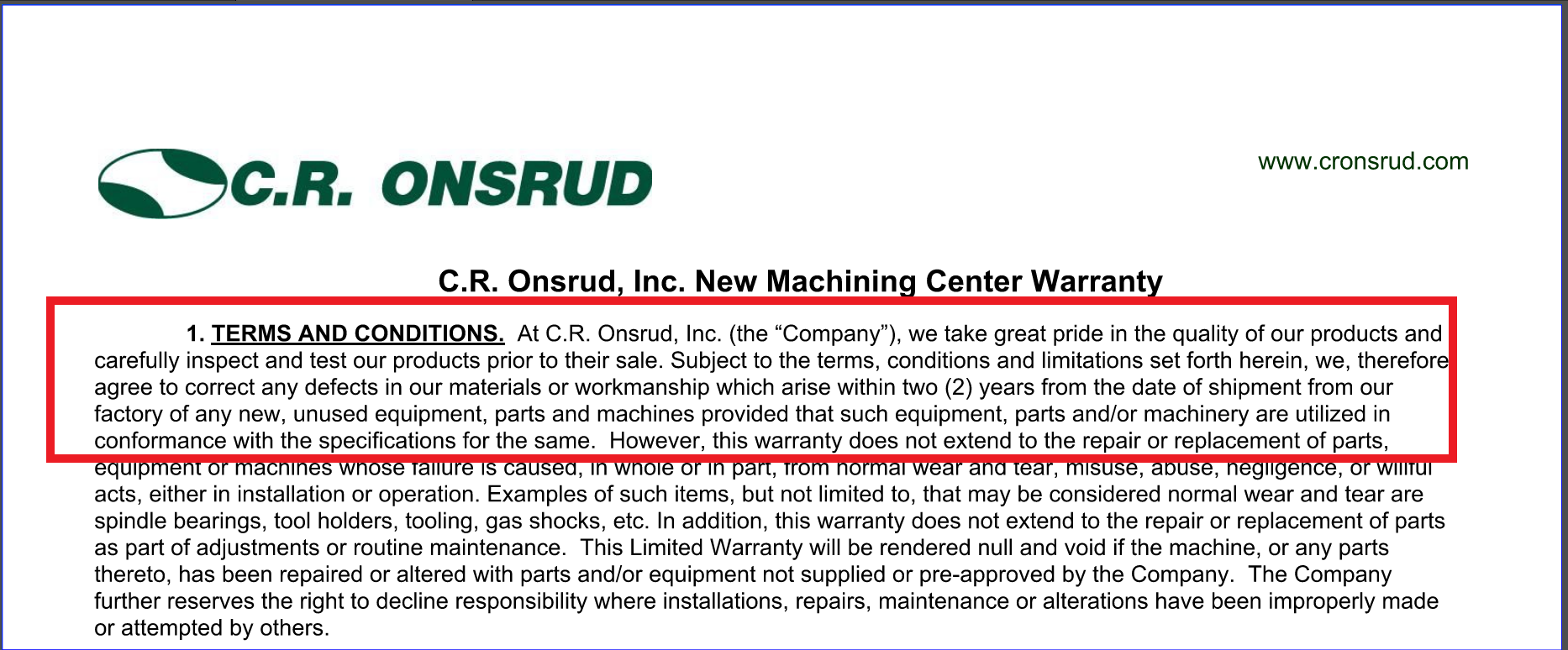

Eli: You called it. I reviewed the CR Onsrud warranty they provide to all new machine purchases. (even though their website said "FULL 2 YEAR WARRANTY"
Maybe I am missing something. But incorrectly machining the phenolic table (completed at CR Onsrud by CR Onsrud) sure seems like a 100% perfect example of a workmanship failure.
We had our 1 year service completed on Friday. The tech was awesome. I showed him all the items above and he was VERY embarrassed that the CR Onsrud wont replace their defective table.
View higher quality, full size image (1866 X 774)
