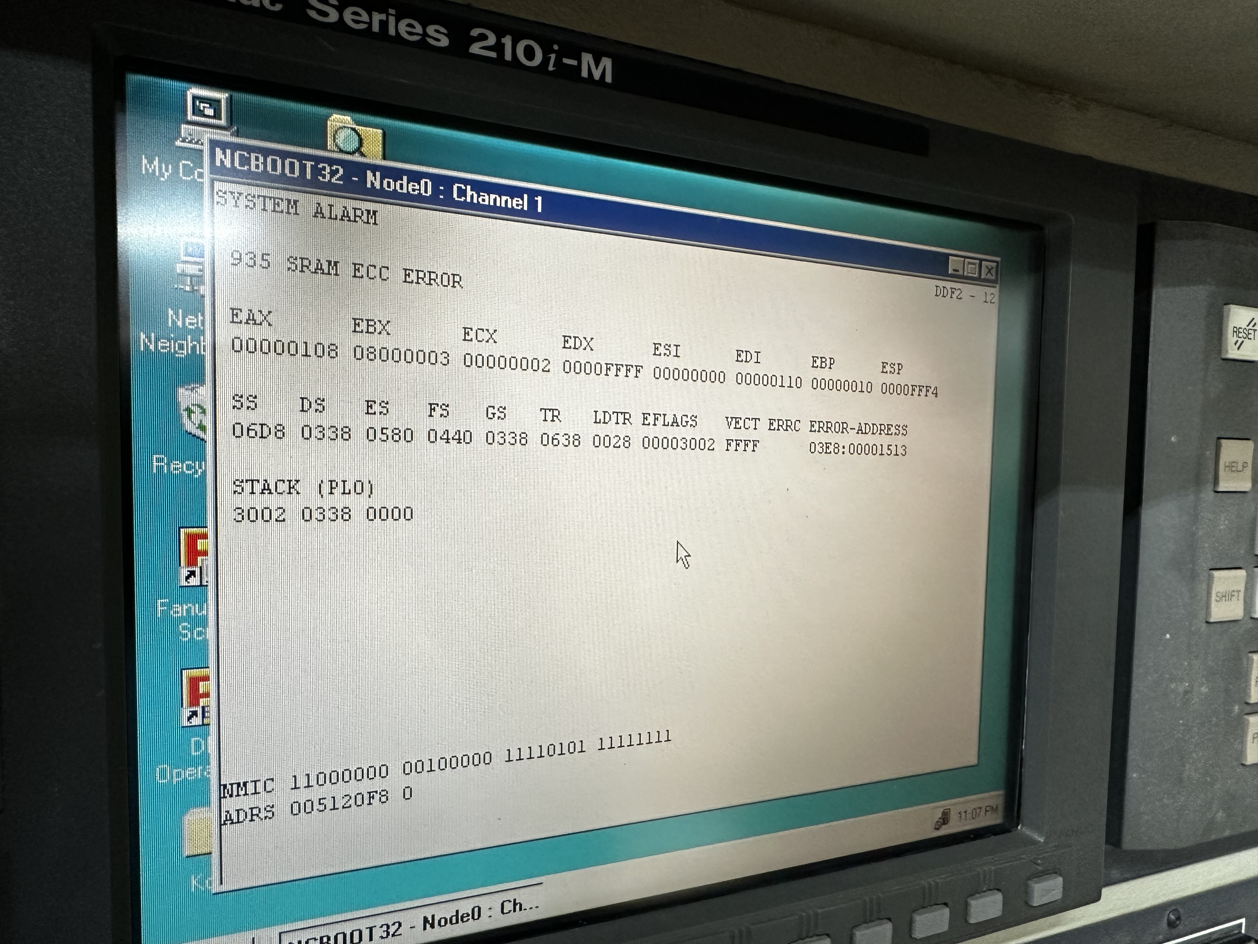

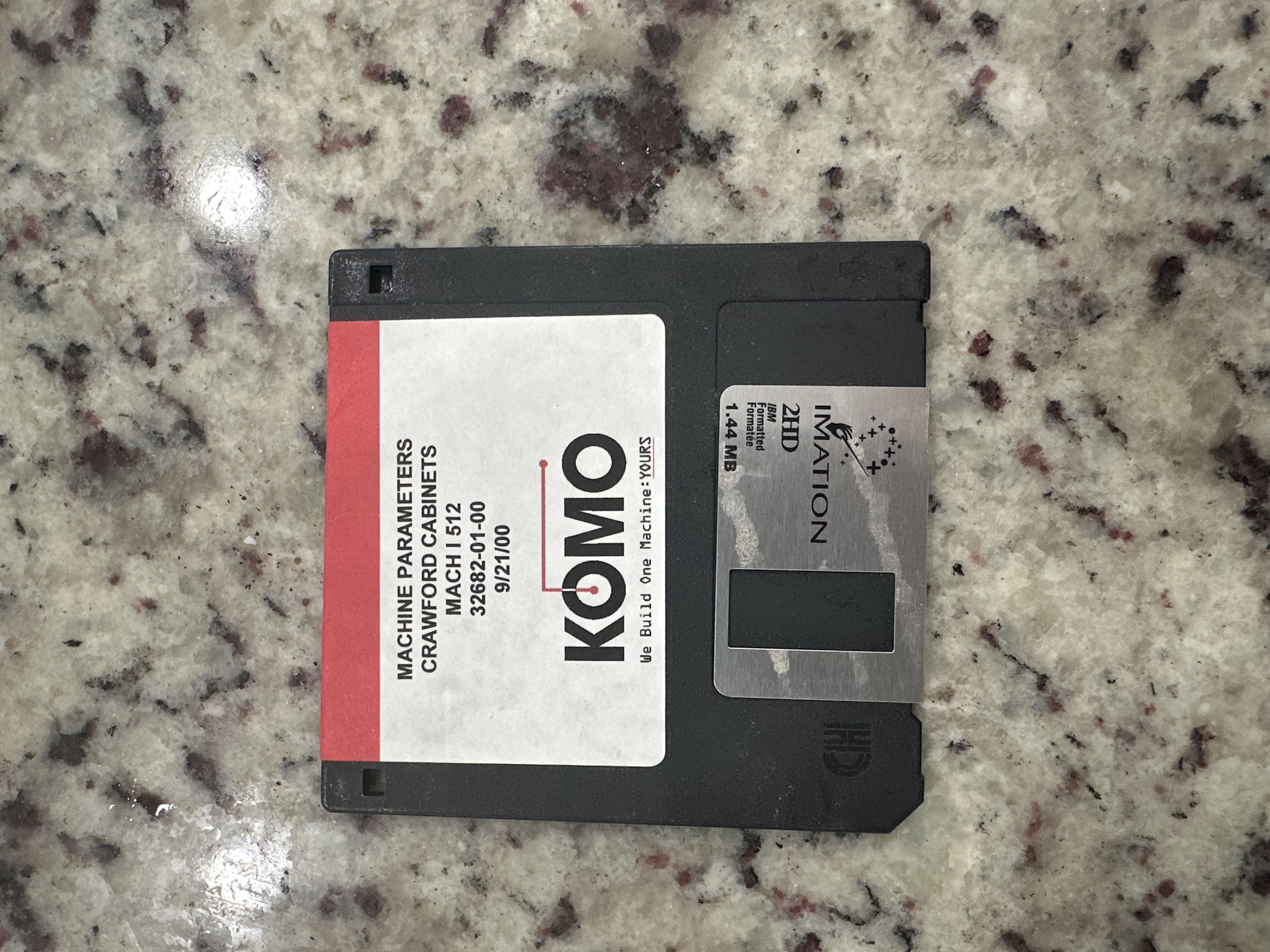

Hello, I was recently called to repair a KOMO CNC Router VR-5 12-MACH 1 from the 2000's, the screen had a glitch and the main board had to be sent in to be repaired with T.I.E. When I received the screen and the main board back (as a unit) the SRAM file was wiped out as the file was corrupted. Now I can't get the machine to communicate with the control. I spoke with the KOMO support team and they are looking for a similar SRAM File from the same time period. However that is challenging because is a long time ago. I spoke with FANUC and they say they can come and upload all the parameters again because I still have the Floppy with all the parameters in it. All the program files are still available I just don't have the SRAM file to flash it myself... Does any of you have a SRAM for a CNC KOMO from the same time period? and does anyone have any ideas how to fix this problem?

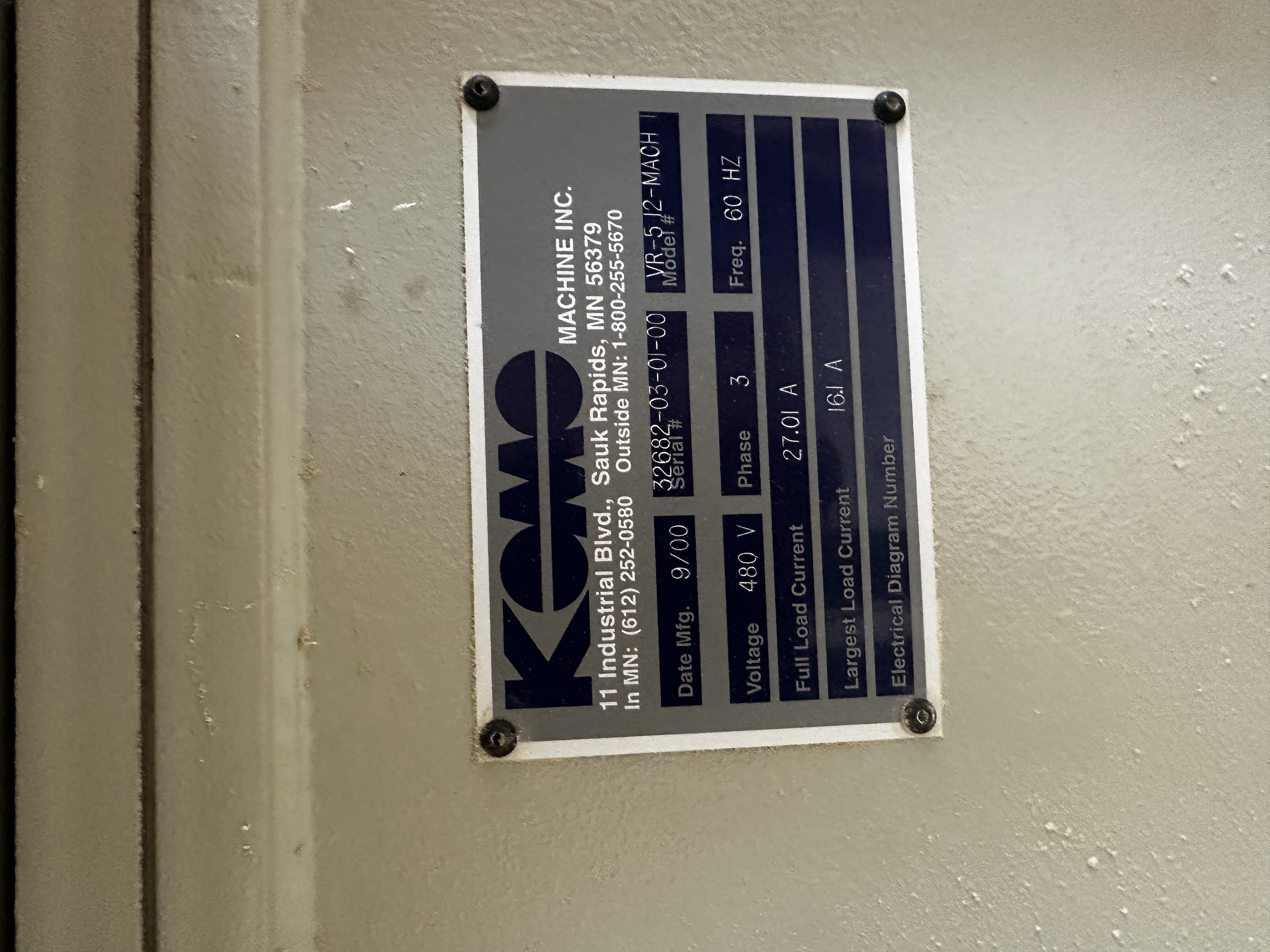

To get the most accurate SRAM you should post a picture of the serial number plate and tell us how the machine is configured. Number of spindles, Drill block, ect...

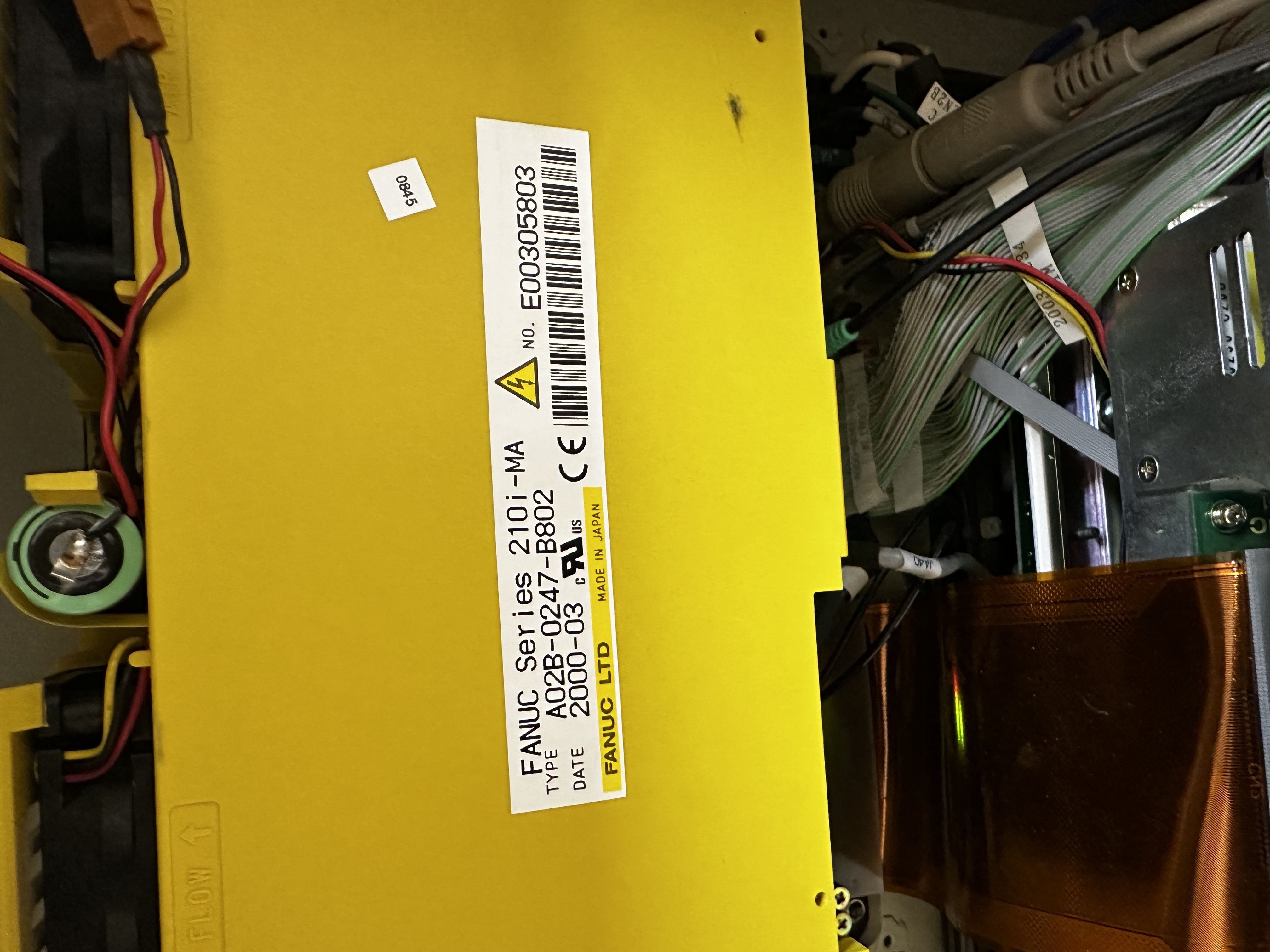

1) jim is right. Send us a picture of the machine gantry and a picture of the complete rear electrical cabinet and we should be able to tell what it’s equipped with.

3) I have a completely functional 210i-m computer that came off a mach1 it’s been in storage since October of last year if you want to purchase that you are more than welcome to. Pm me.

I've got Fanuc to come out and re load each file individually, now I have to set all the offsets and the X and Y axes. I have no idea how to do that

32682-03-01-00 This is the serial # for the machine I'm dealing with.

Machine Label

One of my customers has that machine from around that time frame. Plus you should be able to punch those parameters from that disk.

Hello Dane, I am located in GA. KOMO is coming out in the next few weeks to try and set up the machine since Fanuc already came out and set up some parameters. The issue now is that: The major problem right now is the X-Axis is only moving 114” and the machine is showing a move of 147” from X-Axis home.
I believe that a couple of parameters are not set correctly for the pulleys for the X-Axis drive and encoder. The SRAM that was supplied to us was for another machine.
