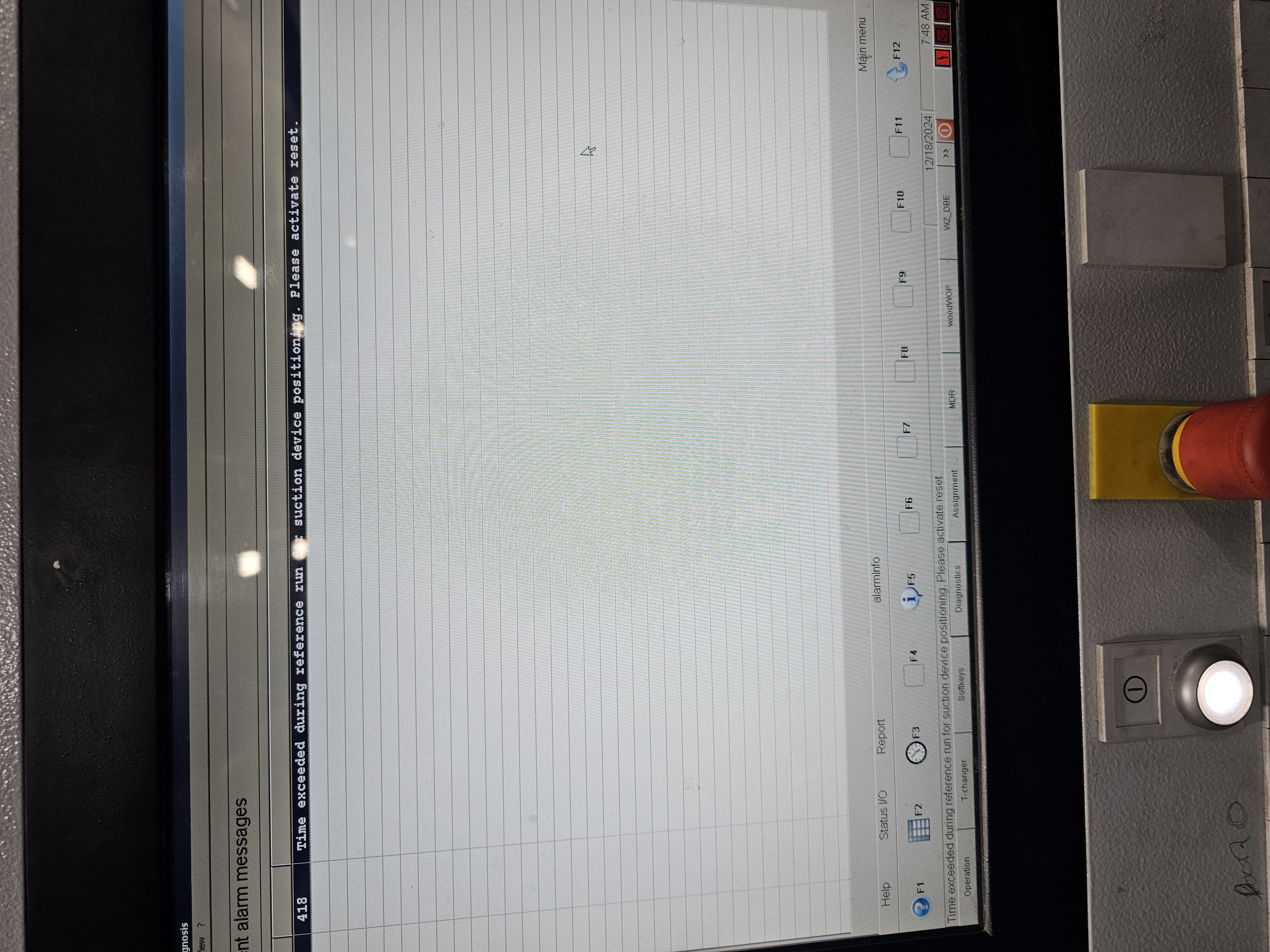

not sure if this is the right place to post this, but I have an issue with a Weeke CNC 211 BMG time exceeded during reference run for suction device positioning.
Issue: “Time exceeded during reference run of suction device positioning”
This has been an ongoing issue, Stile’s technicians and technical support have recommended that we’d replace (and we have) console 7 canbus motor, KEB inverter, and main drive belt motor/ encoder. The issue arises when you load an assignment for the CNC put machine in Automatic and all consoles and pods move to their designated positions. However, one of the consoles’ pods will not move to their designated positions according to the assignment. Last time I spoke with Andreas he was reaching out to the Factory in Germany for assistance, in the meantime I was to change the KEB inverter. I understand he is on vacation this week.

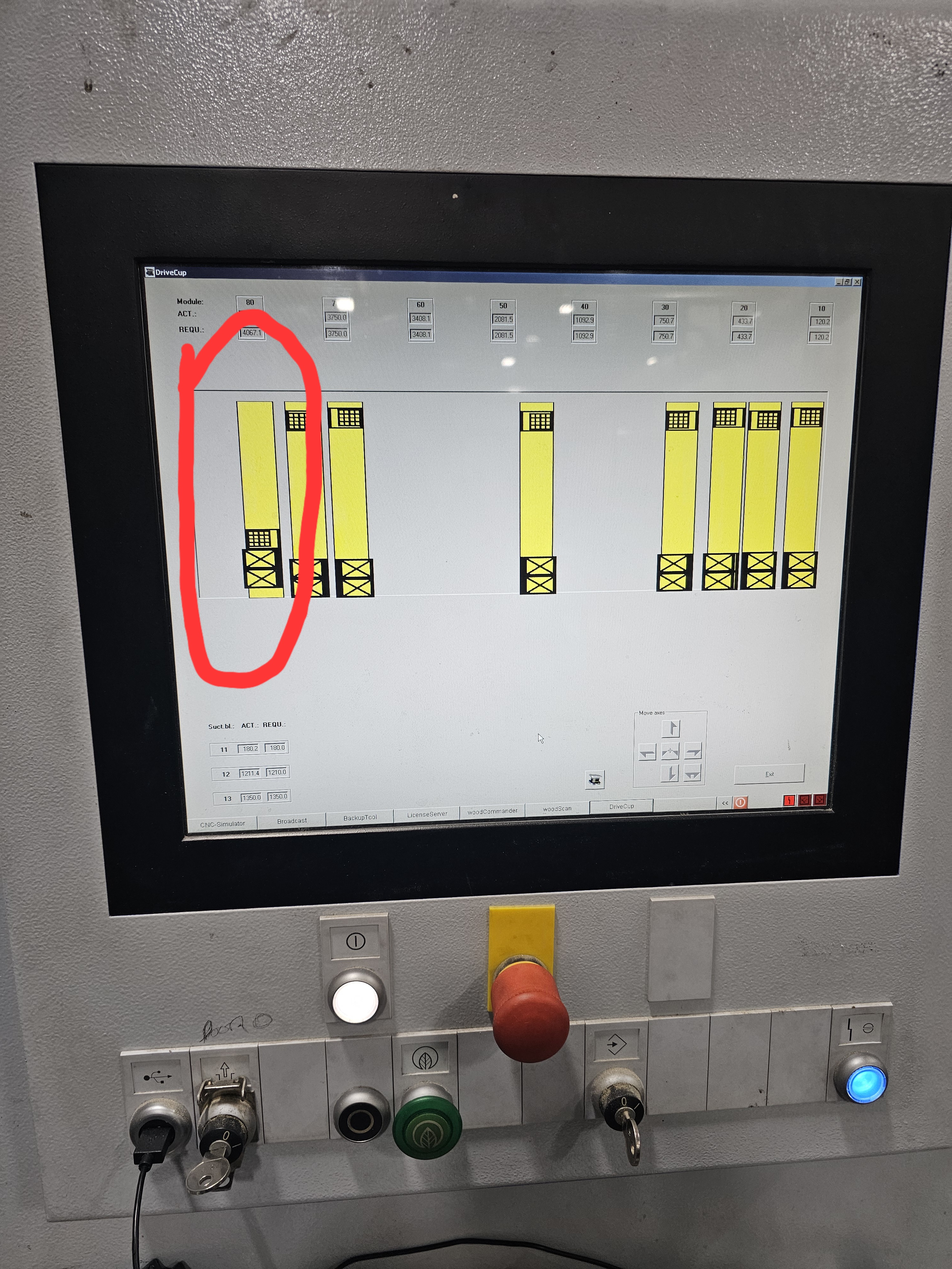

To summarize, after in PLC control in Twin Cat – visualization – Konsole references – pod references, once everything is referenced, I check Drive cup everything looks good, pods are showing where they should on the screen in relation to how they are in reality, I place machine in Auto, and load assignments for left and right side. Go to pedestal, press “right PB” subsequently, all pods/ consoles move to their designated positions. For the “left side PB” I depress it and all consoles/ pods move except either the console 7 or console 8 pods (not consistent). Then after the PLC looks for a signal for 120 seconds machine faults. Therefore, I am reaching out to see if you have any guidance or insight. And before you ask, relay 23U1 I have a good 24v signal at every console, and pod. I have nearly checked every prox switch I have ohmed/ checked voltage from every pod. Not sure where to go from here. Thoughts?
