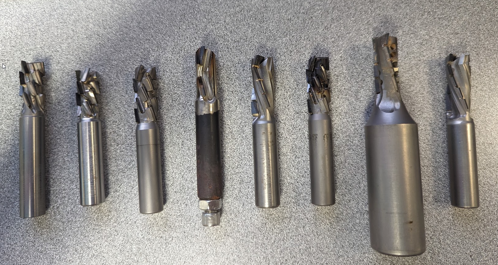

We have 5 nested base routers, Homag and Northwood. We also have a host of other cnc machines including 3 Homag BAZ's. I started testing PCD tooling many years ago with many vendors. I started testing with Leitz when a gentleman that I had known from the past stopped in working for Leitz at the time. Started testing 191031. It had a high squealing sound like it was going to break. We ended up sending our material to Germany for them to test. Our material turned out to be 20% more dense then German material. They came back to me with 22000 RPM and 20 MPM on their tool 191031. I'll admit, the tools get discolored when they are dull, probably the high RPM, but we are still way ahead of running carbide. We normally get 3 sharpening's on 12mm PCD. I discovered over the years to have one tool dedicated to melamine, and one tool dedicated to laminated material. The melamine tool lasts for weeks running 2 shifts a day. Don't ask me panel numbers, I don't know. We are a contract manufacturer, running different product every job. The tools are logged by machine and operator, and I see the tooling costs every week. I know we are way ahead of the carbide days. I've been working with another company called Wirutex. We are running a couple of their tools now. S14300 is their 12mm nested PCD tool. Having great success with that tool also. Forgot to mention, we are running all shrink fit HSK63F tool holders also.

Great post Chad, would love to connect on your success, we sell tools online and are a Leitz/Wirutex dealer, never had much success with PCD..if you have time would appreciate your insight to help others..
