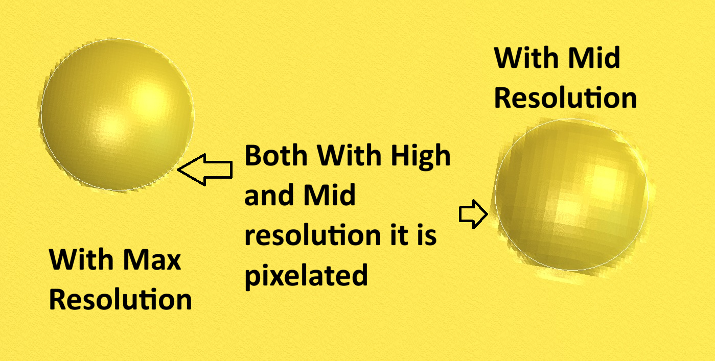

I am new to ArtCAM and have been working on creating 3D models. I have encountered an issue with the resolution of my models and would appreciate your guidance on how to improve it.
Case:
I created a 3D model of a 25mm diameter circle with a 45-degree rounded edge using the Shape Editor tool. However, the resolution of the model is not smooth; even after setting the maximum resolution (4498 x 3556 points), the model still appears pixelated and lacks smoothness.
I would like to understand what steps I can take to enhance the resolution of my 3D models in ArtCAM.
Additionally, I am curious whether the output from CNC machining will differ between low and high-resolution models when using similar toolpaths. Will the visible differences observed in the laptop version reflect in the final physical output?
Any advice or tips on improving the resolution and achieving smoother 3D models would be greatly appreciated.
Thank you in advance for your help!
View higher quality, full size image (1399 X 707)

Optimizing the resolution of 3D models in ArtCAM can be achieved by increasing subdivision levels, using complex geometric shapes, and adjusting smoothness parameters. The difference in CNC machining output between low and high-resolution models can lead to roughness or distortion in the physical output, so testing before actual machining is recommended to optimize results.
