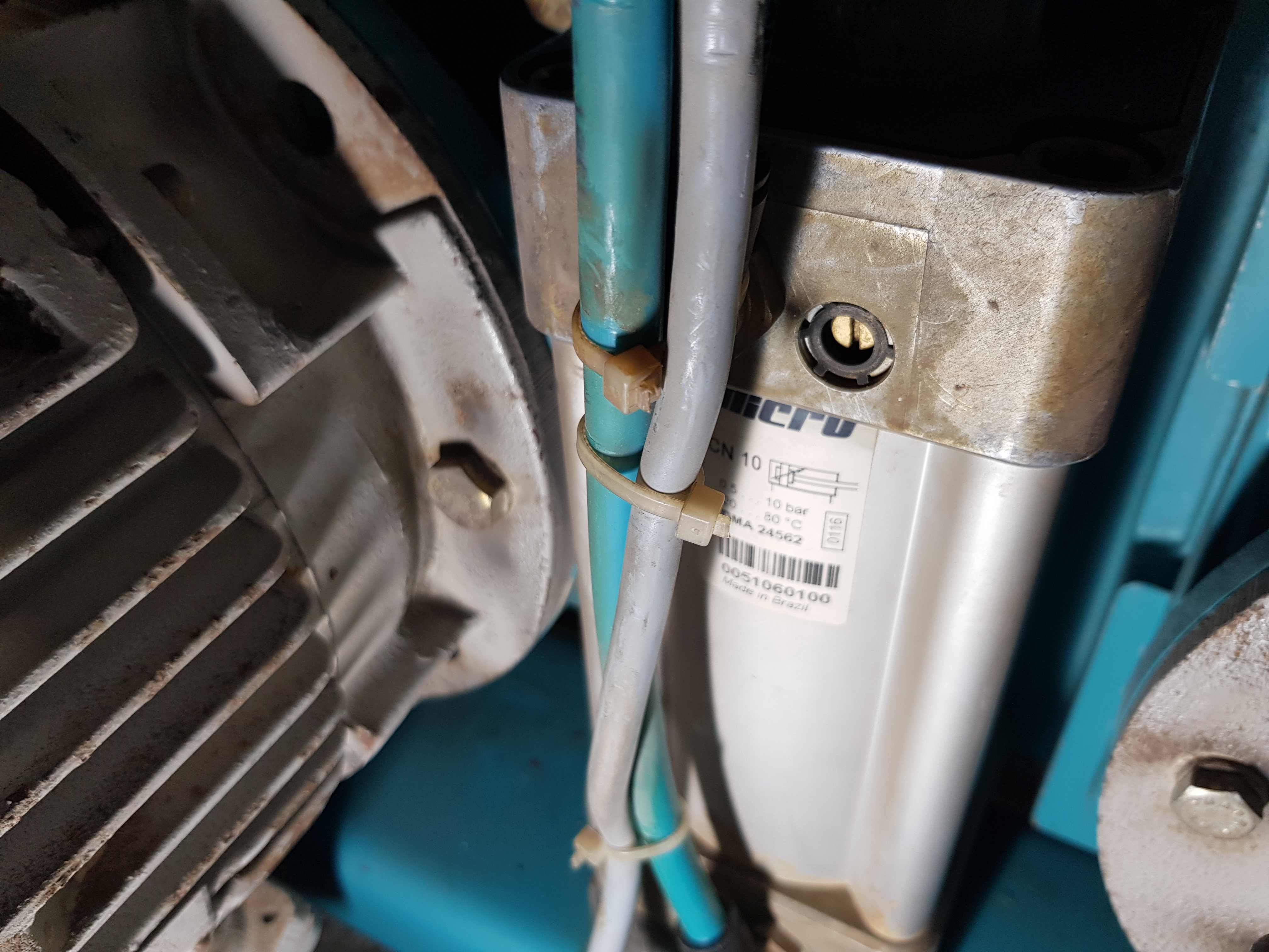

Leon van diepen
How do u remove scribing or main cutting blade smart 65 ? Manual shows you plug in an air supply to middle of locking nut .ours has only a large Lnkey hole for just Lnkey tool .still cant figure how to keep saw carriage held up for easy access to lnkey hole .

Leon van diepen
Thereis an adjustable screw at top ofmain up/down air ram for carriage .is this it to manually raise it . Ill mark it turn all way in or out count turns so i can go back to original setting . See if raises it ?

Leon van diepen
Photo of valve
3/12/25       #13: Panel saw variation ...
Leon van diepen
Photo of valve
3/12/25       #14: Panel saw variation ...
Leon van diepen
3/12/25       #15: Panel saw variation ...
Dropout
That's the cylinder not the valve. Please don't touch any of that.
I'll post pics tomorrow.

Leon van diepen
Cheers 4 help . No one here now has ever changed scribing blade it is 4.6mm main cutting blade is 4.2mm .just want to change scriber to approx 4.3mm .we have plenty of spares bot no one knows and the ones that would know r long left the company so im the next guiney pig teying fix it .
3/13/25       #17: Panel saw variation ...
3 pics.
1 with saw carriage down
1 with saw carriage up
1 of the valve that you need to manually trigger to raise carriage
