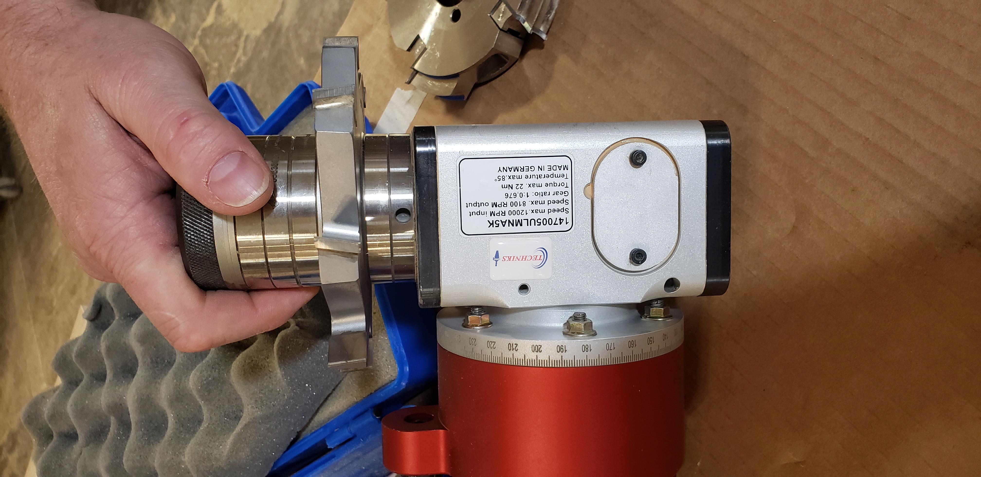

Hi everyone,
I'm reaching out to get some insight into a recurring issue we're having with an aggregate head on our CNC machine. It's a Techniks unit, and we're consistently running into problems after about 10 to 15 hours of use.
Here's what's happening:
After around 10–15 hours of runtime, the aggregate head starts making loud noises.
When we try to spin it by hand, there's noticeable resistance.
The unit runs continuously for about 1–2 hours at a time during normal operation.
It comes pre-filled with Castrol Alpha EP32 oil.
We've also noticed it gets quite hot during use.
We're wondering:
Is this expected behavior or are we doing something wrong?
Should we be using a different type of oil?
Could it be an issue with this particular brand or model of aggregate head?
Any guidance, experiences, or suggestions would be really appreciated. Thanks in advance for your help!

Hi
You might be pushing the unit too hard, if it is heating up excessively you may be getting some thermal expansion of the gears inside causing the hard rotation.
How long does it sit between use? Is it getting adequate time to cool down?
I know it's an expensive unit but if it's a critical component to your manufacturing maybe you need 2 identical set ups, and you rotate them on and off to give it enough time to cool down between use.
Have you changed the oil in it yet? Usually they recommend the first oil change around 200 hours of use , then continue changing the oil every 500 hours.

Hi there and thanks for the response, and when we do run it we really do not give it time to cool off and for the oil, we run it for about 10hr total when we start to hear the unit failing.
i do suspect that it is also the heat that is cousing problems and i will be reaching out to Justin
