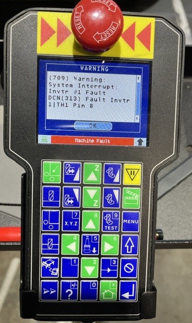

Hi there,
Anyone using a Multicam Apex 3R CNC machine come across this error message before? I load my job, press start, the head moves picks up correct tool then moves to the front to start point and stops, this error shows. I then have to rehome the machine, load the exact same file, press start and away it goes, cuts perfectly fine on the 2nd run? it occurs randomly throughout the week. Any ideas would be great.

Based on your description and the error message, it sounds like a loose or intermittent connection on terminal H1 pin 8. Check your wiring diagram for information on that wire.
