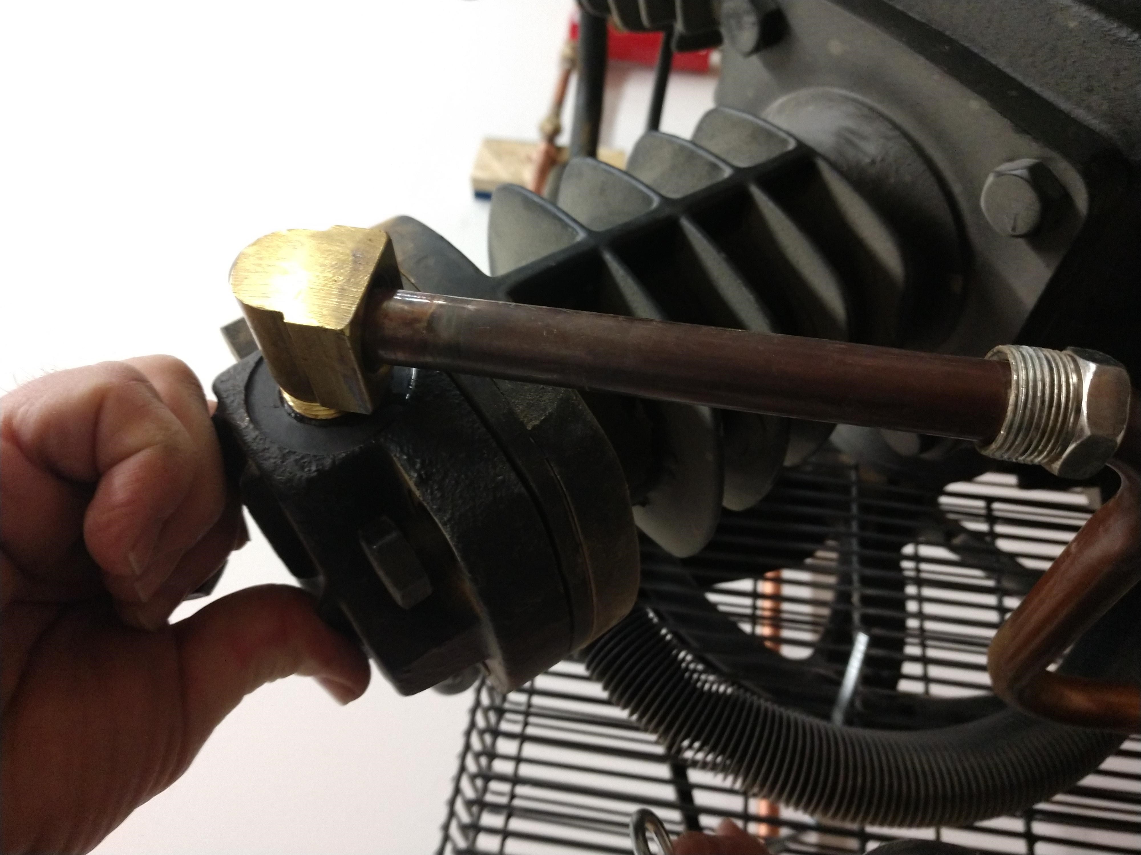

Hello,
The tube leading to the tank is extremely hot, the motor seems hot, the breaker is tripping. This is an Ingersol Rand upright tank. About two years old, oil is good, air filter is good, pully freely spins. I'm perplexed. I thought there would be a clogged output valve or something but upon removing the head cover it all looks good. The tube is the hottest right where it exits the cylinder head.

The first thing you should do is check the amperage it is drawing on each leg of power. If one is really high I would check all the connections. A poor connection will make a breaker trip and may make the motor run hot. What duty cycle are you running on the compressor. I don't know the actual recommended cycle on a piston compressor but if you are much over 50% you may need to up your game.

I think you probably have a motor issue of some sort and are just noticing the head to tank tube is hot.....which most likely is always the case.
Figure out why the breaker is tripping and you should be back up and running.
Check electrical connections and make sure the pump pulley appears to be spinning properly. If you have a bad run capacitor on the motor that would cause it to run slow and overheat I believe. So see if you can tell if the motor is spinning at its full rpm.......probably 1725 range.

Post your motor name plate. You don't say if it's single or 3 phase. As Bill said, get an amp meter, even a cheap one. It's hard to diagnose motor load problems without one.

In addition to checking the motor amperage, and run capacitor, there should be a check valve where the pump pipes into tank.
Possibility it could be stuck causing excessive back pressure on the pump.
