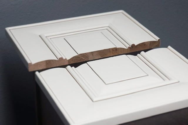

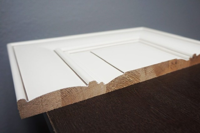

Is what I am attempting to do any different from making the center panel of solid-wood 5-piece construction doors? And any different from making a cutting board and finishing it with solid-color 2K Poly?
I actually saw some people selling one-piece cabinet doors out of Rubberwood strips (see attached photos). Any clue what they did to achieve this?

Glue up then CNC would be my guess. Hard to believe that would be a stable door. Does the door feel a lot lighter than it should?

My guess is that the picture was taken during the 25 minutes after the finish dried and before it started warping.
There is simply no way that door can be stable as constructed in general.
Constructing it out of rubberwood just makes it near impossible.
Rubberwood has a very strong tendency to warp and twist while drying out, so if it ever, in the history of the world, got moist, it would turn into a potato chip very quickly.
