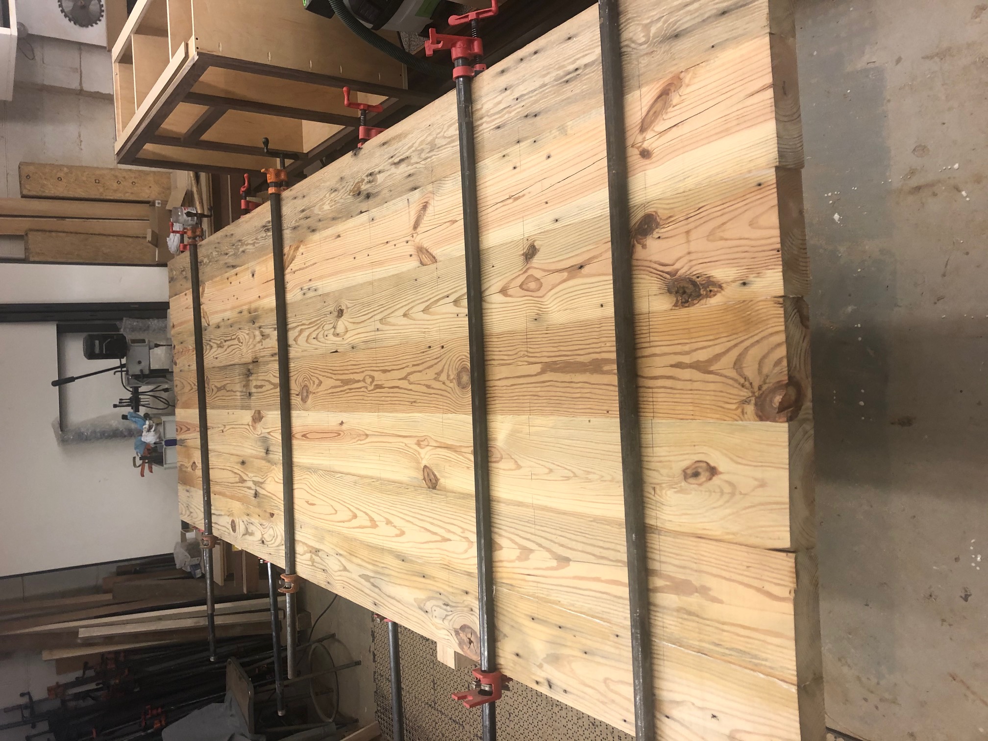

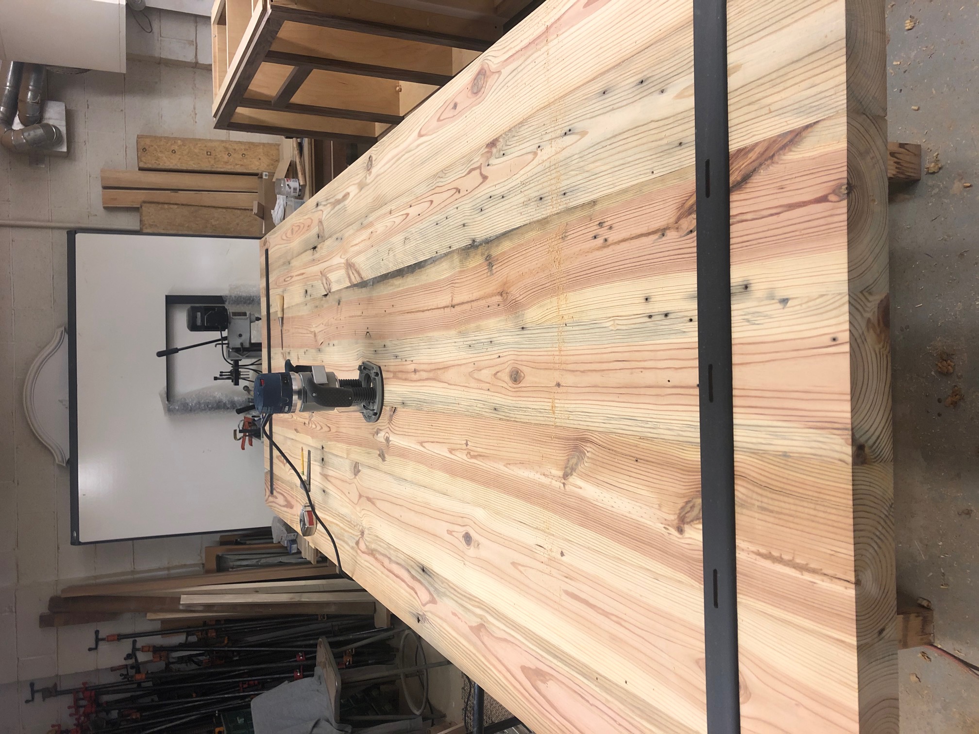

Hello all,
I am a cabinetmaker and not a finisher. I only self-finish in certain situations, including one that is currently going sideways.
I will provide more detail below but the question is: can I achieve the color the client now wants on the heart pine table I have built and delivered if I strip/sand the whitewashed finish to bare wood (huge loss of time notwithstanding), or will I always be fighting the wood's natural hues and should just remake a new top out of white oak or similar?
The table is reclaimed "heart pine" (not sure if it is longleaf pine, heart pine, or just old growth pine; it was flooring in a factory here in Connecticut once upon a time), photos below of the top and bottom after glue-up while still unfinished. After approval from the client, it was whitewashed with the same color as her kitchen cabinets and then clear coated with a waterbased lacquer (emtech 6300) to avoid yellowing, photo below.
I delivered last week and now the client (who has not paid the balance due, but that business mistake on my end is a topic for another thread) is complaining that the table "is throwing off way too much pink", and that she wants to avoid "pink, purple, orange, or green" undertones. She would like to change the finish to match brown/gray barnboard she has on her fireplace wall elsewhere in the house and sent me a link to this: https://angelamariemade.com/how-to-create-a-weathered-wood-gray-finish/
My question is will a finisher be able to achieve the brown/gray weathered look she desires on heart pine? If she is averse to the pink, purple, green, and orange undertones, is there any way to fully obscure those? Is the only way to achieve her desired faux-weather barnboard look to start with a wood that isn't already pink, orange, and green?
Thanks for your responses.

It wasn’t full of old nail holes it would surprise me if that is reclaimed out of an old mill shop in CT. Those are new growth planks. Look at the wide growth rings.
You will be fighting that wood until you give up. Build a new one.

Sounds like a crappy situation. My thoughts- you have to much natural color on that pine top to get a uniform white wash unless it is very white. The gray weathered look? maybe.

to some degree the pink will go away after a couple of months. Even non yellowing yellows slightly over time. You could also use a toner to shift the color pretty easily. Jeff at target coatings could probably help you make a toner that would kill the pink.
10/16/20       #12: Table Finish Advice ...
Jonathan Mahnken
not sure what you used for stain and sealer, but with that look you want to try to be "closer to the wood" Thin your color, Thin your sealer, and do a flat topcoat. This will also help in the time it takes for the waterbased system to mature out of that purple/pink/blue stage

Yes, it's not hard to make a pine table grey for a experienced finisher.
Toning is not a good idea for a dining table, 1 scratch and you have a touch-up problem that will take a master finisher to fix.
I would start over; strip, sand and wide belt, dye lightly black with just a bit of green, stain grey and finish. I'd use a acrylic 2k poly (MLC Polarion for example), chances are using a single component WB will have your phone ringing and customer requesting a refinish within a year or two.

PS; Staining white with a touch of black and green first, sealing then glazing grey would be a easier approach to get get a grey but opens you up once again to a possible future touch-up problem.
