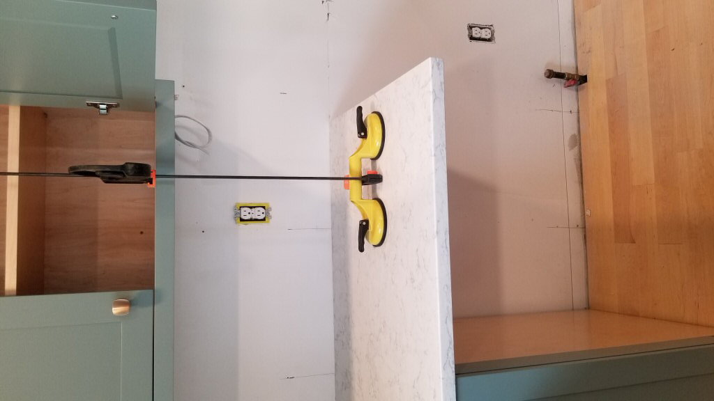

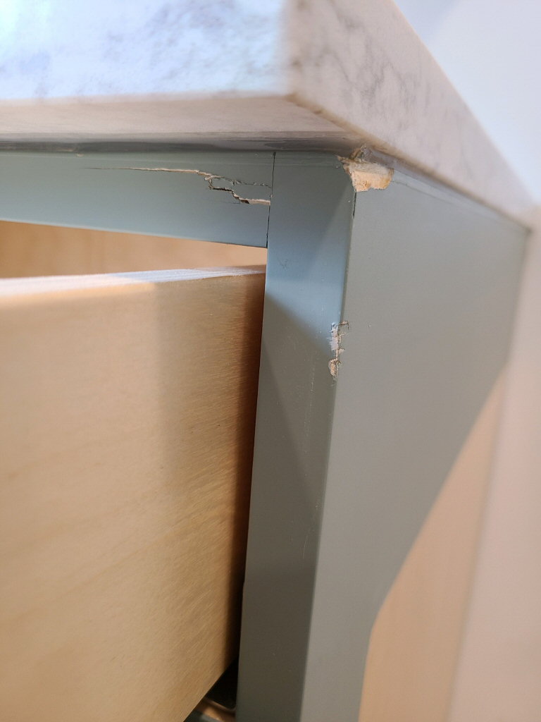

Just had the countertop guys drop a counter on a Euro cab top stretcher so hard it split the wood in half and took a chunk out of the top corner. GC said put a screw in it and some colored wax.
They had just paid for a brand new kitchen and I'm suppose to hack a fix that I know full well isn't going to last more than a few years no matter what I do.
I remade the cabinet, used the other components because they weren't damaged and charged the countertop company.
