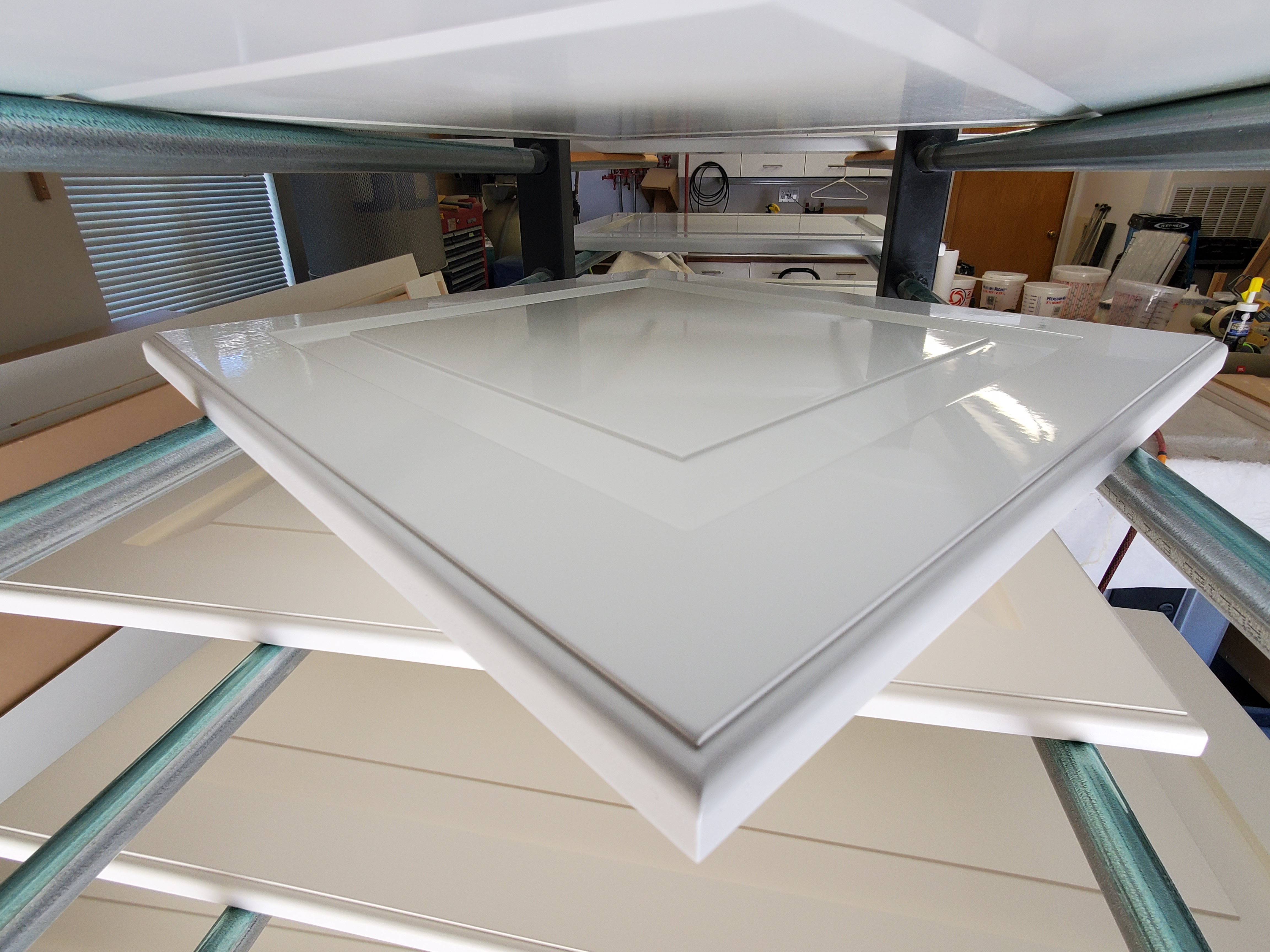

Yavuz Member
i am assuming this product is pigmented and is a pre-cat.
i use Sherwin Williams 275 voc pigmented and i don't use and clear topcoat over pigmented color coat. Pre-cat need longer curing time before gets hard maybe 2 months depends the temperature in your area.
i see some ppl spray over but that time it changed the color and look and i prefer not to use.
View higher quality, full size image (4608 X 3456)
