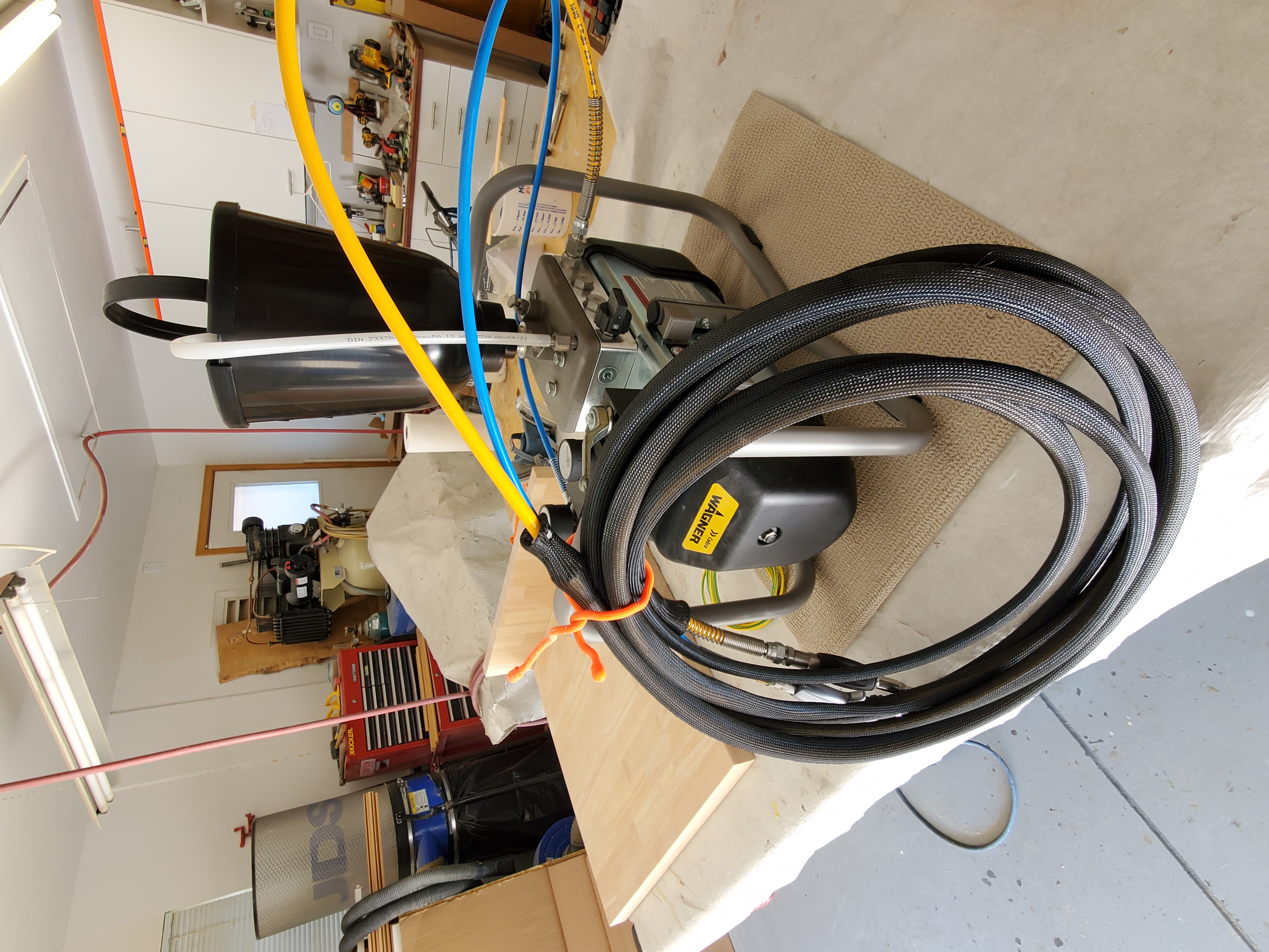

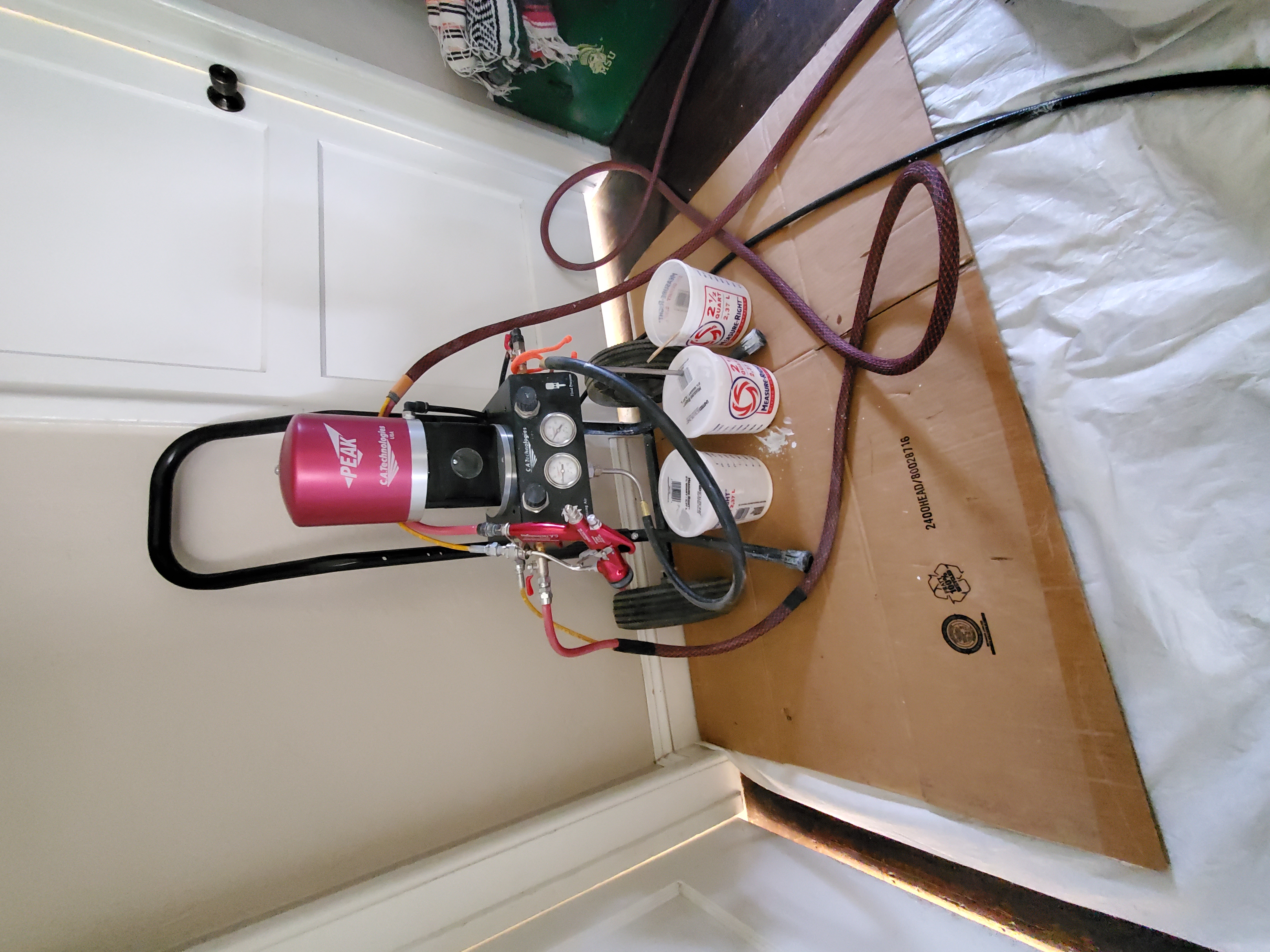

Yavuz Member
Waterborne 2k or thick viscosity paints? using less than 30:1 pumps or airless are healing migraine with aspirin :)
Using airless like PC 495 or t4 are good also and many pro's use in the trade.
Me personally using Ca tech 14:1 for solvents and waterborne 1k's with Graco PC 495 and all the euro or non euro 2K poly's or catalyzed type thick paints Wagner Cobra .
P.S : I am C-6 Constructor not a painter.
View higher quality, full size image (4608 X 3456)
