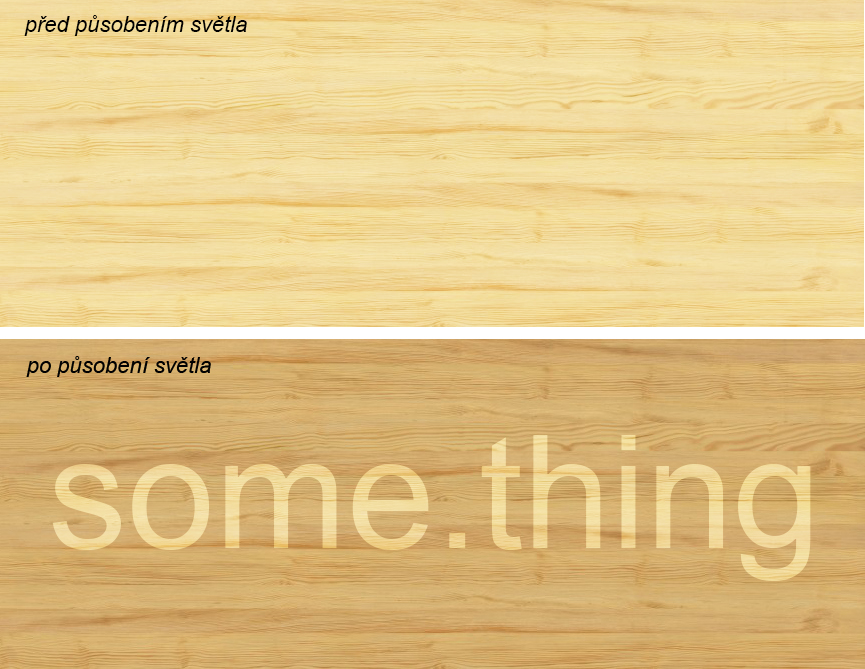

Hello everyone!
I am looking for a coating which would help me execute a concept ilustrated in the picture.
It is about application of an UV filter (or something else) over a stencil with text. Then put this piece of wood under the sun and capture the process of a darkening of a wood where the uv filter is not applied.
However, it is necessary that initially (before illumination) you cannot recognize where the filter is applied.
The result would be revealing of a "secret inscription" after some time.
The object with that use will be situated in interior.
For now I tried to apply some matte transparent stain (glaze) with UV protection over stencil, but i can easily see the difference between treated and non treated wood. (of course!). - treated is little bit darker and glossy (although is should be matte). And also after sun, the uv protection coating did not stop darkening at all.
So i tried again apply the same stain over stencil, then i treated whole wood plate with stain without UV protection. I can berely see where the UV is applied (good!), but the result after sun is again bad - the part with UV came to dark as well. :(
Maybe it is because bad stain with UV protection. but I tried two different kinds of them.
Now i am thinking about http://plajapan.com/images/gallery/b523_f.jpg
I am open and glad for any ideas how to make it. Thanks a lot!

Kevin
i did this before, but not quite how you describe it. How i did it was i taped off the entire piece. Drew the lettering on with a pencil. cut it out with a razor, exposing only the wood inside the letters. Then i sprayed a coat of vinyl sealer that has uv absorbers. remove tape,scuff lightly spray a coat of lacquer, scuff lightly, recoat. Continue until the surface is smooth and you cant see the film thickness difference from where the vinyl sealer was.

thank you Kevin for a response,
did you achieve a noticeable color difference between uv coated and non uv coated wood after a sun bath?
do you remember what kind of a sealer and a laquer exactly did you use?

yes. the wood didnt discolor as much as the part that wasnt sealed.
and no, i cant remember the exact product the sealer was. i tried a few different ones before i found one that worked. if i had to take a guess i would say it was Sherwin williams T67F6 sealers and T77F38 pre cat lacquer

Paul Snyder  Member
Website: http://www.d-and-p.com
Chomin - you are on the right track - you need to block the UV where the stencil/frisket is, but not the rest of the wood.
The easiest solution I can think of is to use Ciba 1198 on the bare wood (as long as the wood is a light color like the example in your photo). I'm attaching a data sheet that describes this direct-to-wood photo stabilizer. Contact your local coatings suppliers to find a source.
Don't use an oil-base varnish over this product - it may prevent it from curing properly.
