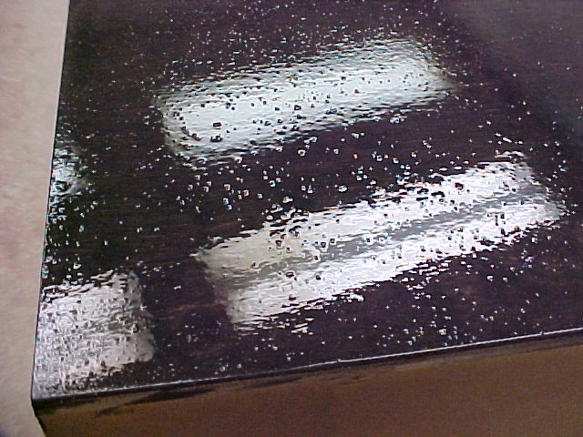

Jim - I see a few different types of wiping stains on the Mohawk site but they are all solvent based and should not raise the grain. Maybe it's just the wood...(?) I've had rare cases where the wood got crazy nibs when I sprayed the sealer - see the attached picture. I just sanded carefully and re-coated. It ended up taking an extra coat - I had to sand the second coat aggressively to get it smooth.
