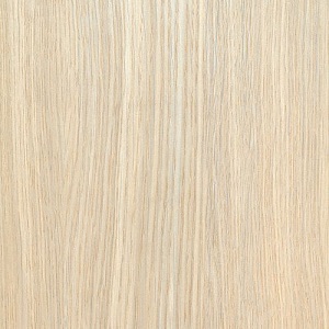

I have a customer who wants me to make cabinets that looks like natural unfinished oak.
Any idea what type of embossed melamine I can use? Or if any possibility I can use some type of finish that will not change natural color of wood
View higher quality, full size image (800 X 500)

That laminate is made by Egger. The link below lists their US distributors.
Eggers USA Distributors

I would do this with Reconstituted Oak veneer if real white oak veneer is out of the question.
Finish would be a flat WB clear, with minimal coats. (as little build as you can get away with). Might mess with the color a little, and fill grain as needed.
