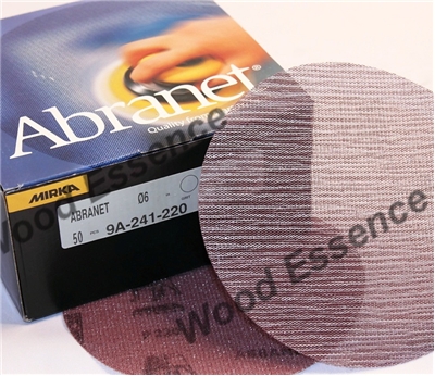

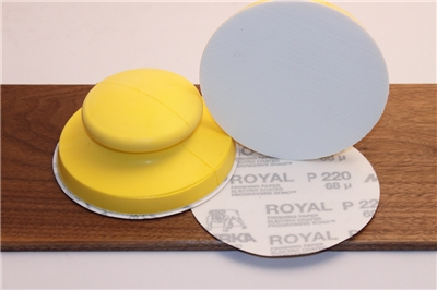

I use a Mirka Molded Palm Sanding Block &
Mirka Abranet 5" H&L Mesh Discs
80-1000 grit.
Lasts for ever, does not clog and can be rinsed out and reused

Wayne - full disclosure, I sell sandpaper. So, there isn't one correct answer. I sell a lot of Mirka to some very high-end woodworkers. They seem to like the Abranet for the reasons stated above. I other customers that prefer 3M gold discs in a 320 grit for scuff / between coat sanding. You can save a little money (sometimes) with the very inexpensive no-name import stuff like the 1st guy's recommendation, but when you start to have finishing problems, you won't know if it is the prep (sanding), spraying, or a bad batch or poor mix of your spray material. Staying with a quality abrasive eliminates one step from the occasional problem-solving process. Now if you just do cheap work, cheap stuff is OK. If you want to turn out a consistent high-quality product, stay with high-quality, consistent supplies.
