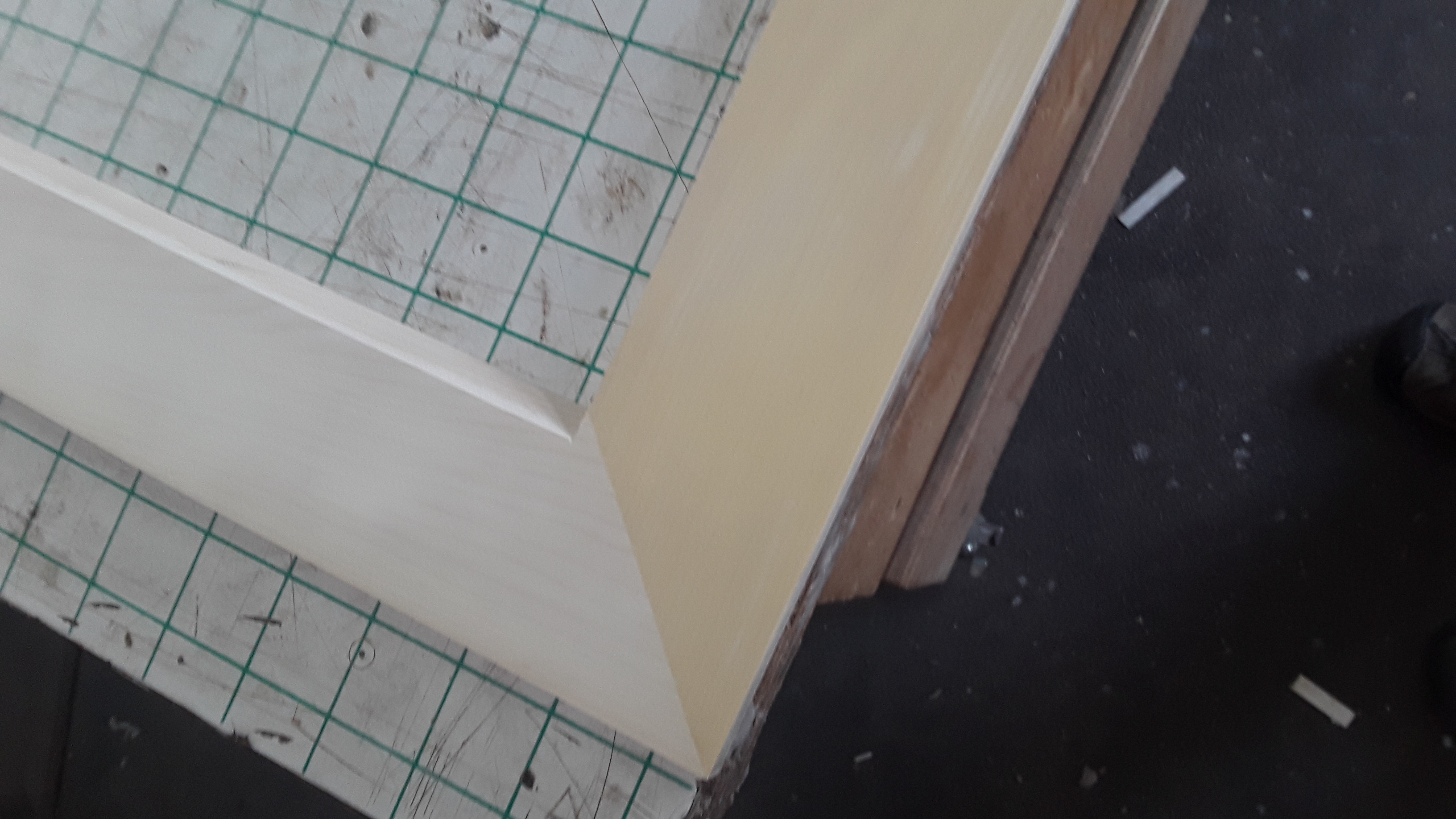

4/4/22       #11: preventing yellowing in maple ...
Julie
I bleach maple regularly with the 2 part bleach... my last piece turned buttercup yellow! in 40 years I have not experienced this before, wood was new, sanded to 220 and dust free. Anyone ever experience this? is there a solution? a chemical reaction?, old bleach? I ended up sanding it back down 80 150 220. not all of the pieces I bleached turned yellow, and they were from the same stick.
thanks for any ideas.
