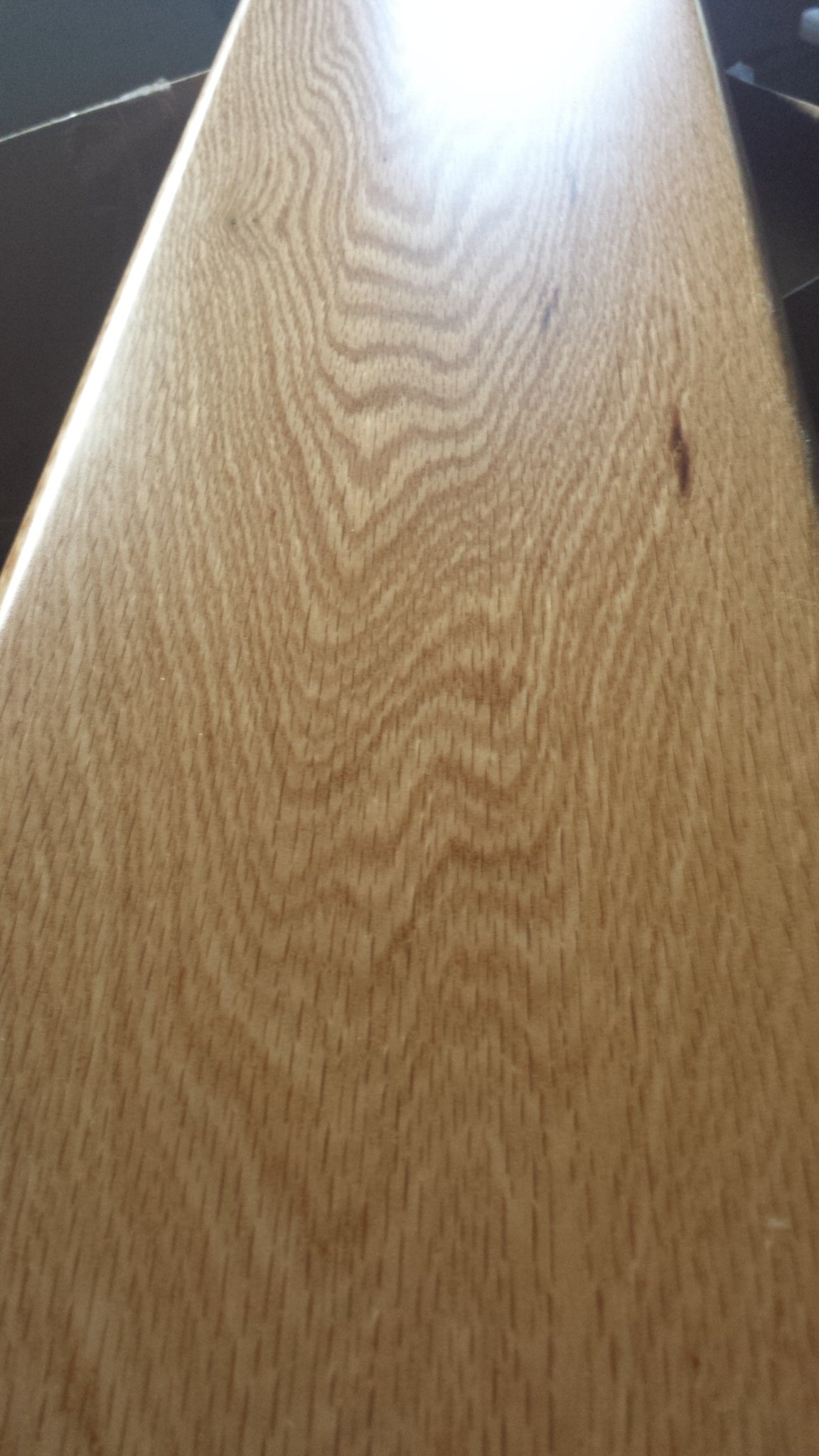

Look into MLC Polarion. Put down 3-4 coats of the sealer at 6-8 mil, 45 minutes apart. Wait overnight to dry and sand back hard with 220 or 150. Put another 3-4 coats down like the first time until filled. Sand back medium hard with 220 until flat. Put on 1 or 2 coats of Polarion topcoat. Comes in flat, satin or gloss.
This is a 2K polyurethane system. I get great results by doing this on Red Oak.

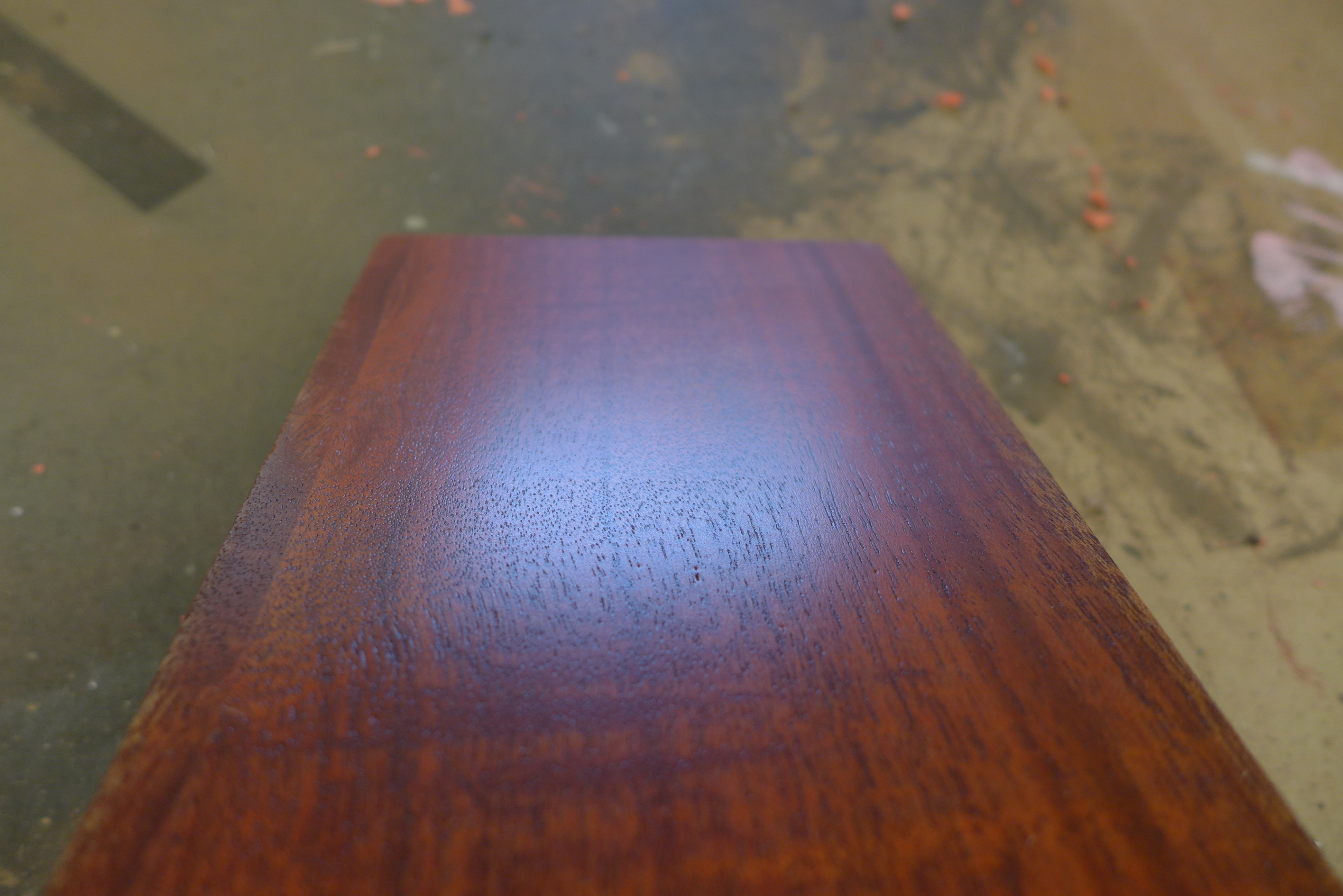

I did try a sample with Crystalac and was pleased. Maker says you can use it intercoat which looks like the way to go.
Sample is: spray dye>lacquer sealer>scuff>Crystalac> scuff>Level>sand 220>level>sand 220>Level>sand 220> two coats Magnamax.
Photo's not great but I hope you can see my tape line with and without Crystalac.
Thanks for the photo Leo. Poly is probably way more protection than this needs and would require yet more experimentation. Plus I just like the way lacquer finishes off.
