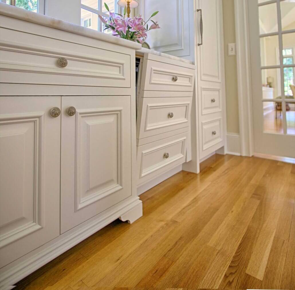

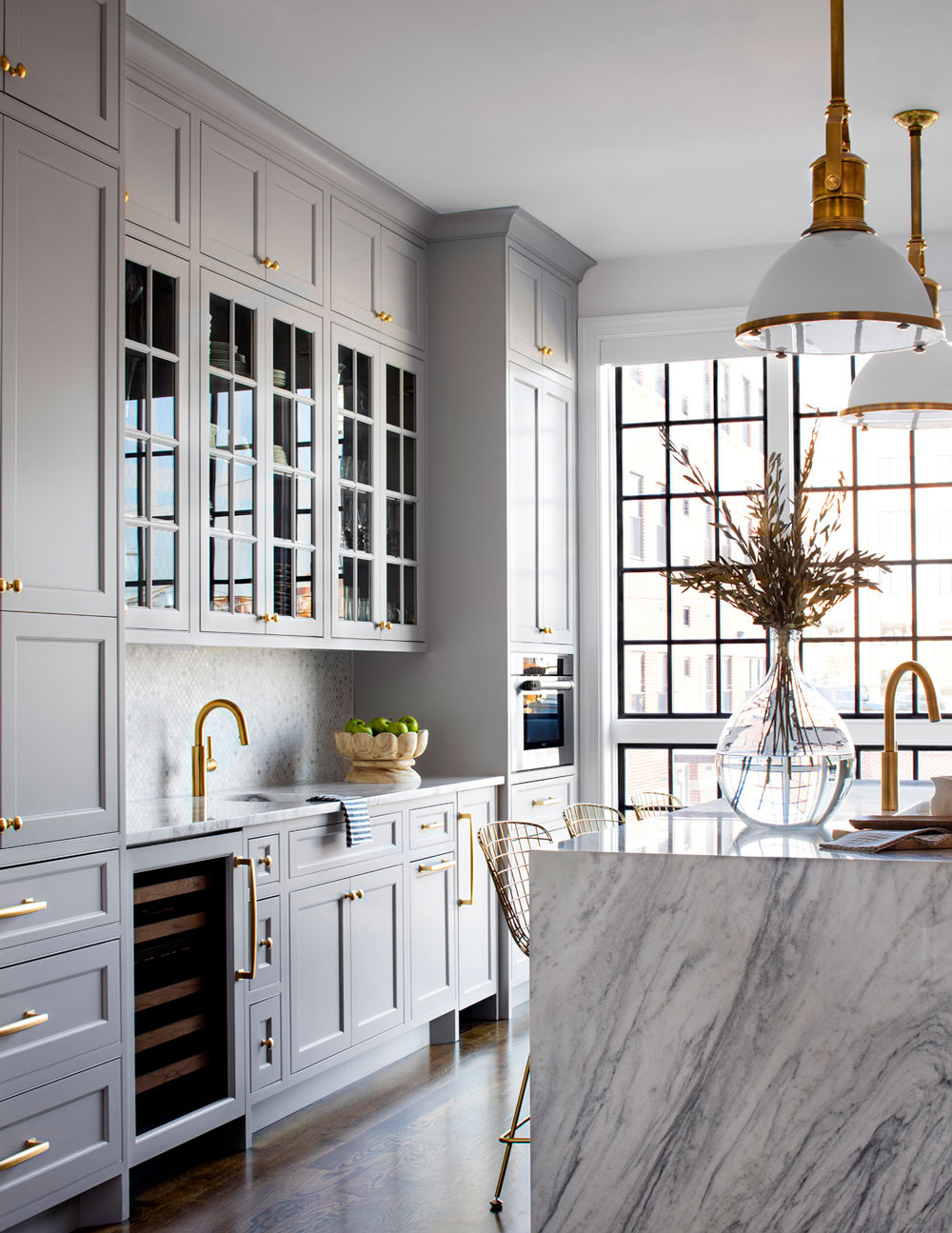

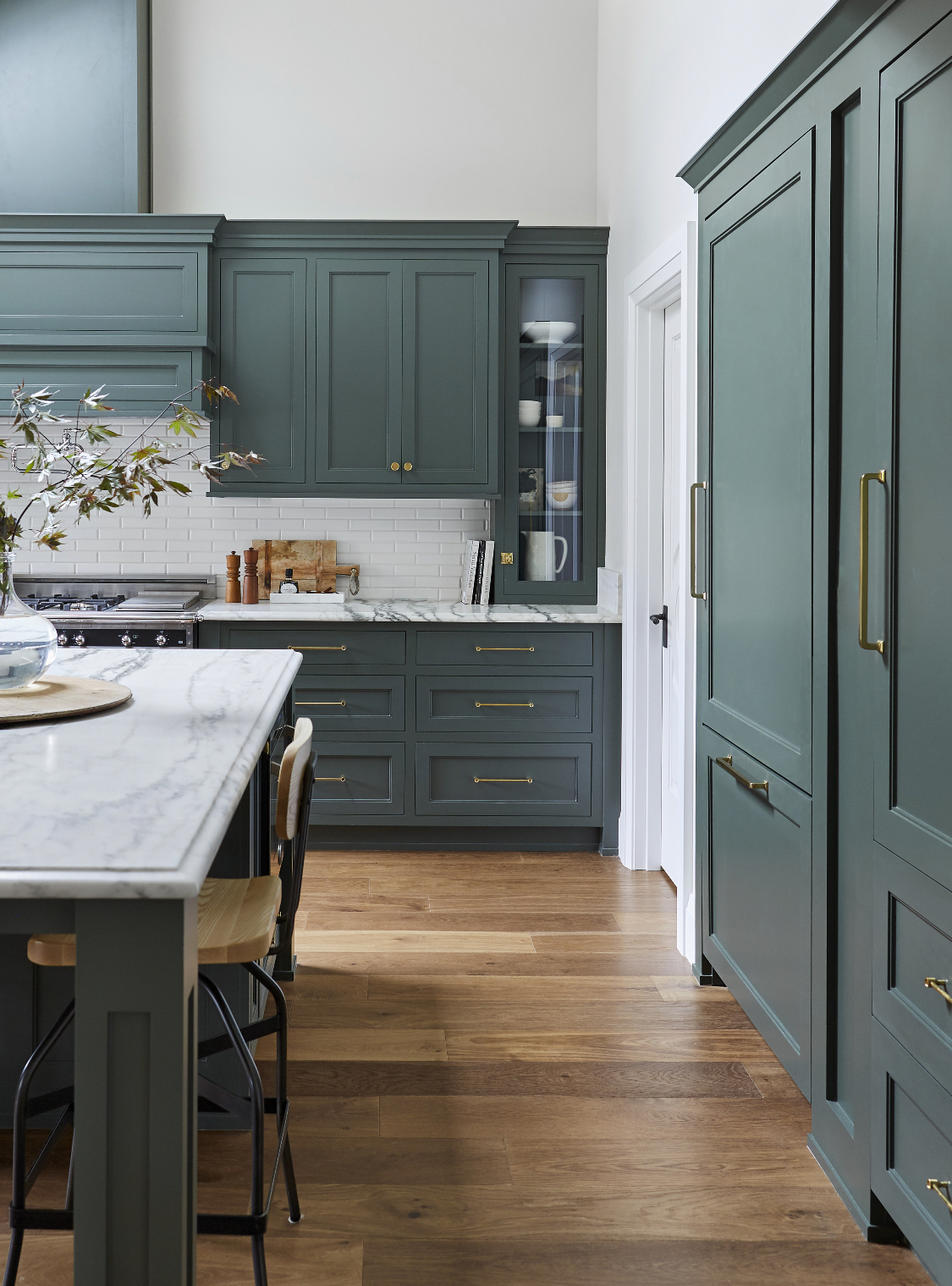

I plan to spray some kitchen cabinets. They have solid wood frame and MDF center panel. The result I want is low-luster solid-color cabinets.
I want everybody here to rank or at least point out the worst and the best schedules. It would be helpful to know the reason behind your worst and best pick.
Below are 6 finishing schedules I have observed from multiple professionals.
Schedule 1
2 coats of Vinyl Sealer 1K
2 coats of Topcoat 2K (tinted to exact color by paint supplier)
Schedule 2
Same as Option 1, but with the Vinyl Sealer also 2K
Schedule 3
2 coats of 2K Poly Primer
2 coats of 2K Poly Topcoat
- both primer and topcoat tinted to the same color
Schedule 4
1 coat of transparent Poly Primer
2 coats of white or grey Poly Primer (White for light cabinet colors, grey for darker cabinet colors)
1 coat of 2K Poly Topcoat (tinted to the exact final color)
Schedule 5
Same as Schedule 4, but with every layer 2K
Schedule 6
2 coats of 1K Poly Primer
1 final coat of 2K Poly colored topcoat
When defining what’s best, I generally think about which one will look the best and which one will be the most durable.
