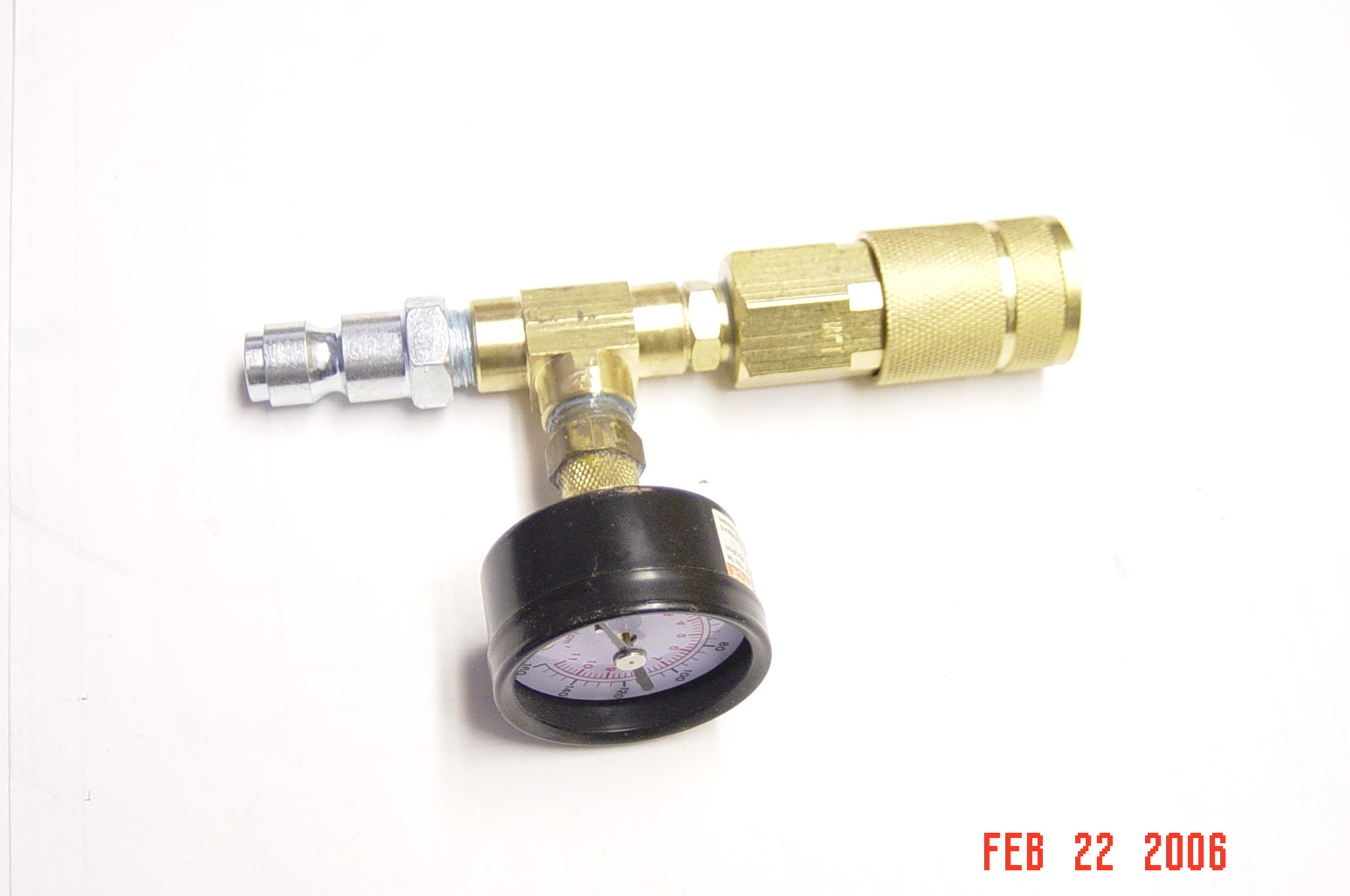

I adjust at the wall for PSI with one of these
I made, a removable gage, then remove it.
That helps cut down the extra hardware
View higher quality, full size image (2048 X 1360)

Jim Clark  Member
All my connections are 3/8" couplers like in the picture. They connect to the std 1/4"
thread the gun and hoses comes std. with.
I get the couplers & fittings at Home Depot.
They have held up for me quite well.
At least several yrs. now.
