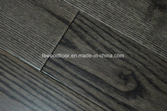

I have uploaded a pic of the look I am striving for. It's a floor but you can get the idea. I got a real sample of a similar floor but could not get a good quality pic myself.
The sheen must me a satin a max and the stain does not change whatever the angle you look at it so I doubt a dye stain was used.
I think I could get that look by using only a wiping stain on the wood itself then use pigments and Dye in the topcoat itself. That way I could keep the clarity to a maximum

I worked with industrial floor long time ago, in the finishing line they use water based stains tinted with chromachem 897 series because of uv light resistence and to get better adhesion. The panels pass through a roller coater with the stain and brushes clean and wipe off the stain. To reach good transparency they use transparent pigments, like black, transparent yellow and red iron oxide , some organics with excelent light resistence. If you want the same color you need to have the same pigments, Or you can have the same pigments with 844 series, wich is solvent based pigments, and formulate a wipe stain with them. Hope I could help you.

thanks for your input mauricio I was suspecting that no dye stain was involed in this schedule.
I already have black wiping stain on hands but with ash the brown yellow still show a lot after the wiping stain.
although I like the transparency of dyed topcoats I will probably add solvent pigments to the first cv coat since they seem to give a richer black. I'll maybe dye the other coats depending on the results to not obscure too much

Pascal, if you add some blueish red colorant to your black wipe stain, it will kill the greenish yellow you have
Could be a dye or a pigment paste, just a little, make a test in a scrap first to check the color
