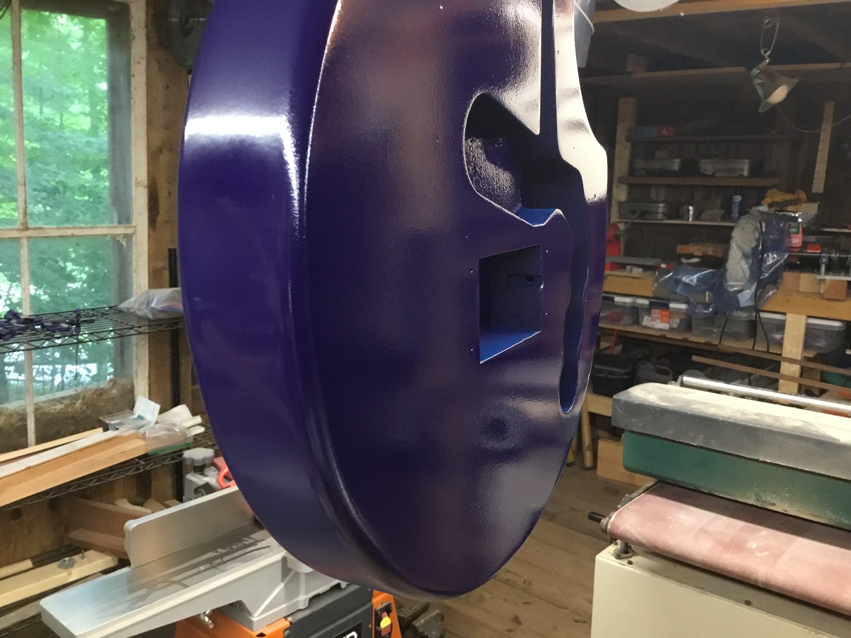

So I've been trying to paint my solid guitar bodies now for about four or so years. I started out with single stage, moved to 2K polyurethane and I'm now using NC lacquer. My latest process is to sand the douglas fir with 180 grit. I then apply three to four AquaCoat coats to fill any anomolies and I sand in between each coat, usally with 320 grit. I then move to three coats of vinyl sealer lacquer and I sand after the last coat with 320 grit. So, bottom like here is that I feel the body is well filled, sealed and sanded smooth and ready for some color. Here's the thing. Without fail, the sides of the guitar always come out perfect. And I mean perfectly smooth with not a micron of orange peel, However, it's ALWAYS the front and back of the body that has the issues, (and the rounded areas), whether that be sandy texture from dry spray or orange peel. So my obvious question here is... Why? Why does the side of the guitar take the spraying perfectly? The only thing I can think of is that the fan envelopes the entire side as I go by. Maybe if I had a twenty inch fan and could make one pass over the front and one pass over the back, covering the front and back completely in onepass then things would be different. I have no idea. Your thoughts?

My guess is that you are changing speeds of how you move your gun. The body coats also look dry to me. But I'm also suspicious about all the layers under the NC lacquer. I'm certain I would not start with a water based primer under those hot solvent based materials. I assume AquaCoat is water based with that name. But I would not start with Doug Fir either. Isn't it really tough to properly sand and not get a ripple from the early to late grain hardness difference?

Yes, it's a real PITA. I look for older, very tight lines and that greatly helps. The Doug Fir though is a great body and neck wood. It's very light but very stiff and it also has a nice tone to it when knocked. I haven't seen an issue yet with the AquaCoat under the vinyl sealer, but that doesn't mean there isn't one. As far as speed goes, it feels to me that I am going the same speed. I've sprayed about forty bodies now and the same thing always happens, leading me to believe that it's something else.

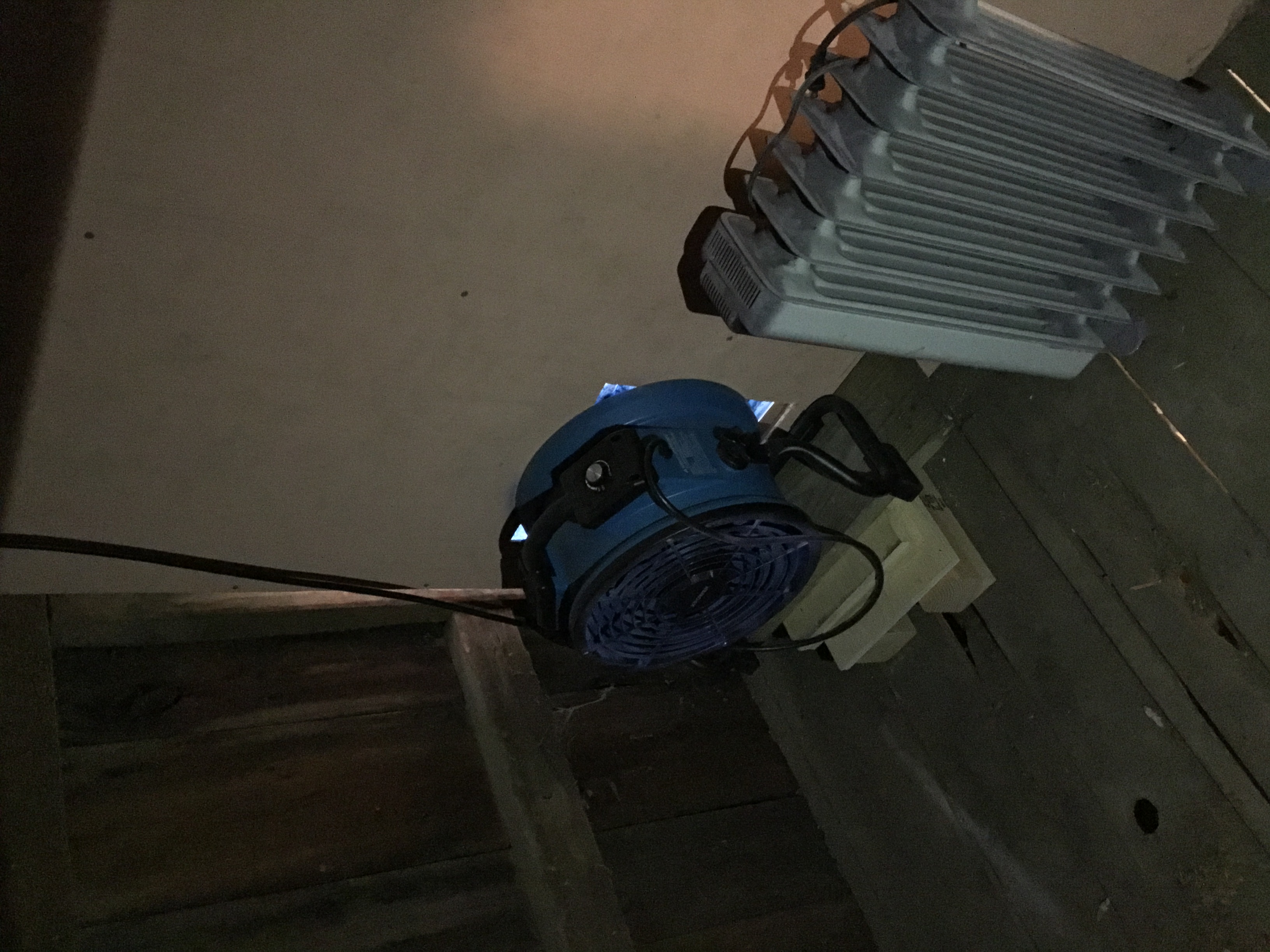

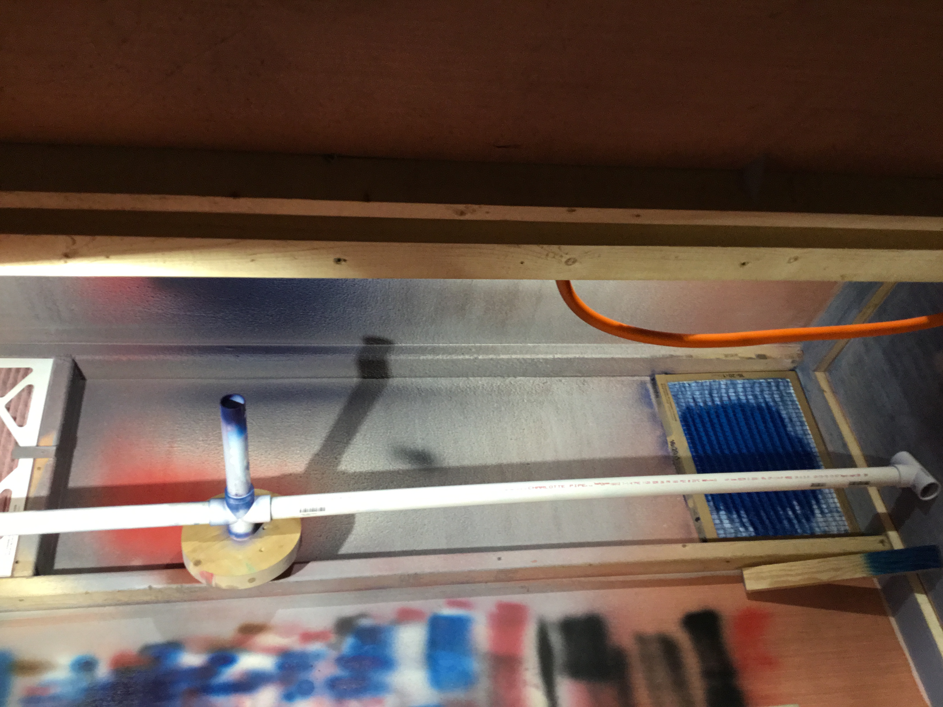

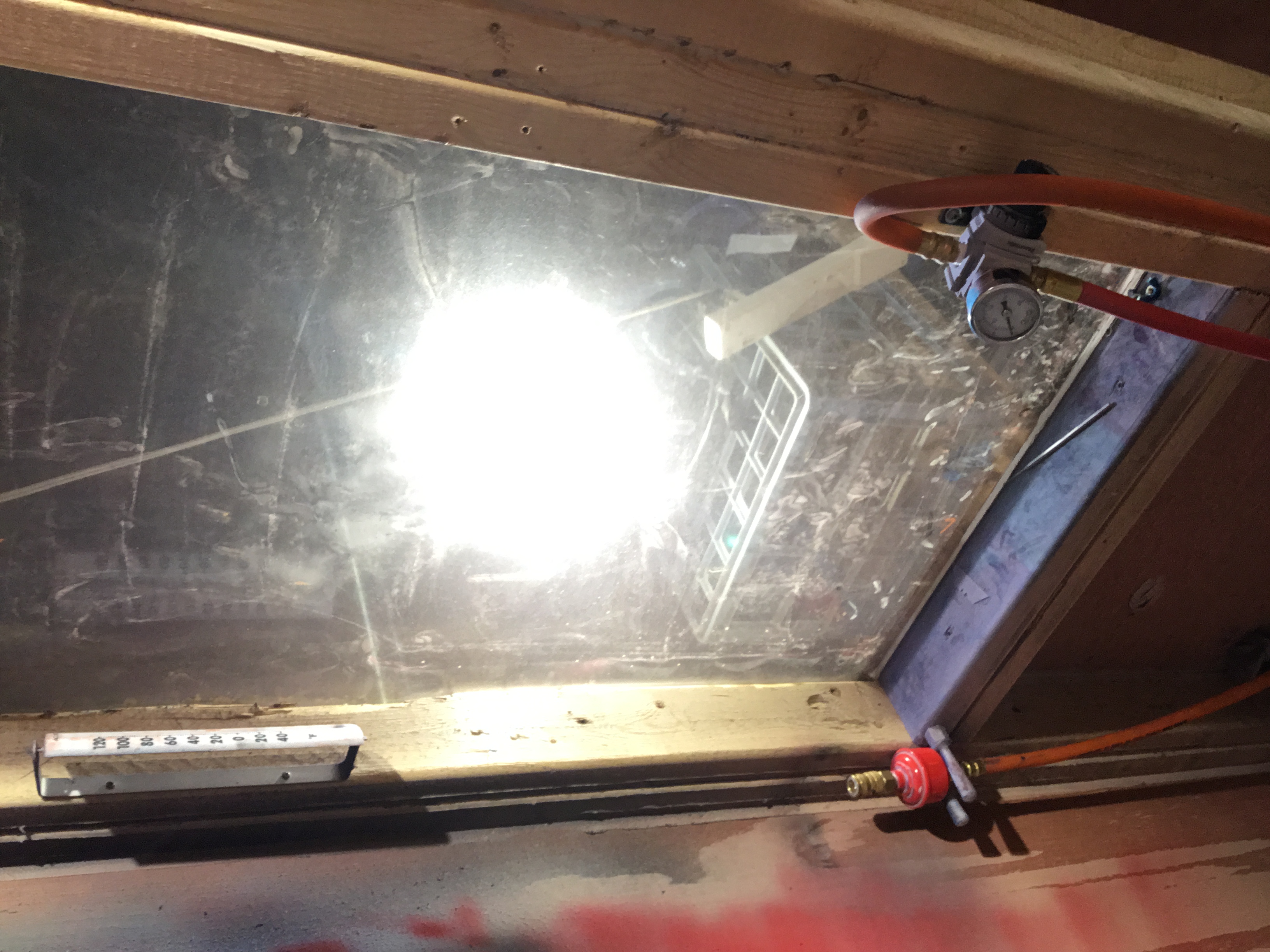

I add a cap full of retarder. (I know, I'll start measuring exactly in the future.) I will definitely turn down the exhaust fan next time. Here are pics of my set up. You can see my old Fuji in it. The guitar body is on an arm that mounts to that horizontal pvc pipe.

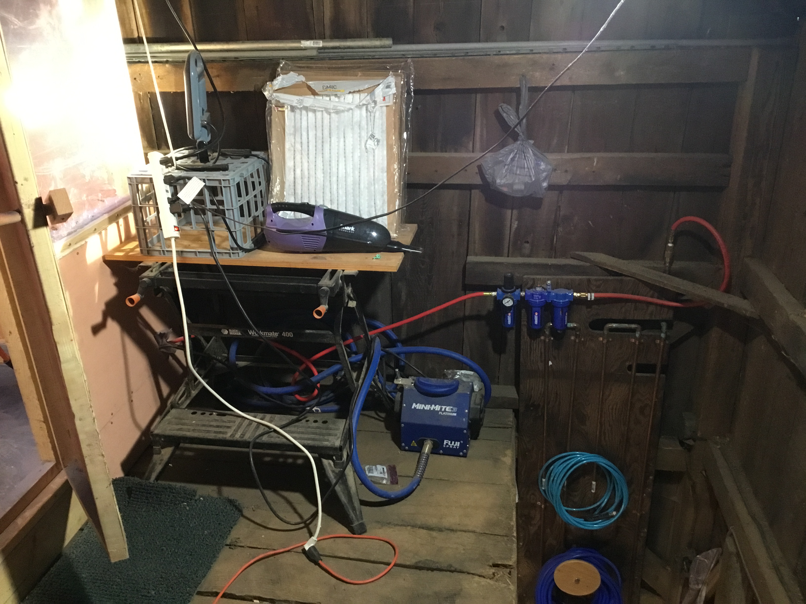

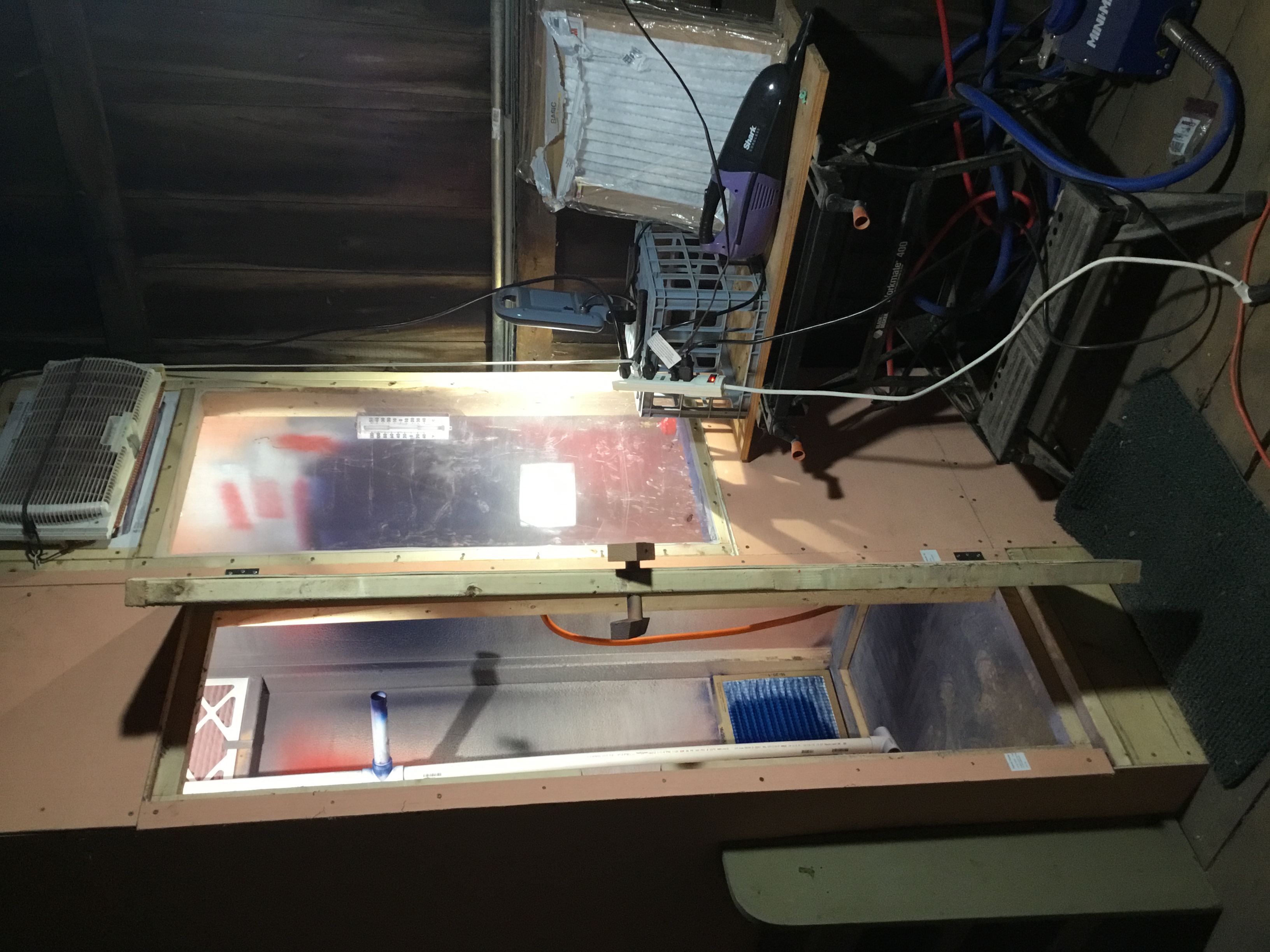

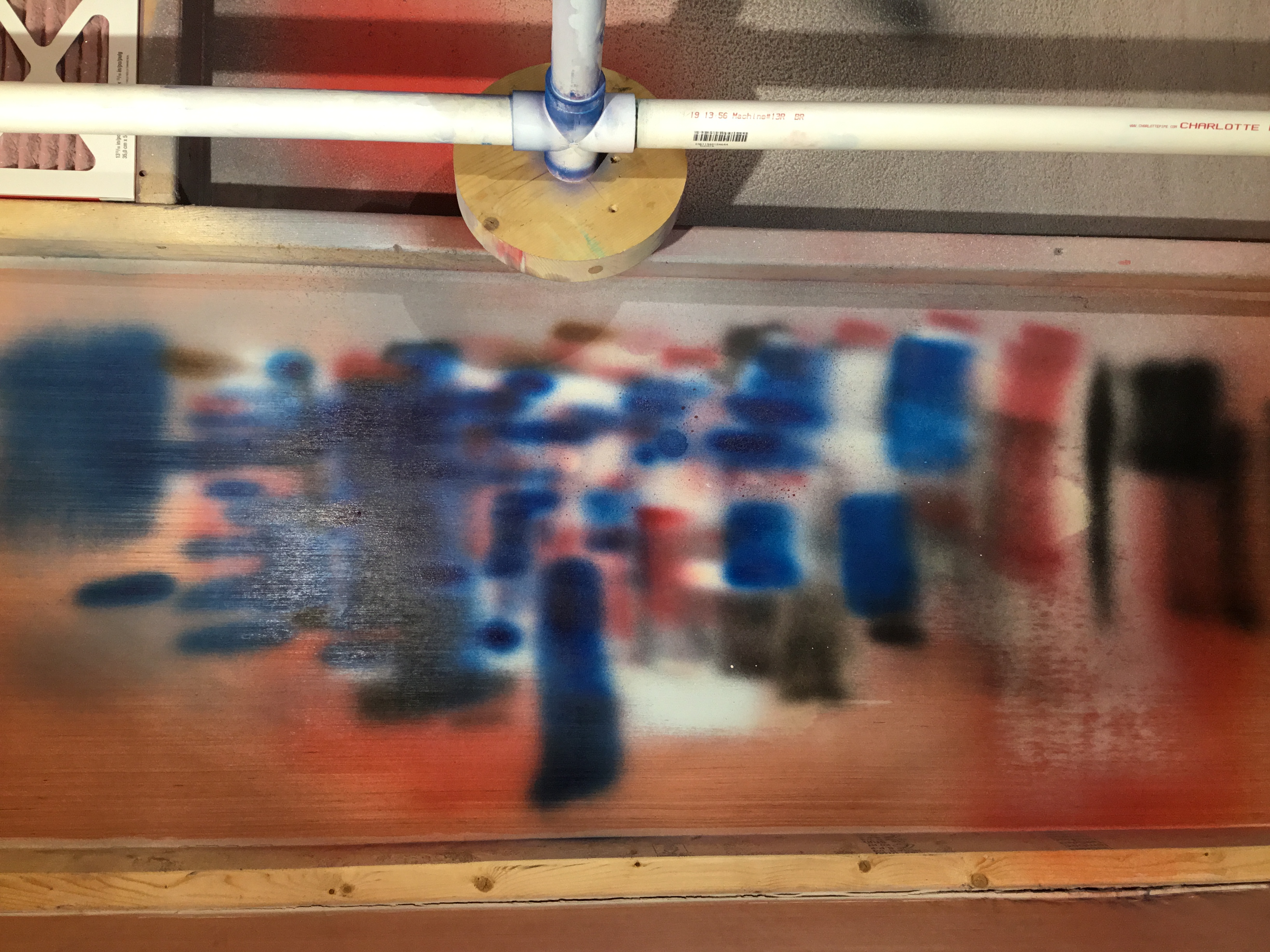

Maplehead Member
A few more pics. I don't use the gauge at the gun anymore. You can see it here, (lower right corner of pic), mounted inside the booth. After that is a 6' hose to the gun. I have a secon, LED light above the inside of the door that's not in picture. The fan in one of the intake windows I no longer run.

Ok. I'm on board with too much turbulence. Your room is tiny only 112cuft. At 1750cfm you're emptying it in seconds. Replace the window and the door or even the whole back end with mesh filtration. Also I'd raise my exhaust port to work height. I would also think about making a jig to rotate the guitar with a lathe type setup to facilitate horizontal spraying.

The jig does rotate. Are you saying I should spray the front and back of the guitar body why horizontal? I never do. I always have it vertical, facing me. Also, in my research it seemed bottom exhausting is best. The spray eventually falls anyways. What benefit is it to have the exhaust level with what I am spraying? Lastly, in practicing today I did turn down the exhaust a lot. I don't know if it helped or not. See my odd results on the plywood I sprayed in my other post.

Whenever I'm spraying a fixed shelf unit I always put the bottom shelf up on the last coat. This gives me the best/smoothest overspray free result. If I were spraying a guitar I would spray horizontal so I could wet out the surface as much as possible. Do the bottom first then roll/spin it and do the top or viceversa whichever gave the best finish on the face. The down facing surface is very very resistant to running even with a heavy coat.
As for exhaust height I want as much overspray exhausted as quick as possible. Your setup it's just bouncing off your back wall and you're getting rebound onto your guitar before it makes its way down to the floor. At a minimum you should have some mesh filter material on the wall you're shooting against to absorb your overspray.
