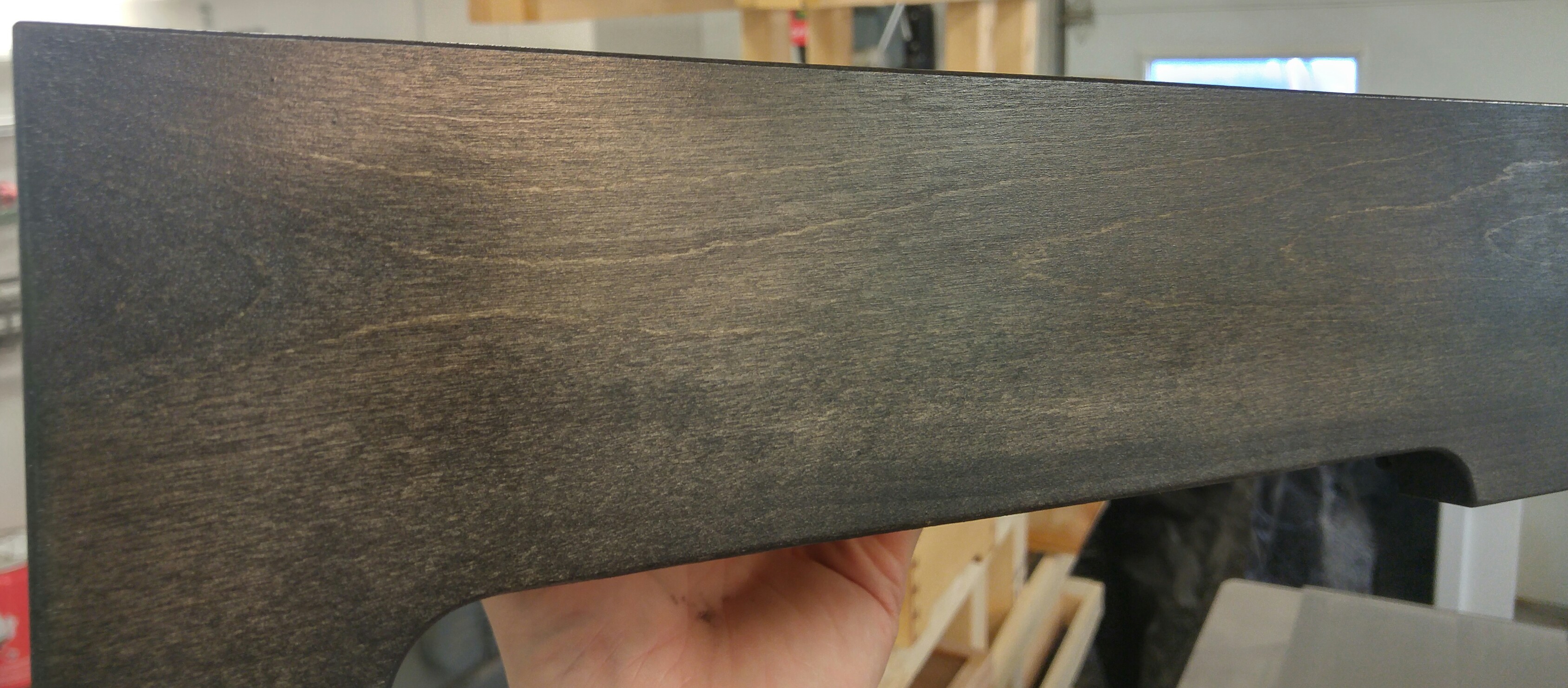

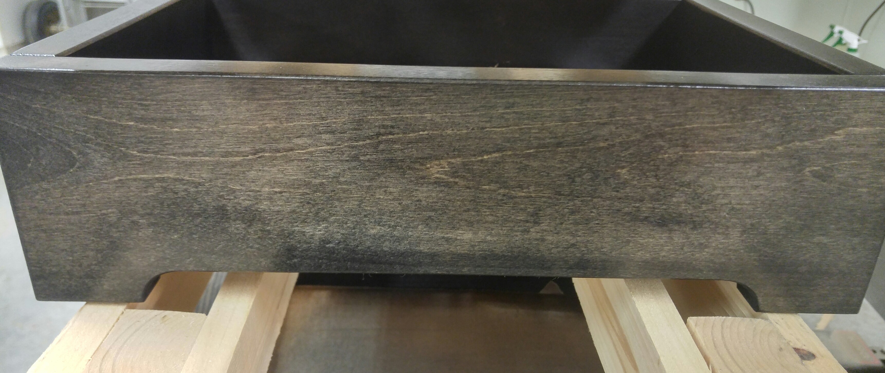

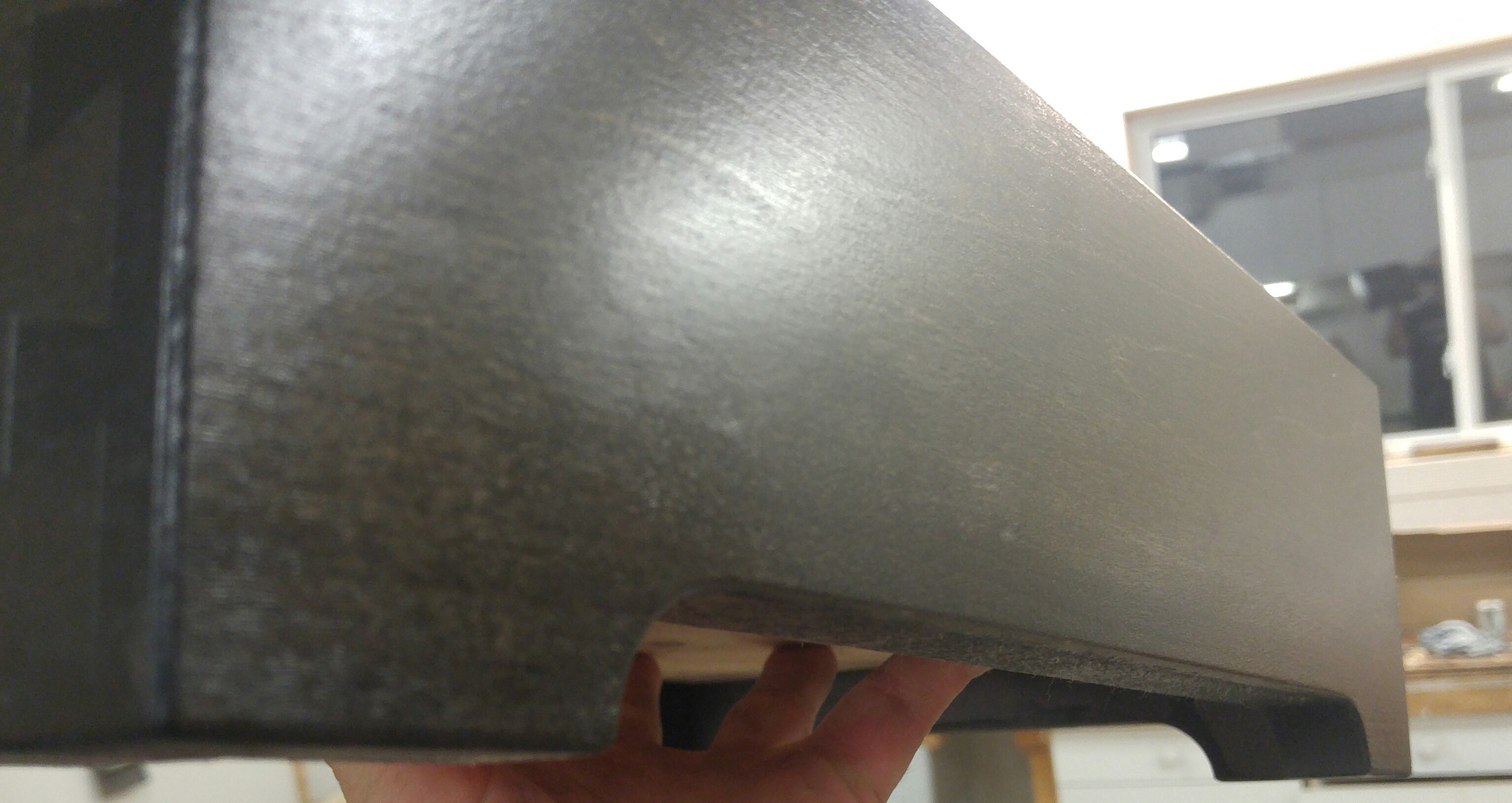

since pictures are worth a thousand words here are some.
right now I have a sealer coat and a topcoat sprayed.
only one coat to go
View higher quality, full size image (3560 X 1405)
View higher quality, full size image (2228 X 2244)
View higher quality, full size image (3375 X 1481)

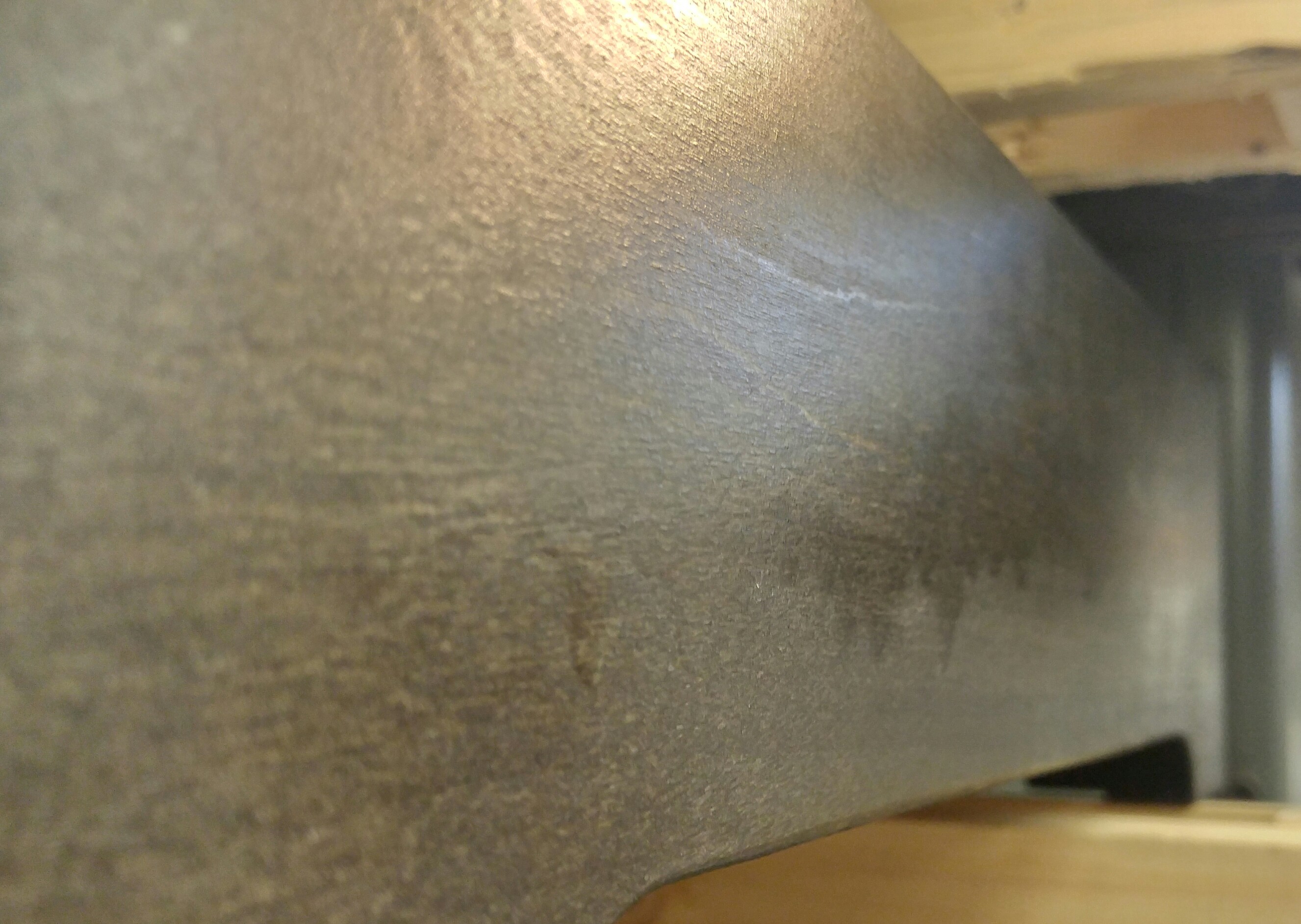

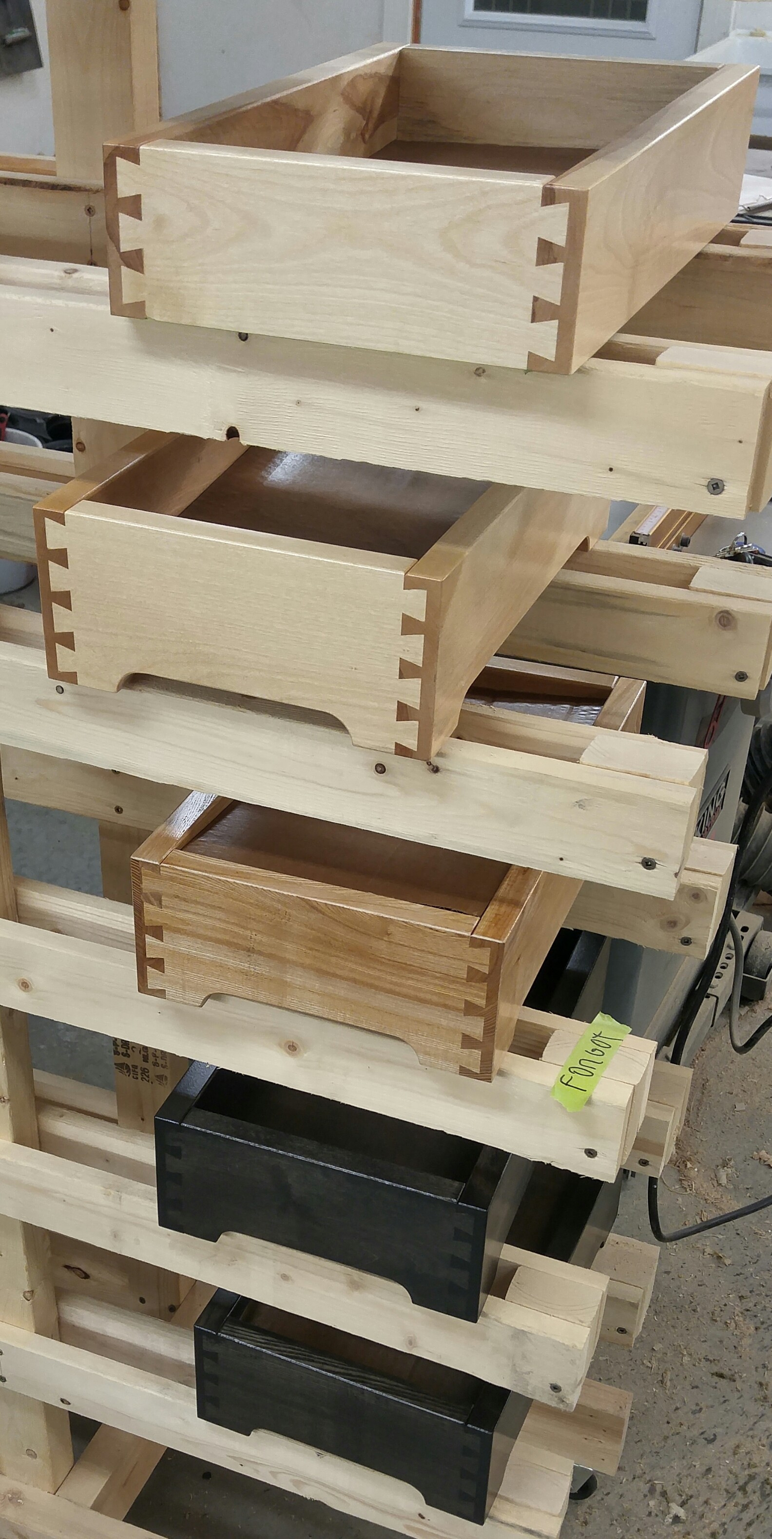

more
View higher quality, full size image (3226 X 1550)
View higher quality, full size image (2653 X 1885)

Pascal... Those should clear themselves up with a careful sand and recoat.... if you still see them another good scuff and recoat will take care of them but you are getting in the territory of a filled finish... so if your trying to have an open pore finish you may be better off grinding the face down and starting over IMO

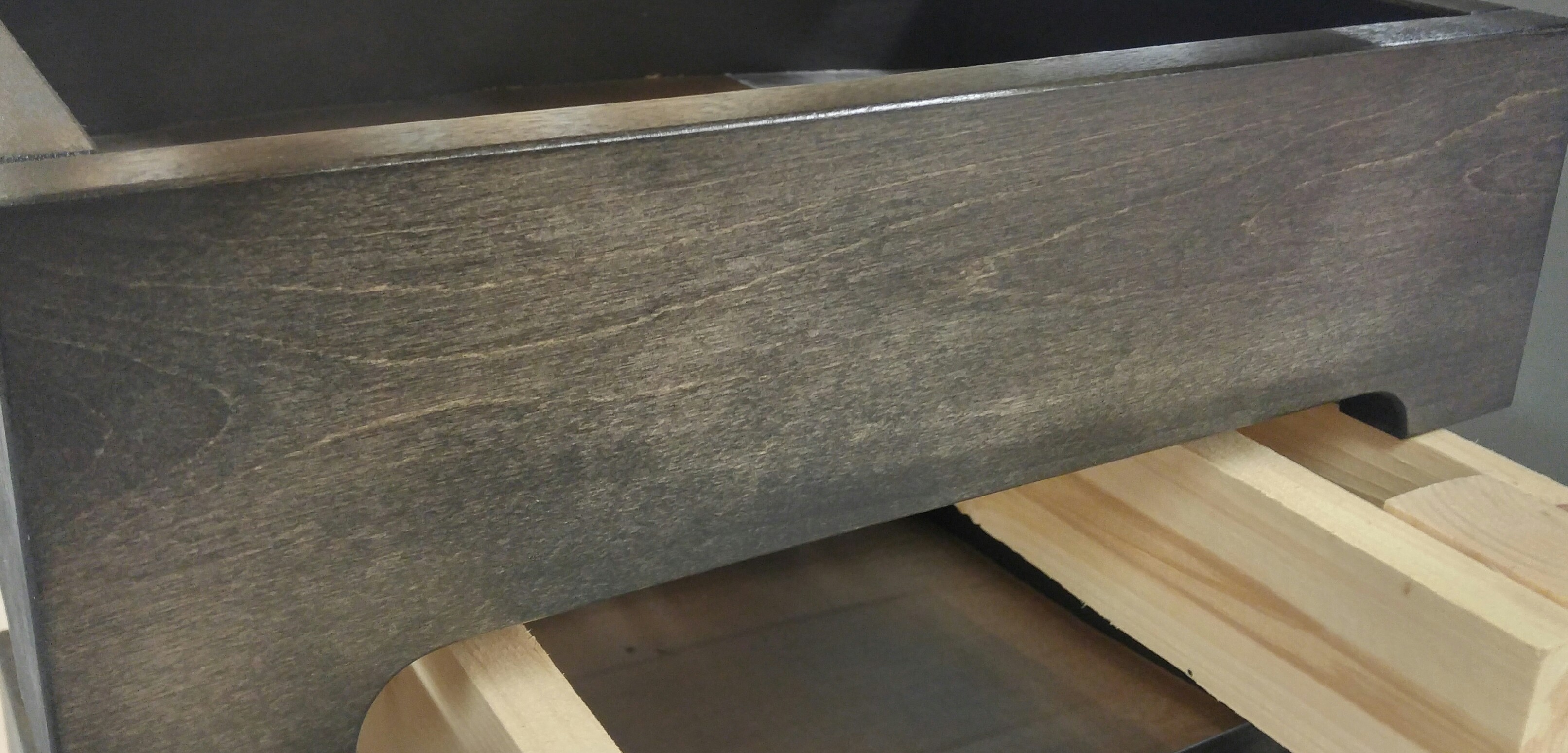

oh forgot to show some pics since youve been helpfull.
first one the front. I wont lie there has been some sand through but hid them well with Qtips and dye concentrate.
second one is me trying to get most of sheen to check for runs
last one is some finished boxes ;) dont mind the cardboard inside I prefinish the inside before assembly and use it to protect the bottom
View higher quality, full size image (3443 X 1452)
View higher quality, full size image (3068 X 1630)
View higher quality, full size image (1584 X 3158)
