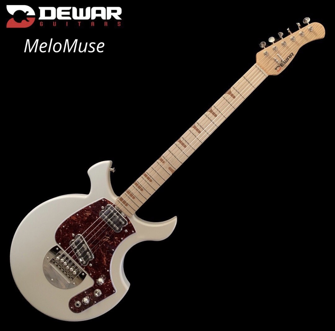

It can go to 5" wide but I try to keep it around 3". I'm spraying a solid body that's 12" wide and the sides are 1.75" wide so I figured a mini gun, with it's low psi requirements, would be perfect. Here's the guitar. PS: Except for the tuners I also make all the hardware and pickups. The bridge is my own tool-less design.

Mastercabman
VERY NICE!
