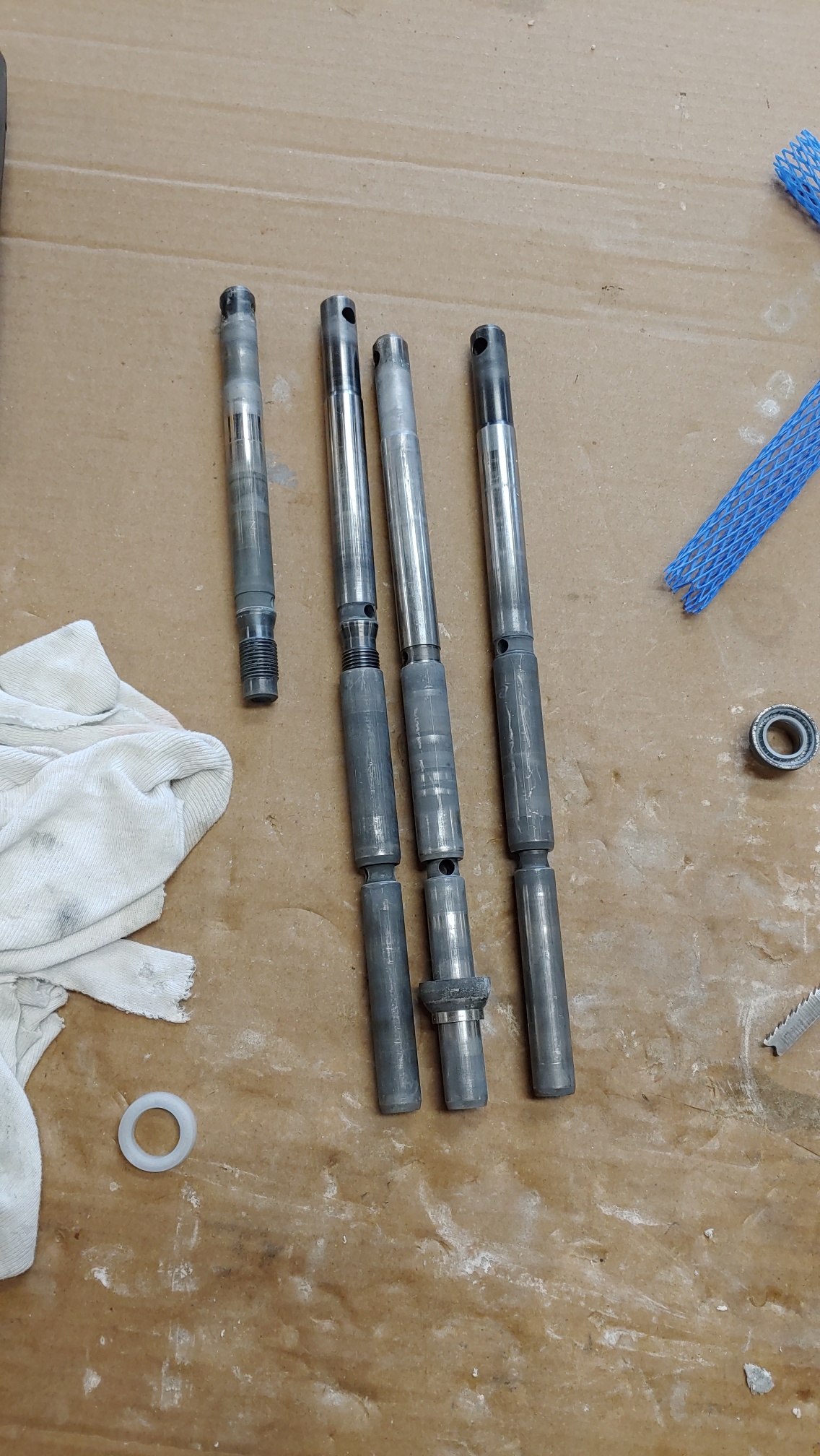

7/30/20       #25: problem with 2k AAA pump, time to r ...
Nathan Barnard  Member
Website: http://www.nathanscustomcabinets.com
Here is the used pump shafts from the past seven years. The leak is on the center portion of the shaft (there are three surfaces on the double shaft). Top has v packing with jamb but, bottom has a ball and seal center just a seal. I don't know what condition these shafts should be considered, are they extremely worn or just ready to be replaced, etc?
I have been quoted by a hard chrome machine shop $275 to grind and chrome one 6" section. I also sent them the link below to kremlin's process of triple playing and they quoted $875 each. The price of a new shaft is about $200 IIRC. I don't know the quality of CA Technologies process vs Kremlin vs 3rd party chrome plating.
https://www.sames-kremlin.com/canada/en/technologies-triple-chrome-lay
er.html
As for precision diameter I don't think that is critical as the seals are spring "u" shaped and can adjust to diameter. What's more important I think is a very smooth surface. When etched like they are now, probably microscopically, it is hard for the nylon/teflon seals to work.
View higher quality, full size image (1136 X 2016)
7/30/20       #26: problem with 2k AAA pump, time to r ...
Hey Herb I forgot to respond to you. I have tried several of these different shafts when I was working on it a couple days ago. All had the same problem. I did take a couple of the lower pump rods apart to inspect the internal ball and seat and they looked pristine. A little tricky to get them back together (cat recommends not taking them apart).
Turned out it was the seal was quite loose on the shaft (it would almost fall off the shaft by gravity on the bench). After stretching the metal springs with a curved pick it was quite tight and the pump worked MUCH better. The trip guard mechanism is extremely precise so the smallest imbalance in the two pumps especially over time, will set it off. With the catalyst pump under 20psi air pressure the seals will hold now in both directions without shaft moving. I think Cliff at cat explained at 20psi on air motor the catalyst pump is producing 1000 psi liquid, anything over that it will push past the seals OR the spring pressure relief valves in the quad block.
