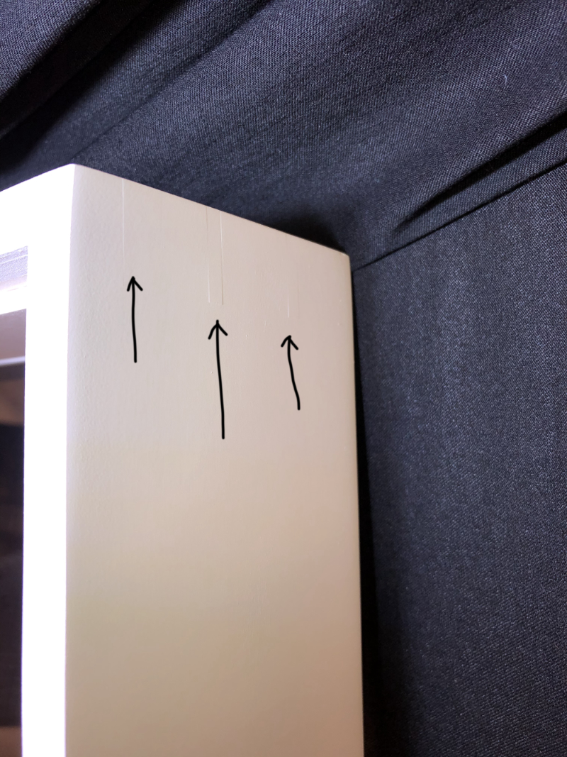

I did a project last month with painted maple and I reinforced the mitered corners with splined corners. The problem is that I 'm realizing now that I can see the shape of the splined corners under the paint, as in the picture, even with the finger I can feel them and before I applied the paint I was sure that all was smooth under my finger. I'm suspecting that because I'm using water base primer and white paint, those make the end grain of the splined corners absorb the water and make the splined corner swell.
I usual sand my project with 150 sand paper before apply the primer than I sand the primer with 220. Than I ply another coat of primer and I send it with 280 followed 400 because I need a very smooth surface. At that point the splined corners are flat and no problem show. After that, and I wait one day, I apply a coat of white paint (Water base Ilva) I'm not sure but seem to me the problem happen after several days after spray are applied. Maybe the water absorbed by the wood take few day to swell the splined corners. I been thinking to apply ,to the area of the splined corners, a seal coat of shellac before I apply primer and white, maybe it can help.

Wow. If that was flush and not visible they sure did move.
I assumed you used a water based glue in the splines. You need to wait at least 3 days for the water to come out of the joint before you can final sand. For me, I glue, sand flush with 100-120 grit apply filler no matter how good the joint is and set it aside for a few days. After that I sand to 150 and then prime. If you can see any hint of the joint scuff it hard and apply another prime coat to flatten it out. Then paint as usual.

Thank you Leo for your suggestion. Yes me too I wait 3 days before send it after glue apply, I usual use water base glue and sometime also epoxy glue for the splined corners. In the next similar project I will wait more time after apply the final paint coat over the primer. Like I wrote before, after I apply the two primer coat, than sand it and no problem at this stage, I apply the final coat of paint the follow day, but maybe will make sense to wait another 2/3 day before apply the coat of paint to see if the primer did make the splined swell.

Is there end grain on the splines ? what are the splines made of ? this may be a concern.

Yes , end grain of the splined that are made of hard maple like the frame

Hi Stefano, it looks like maybe you have a Maple face but is that a plywood side ?
If so the solid splines and the plywood are not going to move the same, if that's the case they will never stay smooth.

Looks like it's both shrunken and swelled, that's odd. Why so wide on the splines? I'd suggest a spline down the center of the miter from front to back, hidden. Can easily be done with biscuits. Surprised you need that kind of strength in the box with a face frame.

D. Brown, all made by maple and not plywood parts.

Leave them and point them out as subtle examples of the level of craftsmanship you provide. That is what they are.
