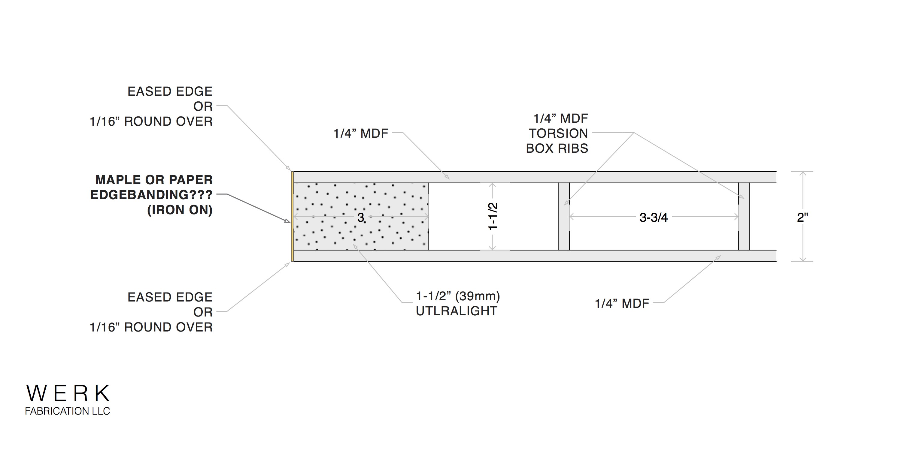

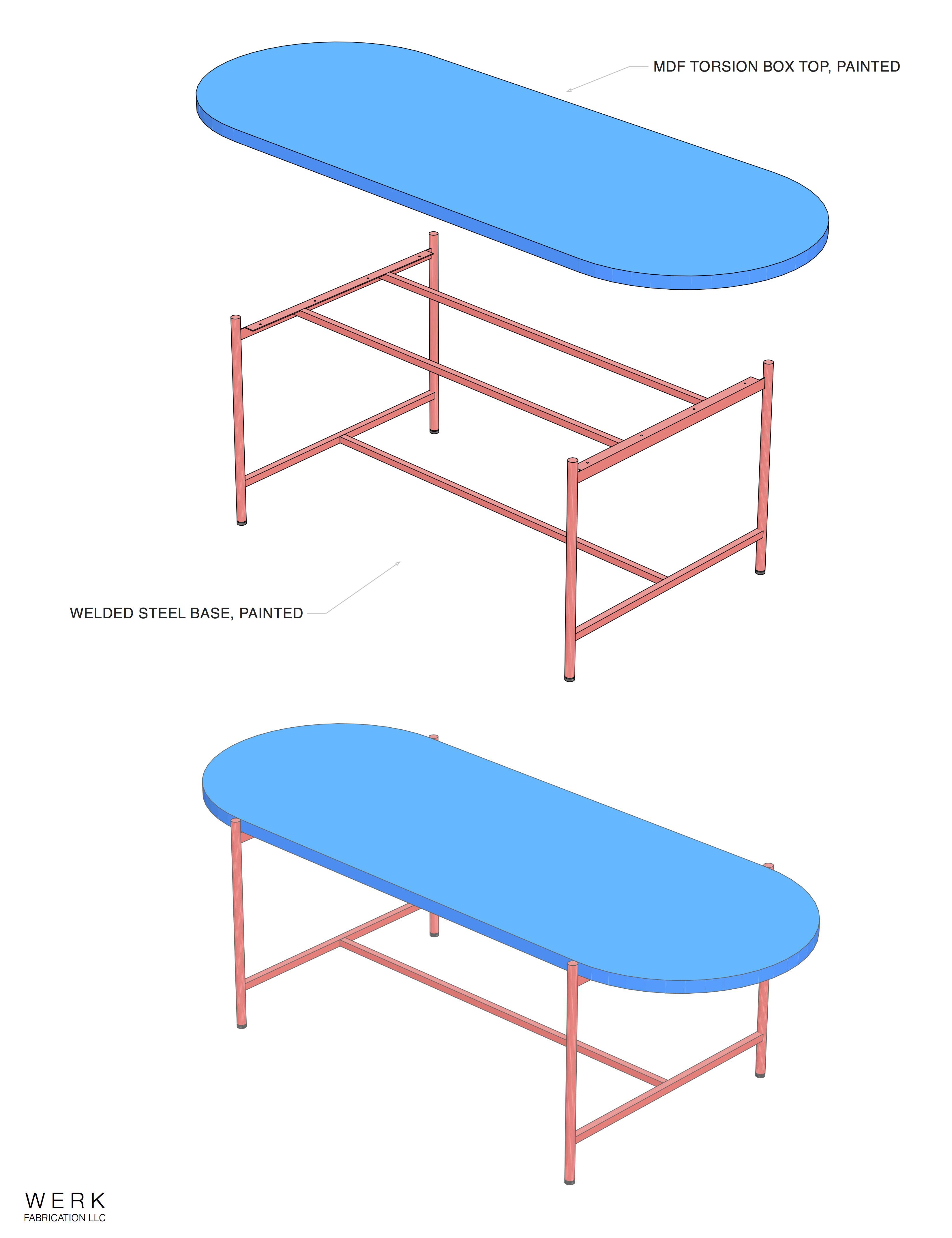

Hi, I've been a Woodweb reader for many years and never posted before, but I'm stumped by this detail and could use some input!
Having researched this question I've landed on posts warning against using a built up MDF edge for paint grade -- in this case a table top: 1.5" ultralight + 1/4" MDF skins. It's said that the seam will telegraph eventually regardless of treatment.
However at least one person advised that the built up MDF edge is fine as long as the lamination is done without excess PVA glue, and allowed to rest for several days before final sanding. Or can that technique plus full coat bondo or vinyl wall spackle on the 2" edge do the trick?
It seems that the recommended treatment is edgebanding -- either maple or paper. My fear is that in this case, with a pigmented finish table top, telegraphing of the seam at the top edge will be more unsightly than on the sides. I'm assuming 1/16" round over will not work on the edgebanded edge? Can these edges on be lightly eased?
I don't have an edgebander so I'm limited to pre-glued iron on. Is carefully edgebanding with PVA glue instead a better option over the iron on in this case?
Planning to use ML Campbell pigmented CV in satin.
Thanks in advance!!

Over time and environment changes, we've found that that glue line eventually telegraphs through. We also use ML Campbell Stealth and Turnino. We now edgeband with a paintable pvc and do a 1 mm roundover. Of course, we are doing it with an edgebander.
