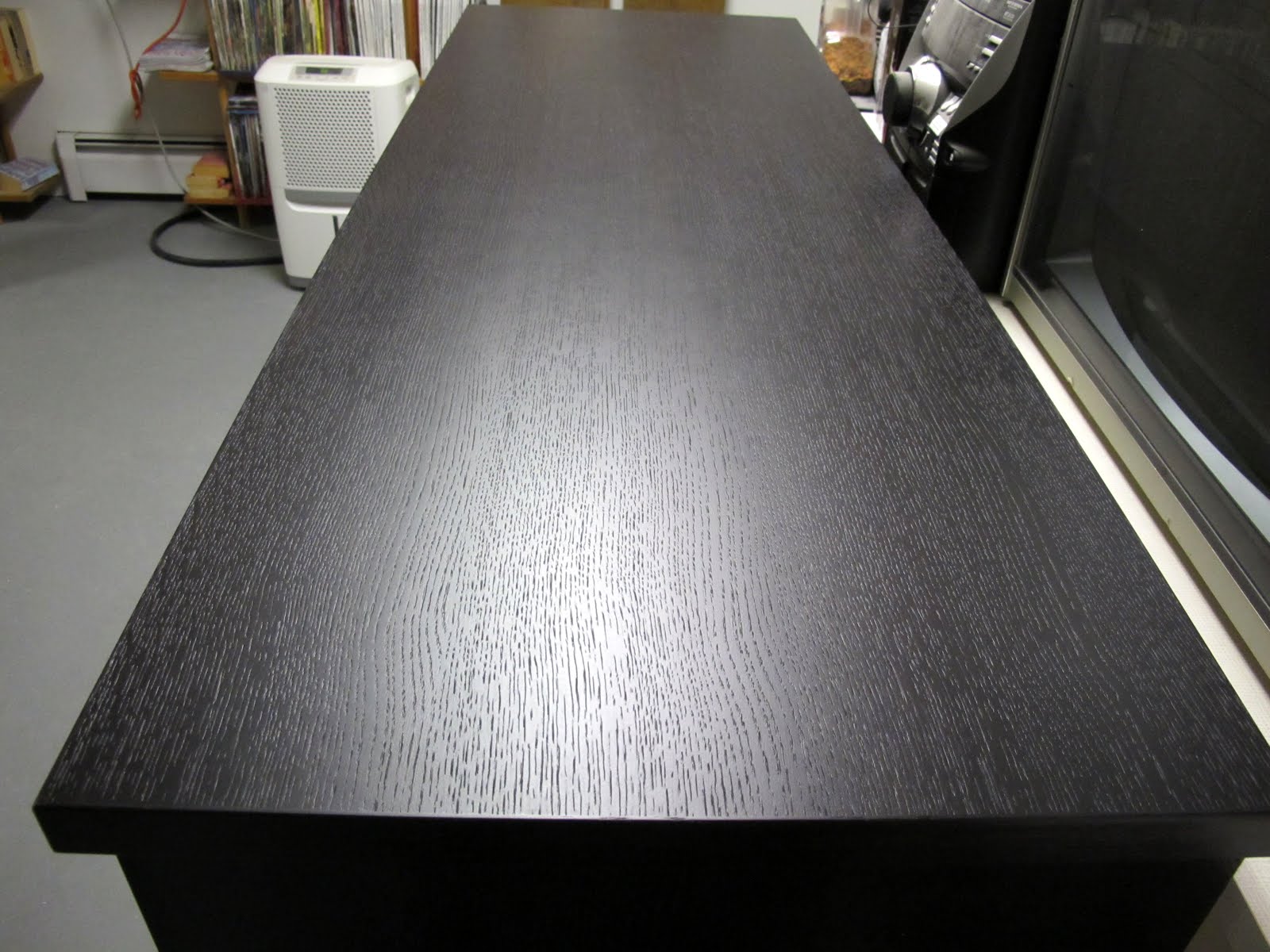

Get some Sherwin Williams BAC Wiping Stain. You can get almost black with one application on oak. They have several stock colors and will custom mix any color you want. Here's a photo of some rift sawn white oak I did with a custom BAC Wiping Stain.

John Member
Let's try that again.
View higher quality, full size image (2272 X 1704)

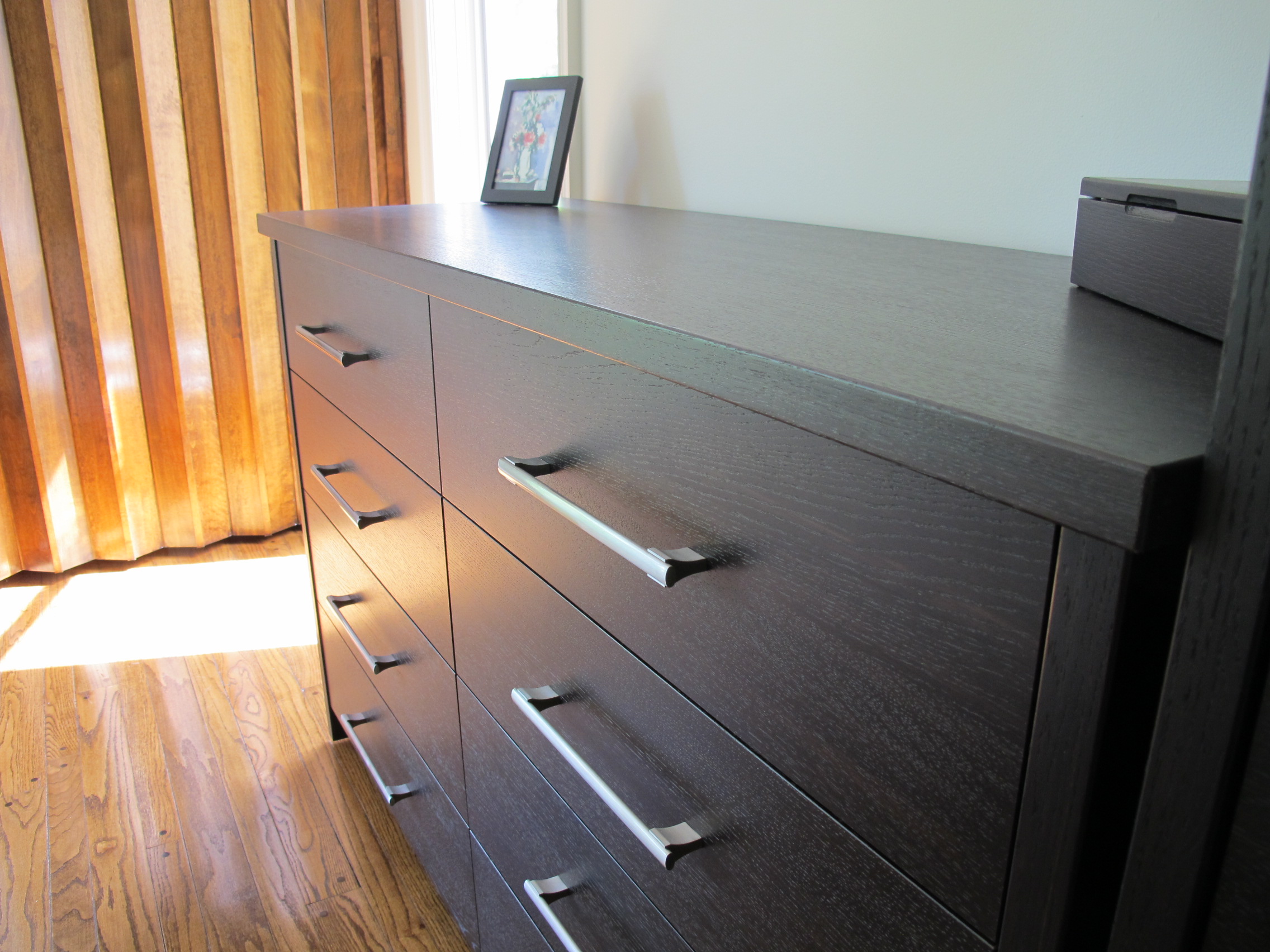

John Member
Yes, you can dye it first and then stain it, or you can use something like SW's BAC Wiping Stain which has both dye and stain in it.
One coat on white oak.
3/19/21       #17: Getting Dark Brown Stain ...
John Member
OK, maybe now.
