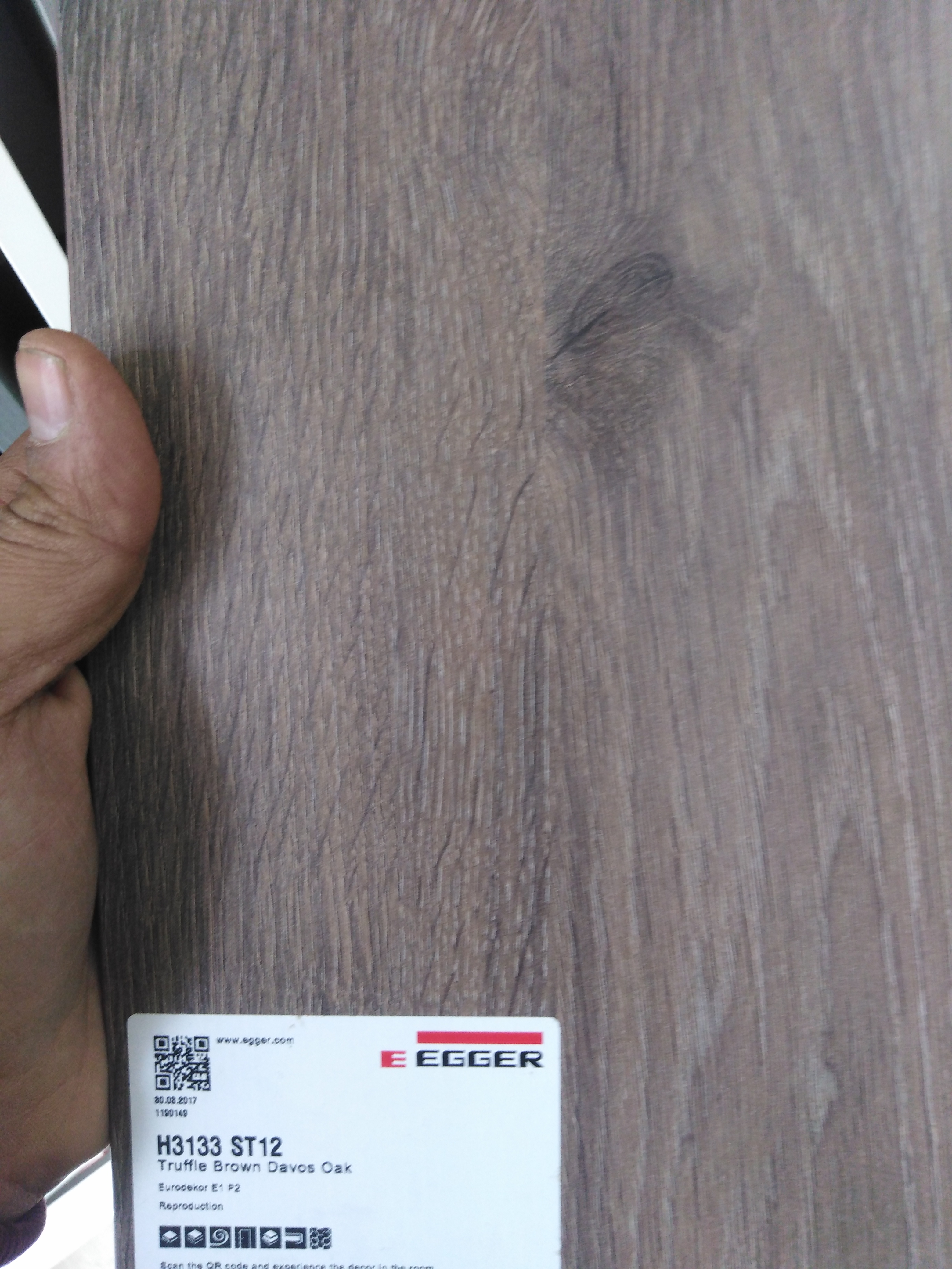

Hello hope your doing great
I have a small project wall cladding and an entry door located nearr a kitchen made with this egger laminated board i have to make my wall cladding and entry door using oak veneer any one can give me a hint to stain oak to look as close as possible
I tried staing my oak with white stain and then adding some grey
Any help will be much appreciated
Thank you

I just finished a large white oak entertainment cabinet with almost an identical look.
I use GF rtms stains. First I stained with diluted raw umber stain (3 pts RU to 2pts H2O). Seal, very light sand w/400 and wiped with synthetic steel wool.
Next I glazed with a 10-1 mix of 10pts white rtm and 1pt black rtm.
The look depends heavily on how well/even you apply the glaze. If you're not very experienced have an extra hand around to help and possibly use an extender to slow drying. I use Viva towels to wipe.
The reason to not over sand is the gray glaze with really bite if you do leaving too much black in the grain pores. You could also experiment with applying two coats before glazing.
good luck
