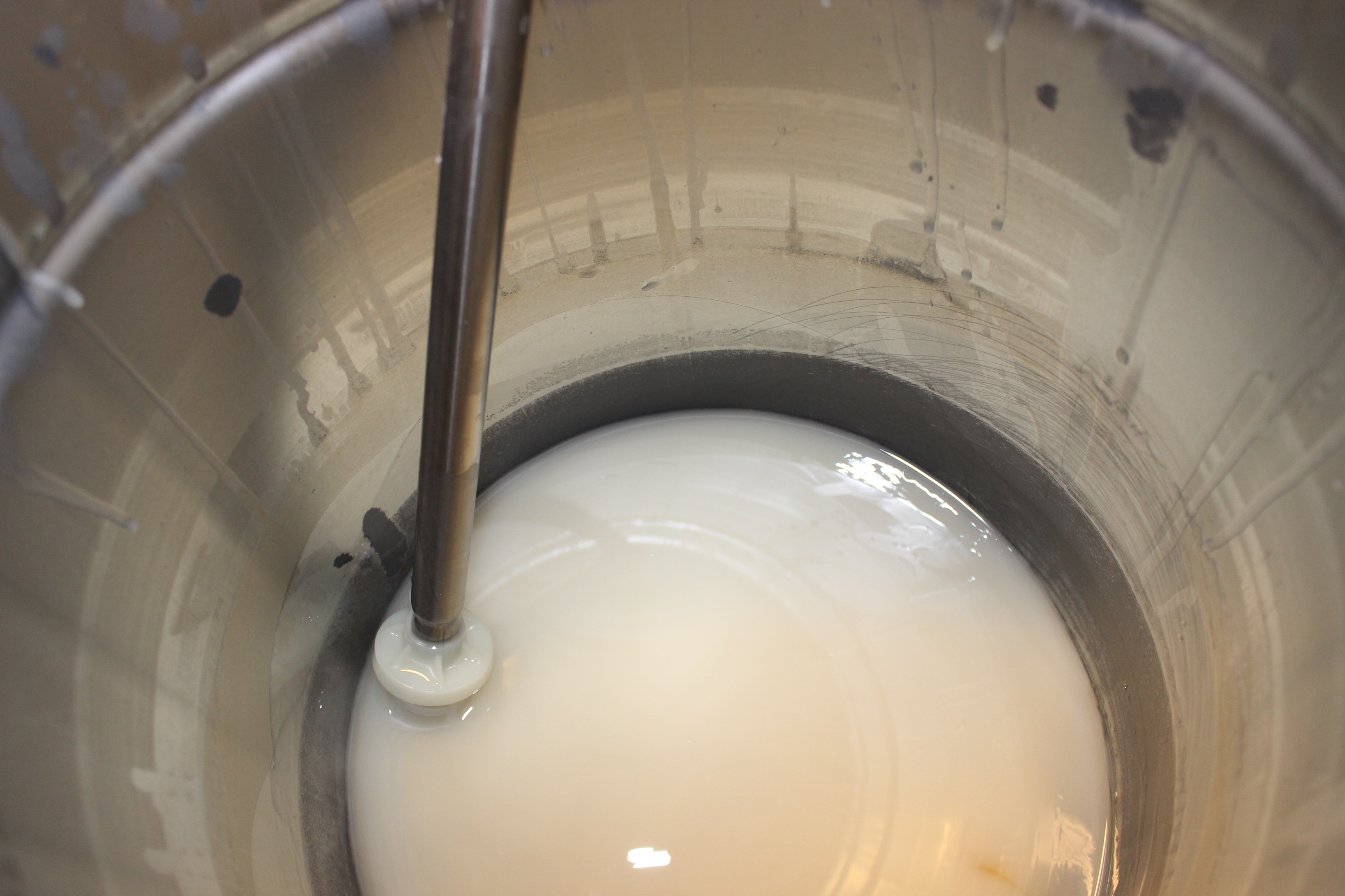

Have seen a lot of problems here regarding microbubbles regarding laquering/painting. We thought for a long while we had the same issues, but after a lot of testing we found quite surprising result.
Our system is Kremlin airmix 10/14 with MVX-gun.
Problem is with clear laquer (2K Sherwin Williams) and we get sand-paper finish. At first glance this looks like microbubbles or solvent-pop, but it is not. After taking samples from our buckets of laquer we disovered a lot of micro particles . Have a strong suspicion these particles are metal.
Have anyone experienced that mix of laquer/hardener/thinner can 'eat' metal from suction rod and metal filter even thought they are stainless steel?

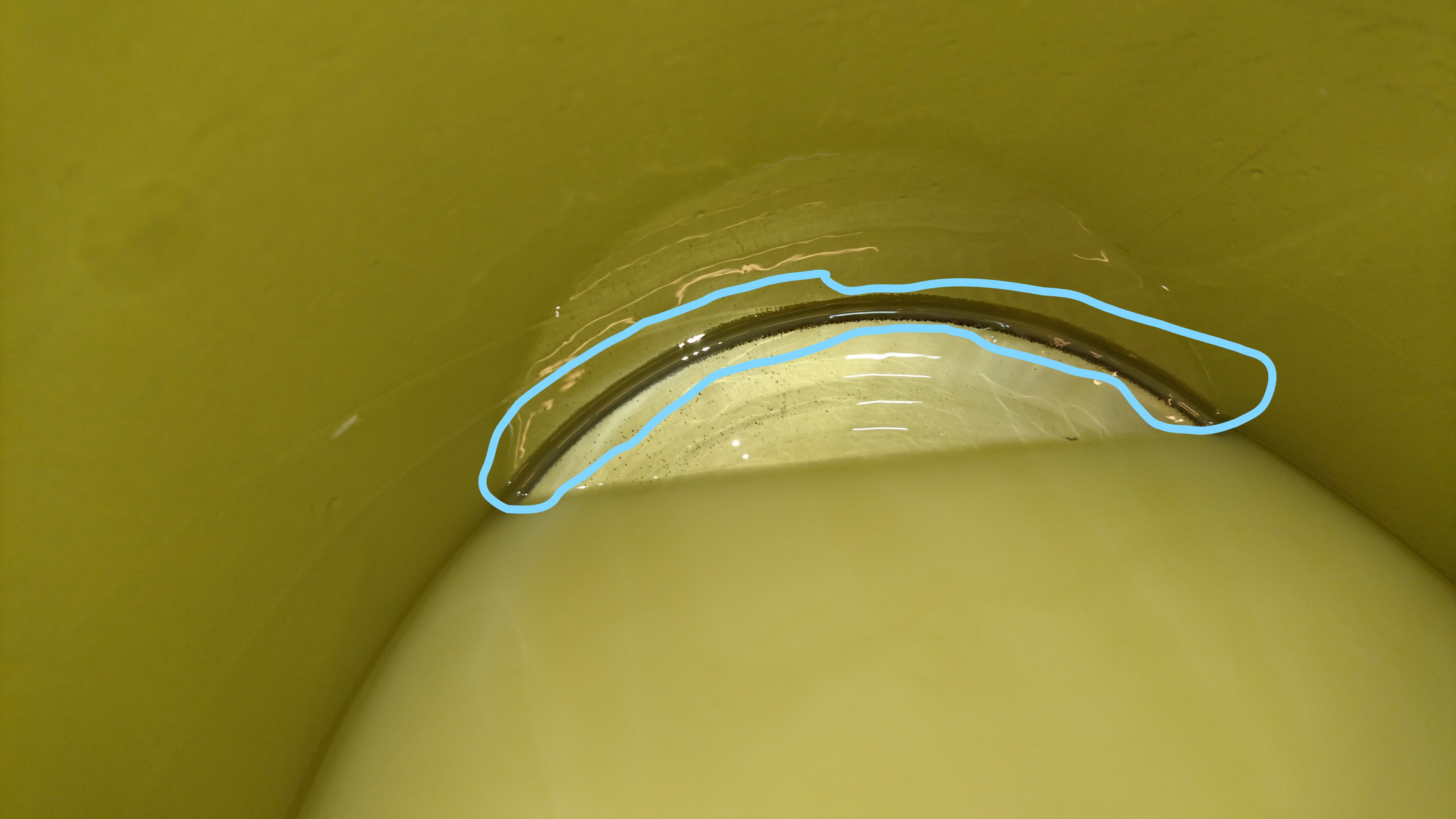

Enclosed is 2 pictures showing problem with acid hardener 'eating' metal. As we had this problem earlier we now only make mix in plastic buckets instead.
Its very frustrating this problem now again returns..
View higher quality, full size image (3456 X 2304)
View higher quality, full size image (3840 X 2160)

are you mixing the product in the stainless bucket? looks like scratches on the wall.
what are you using to mix? i would use a plastic bladed mixer or go back to the poly liner

We are not mixing into metal buckets anymore (only plastic buckets) cause of problem you see on the pictures. If buckets are not properly primed (or not primed at all = first picture) on the inside from supplier, you will get this problem. Question here was if someone have experienced 'reaction' on metal filters/suction rod using Sherwin Williams clear laquer?

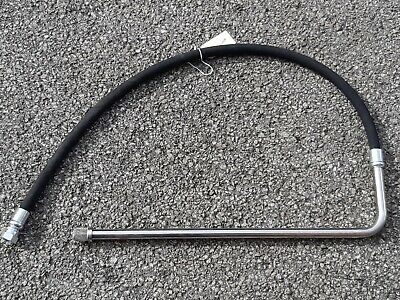

We use suction rod and filter as in the attached photo.
