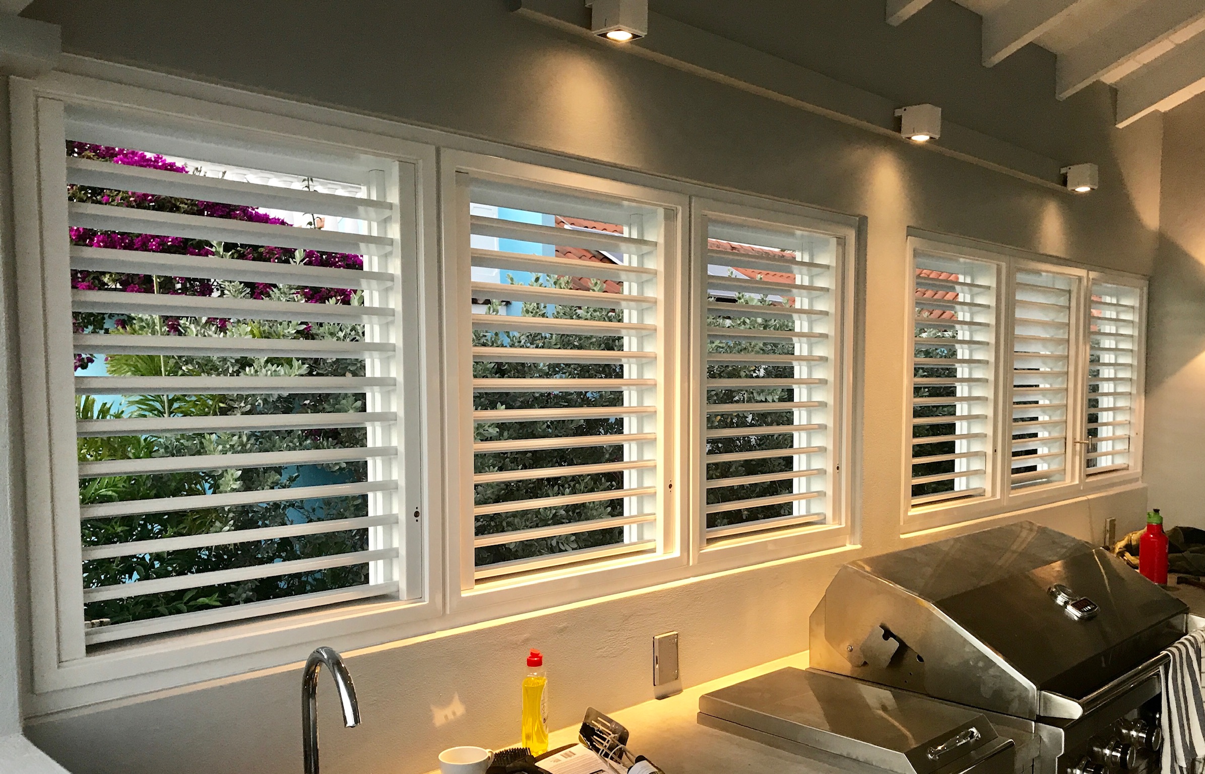

I'm looking for a waterbase paint system for brand new exterior doors and window units:
1. made from wood (Sapele, so a stain blocker)
2. in a spray shop and only touch ups on-site after install.
3. production so multiple units, painted interior and exterior in one go.
4. in the Caribbean, so UV filter and heat happy.
5. luxury market so finish quality important
6. "Operable louvre" windows and lots of moving parts, so reasonable full cure time to prevent sticking.
7. 1k if at all possible because I'm going to have to train unskilled labourers... maybe option of 2k later.
8. only two paint dealers on the island: reliable but not expert SW dealer and unreliable BM/Kilz/Insl-X/Zinsser dealer.
I’ve got a large contract if I can come up with the right paint schedule. I can order in paint that they don’t stock but nothing too technical to tint, or independently if I can have the option of tinting myself if I import the right machine. I am a furniture maker and have been using waterbased ProBlock, then SW Premium Wood and Wall Primer and SWEU just because I can get it. Now I'm looking at much bigger contracts painting of production doors and louvre-windows in sapele from larger local manufacturers. If the system also has products for cabinets and furniture, it would be great to use just one distributor and not have to use my old paint schedule. Ilva? CIC? Envirolak? Or is there something that BM or SW have, that would work?
