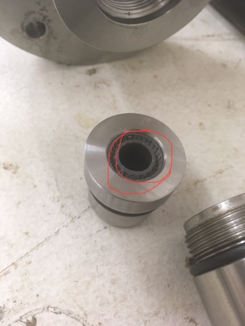

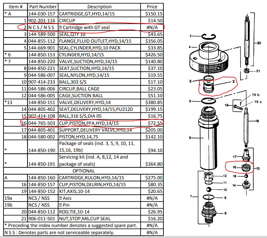

I'm getting material bypass into the oil cup at the top of the pump. I have had this pump rebuilt several times, last time piston and cylinder, but this keeps coming back. I never really have a good idea what they replace when they do it. The check balls seem good, can I just get by with the seal at the top and the bottom piston cup?
The top seal I can't seem to find a part # for does that whole metal part have to be replaced to get a new seal?
Where is the best place to source these parts.
I could use any knowledge I can get. Thanks

did you replace the piston rod? if so , did you insert it from the bottom of the packing to the top, or from the top of packing to the bottom?
good luck
herb j

When it was rebuilt last they replaced the piston rod. I don't know how they took it out. I think I pulled it out the bottom. Which way is right?

Contact nothart in Winnipeg canada. They wil help you out easy peasy.
