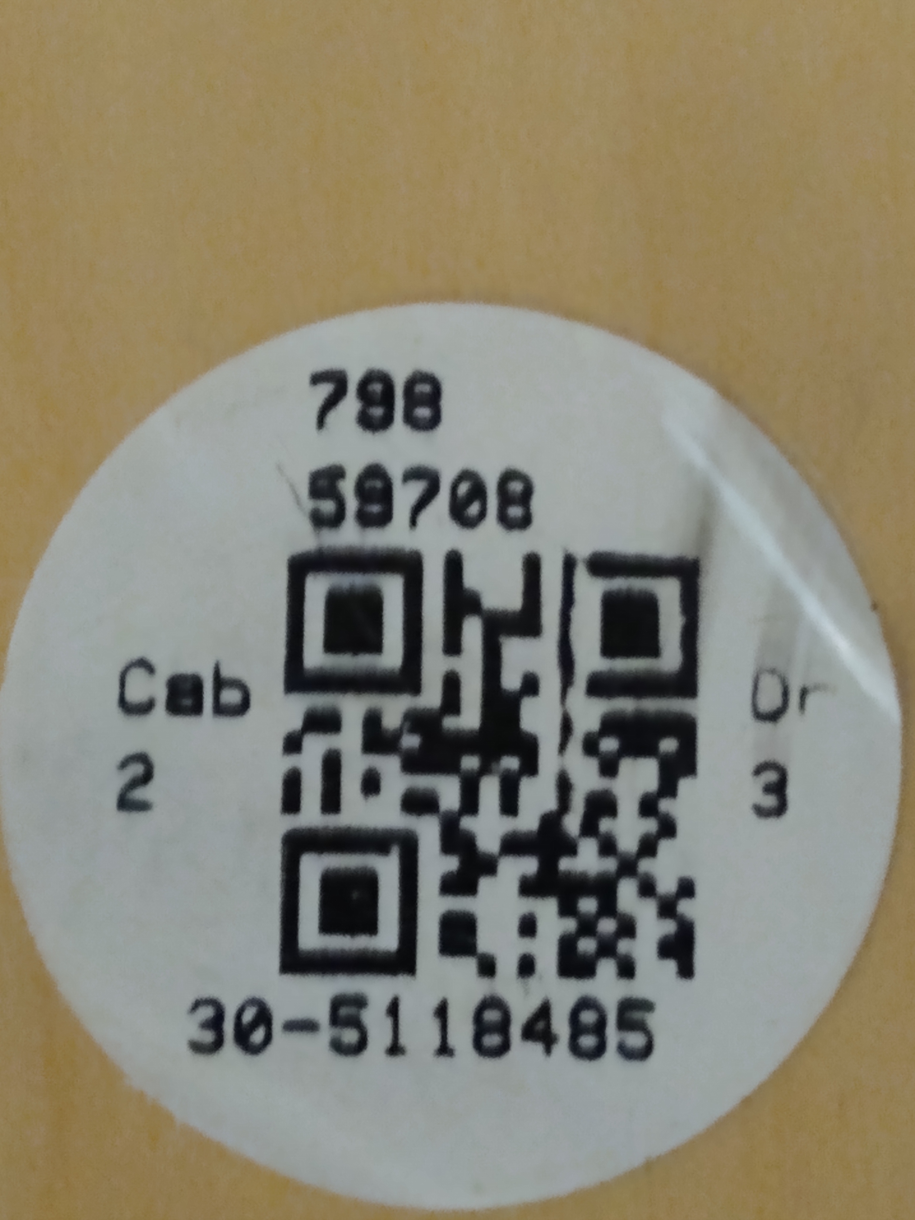

"Someone should invent a small programable computer chip that fits into the hinge bore.Then you could scan it and it tells you what door it is."
Something like this?
A little sticker that fit inside hinge hole
View higher quality, full size image (3072 X 4096)
