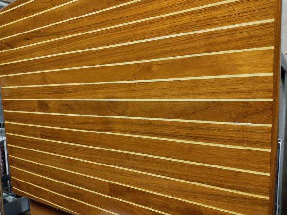

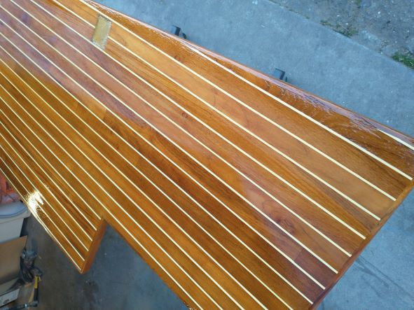

I am getting there, Devilbiss is doing the trick. Still reducing 25% but with a few more coats should be ok. Custom made sole with honeycomb and strips of teak. The amber varnish mess up the white caulking.
View higher quality, full size image (591 X 443)
2/10/22       #13: Epifanes clear varnish ...
It doesn't suprise me that you are at 25% with a 1.4 tip. The varnish is pretty thick. Make sure you stir that really well or you may get solvent pop(areas of extra solvent that evaporate faster and leave craters).
