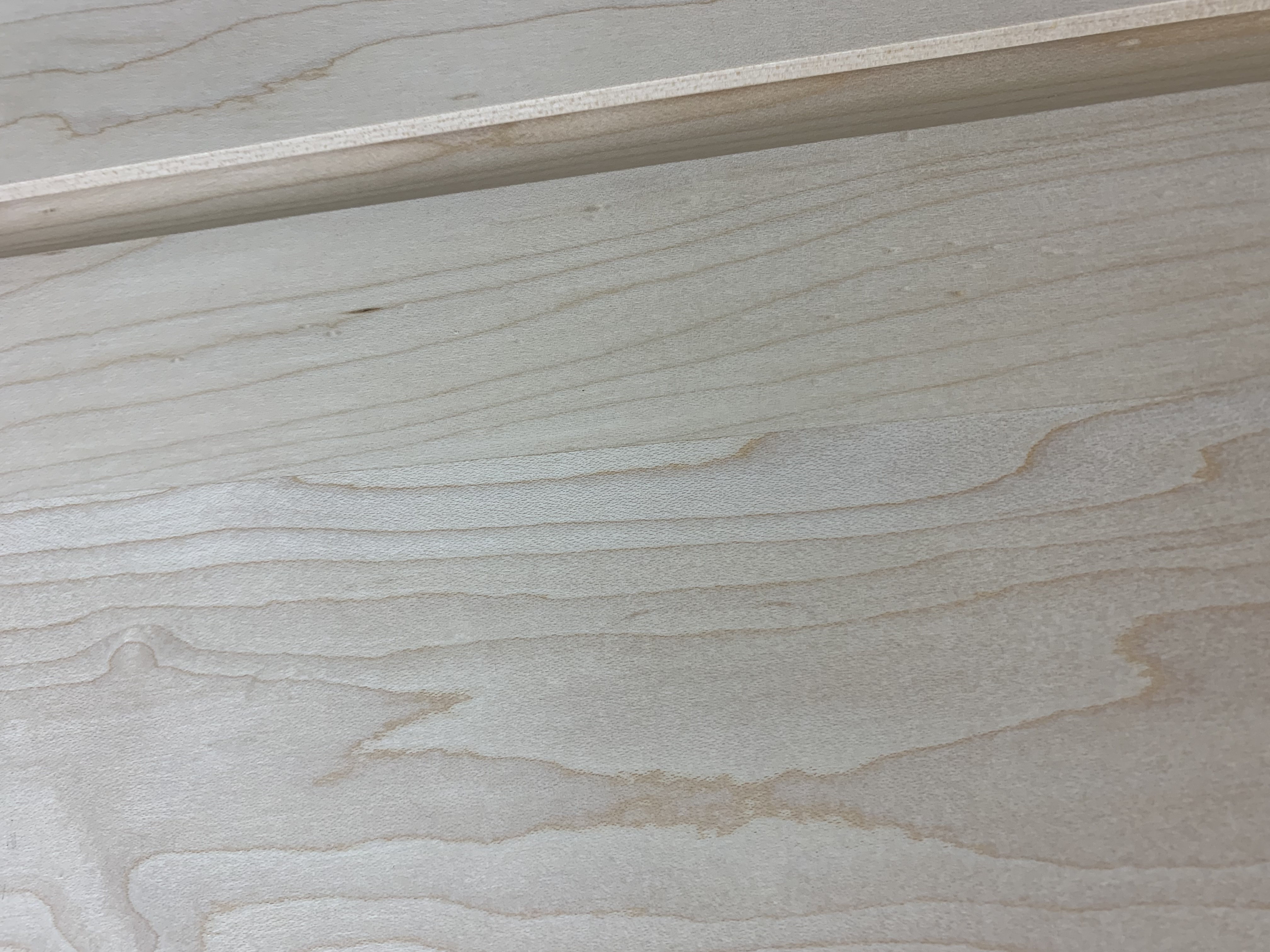

We have always used conversion varnish on our products. However we were trying out the Sherwood waterborne white topcoat. The samples all went great and it appears to be a pretty good product. However as we decided to spray an entire project we have found glue lines showing up through the paint. If I spray the panel with conversion or an oil base primer, or even spray paint it looks great. The cabinets were all sprayed already so I can’t just switch back to conversion as I doubt the doors would ever match the cabinets. Any suggestions on a non waterborne primer that could be used that waterborne would still stick to? The Sherwood doesn’t seem to want to stick to the various products that I have tried. Trying to get the glue lines sealed in before applying the waterborne… or any other suggestions??

Look at all the grain showing. not scuffing enough, not enough primer/coats and open unfilled glue joints. not being a wise guy but that is what I see. if you are going for an open pore look you will have to fill the glue joints if they are open like that. maybe a good inspection light will help you.

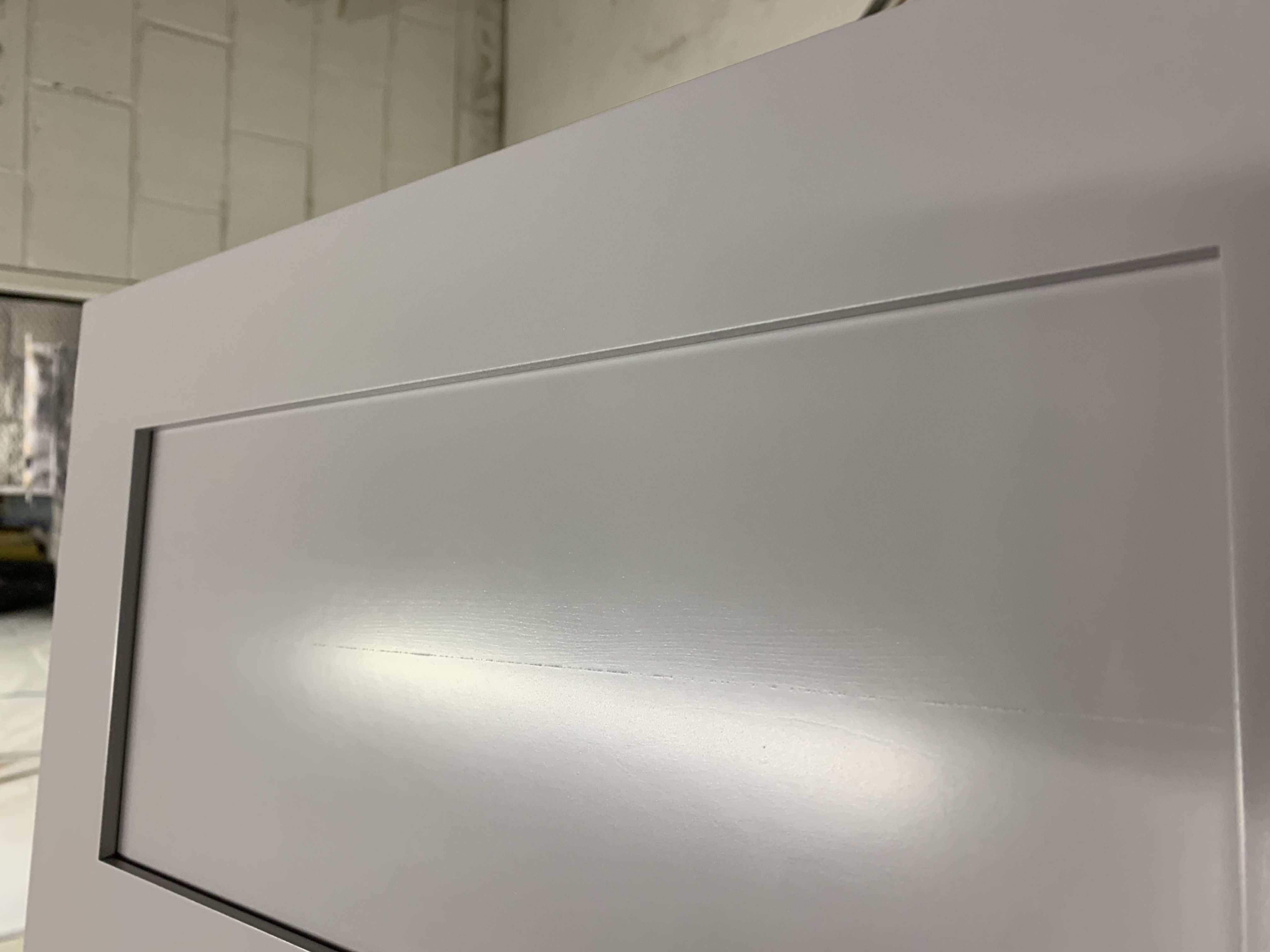

Water bourn products can cause poorly glued veneer flitches to swell and cause those glue joint issues. That's why you don't see them in the solvent as much because the wood doesn't swell like it does with water. If you are going to use water, the veneer has to be a better quality.....

Thank you for the responses, the picture is after the first coat and before scuffing. This picture is after three coats. We can scuff and fill and it looks good but then opens back up when sprayed again. These are solid wood doors and the paint seems to be reacting to the glue itself.

If it’s your standard WB wood glue- yep it’s going to react. You are basically soaking it and leaving water on it for half an hour. Each repeating coat your rewetting and leaving the finish in its own solvent of water. Eventually the coating will be hardened enough to withstand 30 minutes of direct water. But not with the dry time is has in between coats. The answer is to probably look to new glues. Something with more water resistance. This is one reason why still most seal coats in WB systems are at least a hybrid shellac or other and not pure WB. WB is a fine finish but not for sealing wood in my opinion. Beyond that you bet.
If I misspoke please forgive me. My last attempt at WB was ten years ago and it about killed me. Yeah, it’s healthier for you -if you can withstand the stress which triples and the workload which doubles to get a slightly inferior product.

Non waterborne primer for waterborne is easy. Zinsser BIN white shellac primer.
What glue was used? I'm guessing Titebond 3. That is a ton of telagraphing. We primarily use MLC waterborne products. Their waterborne primer is excellent.

Jeff, you're not alone. I have seen this myself with some outsourced doors we finished with white waterbourne Sayerlack. I plan on trying zinsser bin first on a test glue up using titebond one as that was what was used on the doors and see if it makes a difference.
