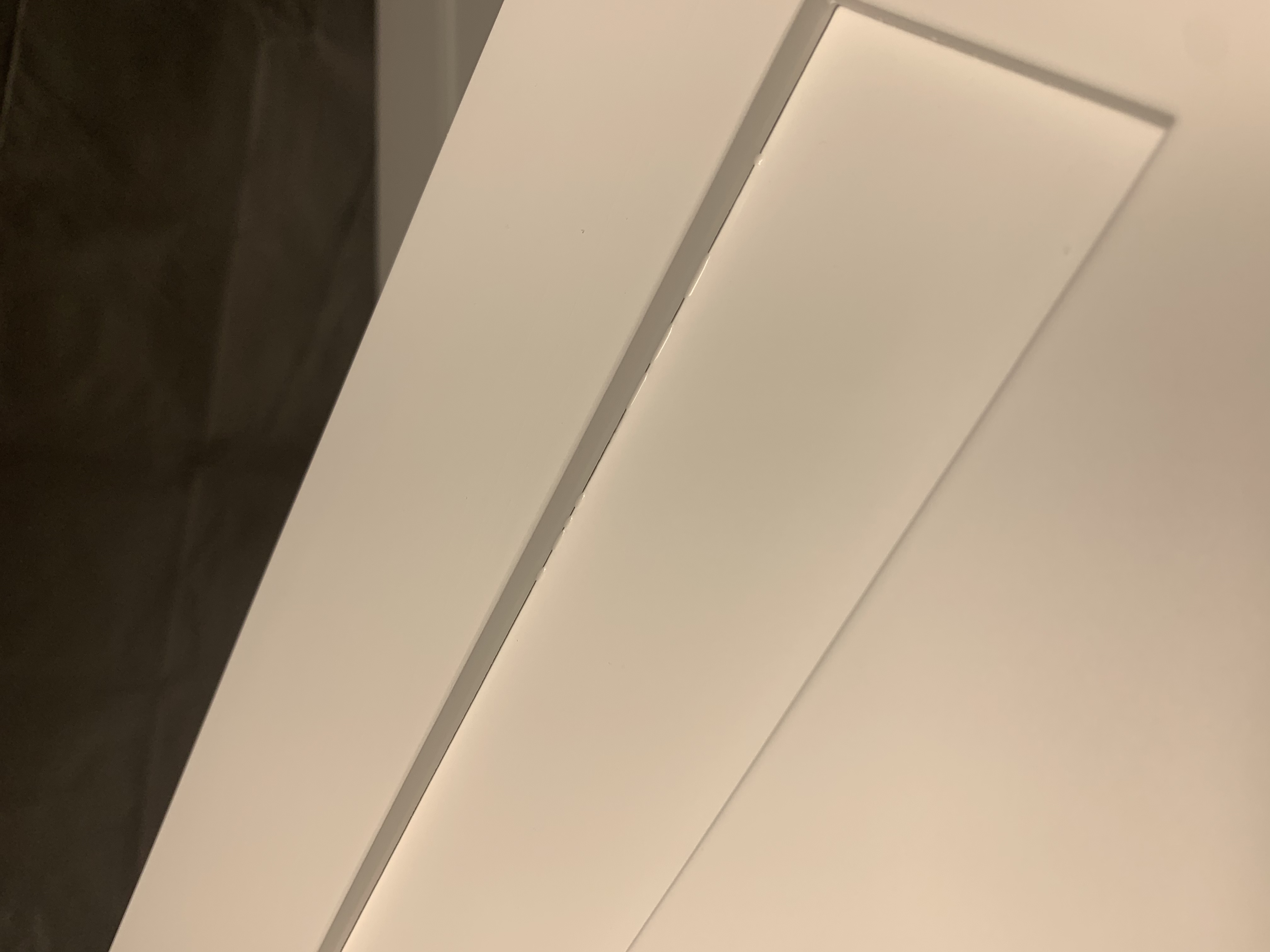

Just curious who caulks the panel to stile and rail joint. Or do you prefer a crack. I have some doors, the panels are mdf and are glued in. It seems like the joint varies in size, I primed them and not sure what I should do? I know you don’t want your paint to bridge as it could crack later.

Textbook says no finish manufacturer wants any caulk under their finish but a lot of people caulk a lot leave an intentional radius there. Search the archives theres miles.

Ya I know most people don’t recommend caulking, but the panels are glued mdf so I don’t think there will be any movement.

No cabinet factories caulks their doors as far as I know
For me,I try not to but sometimes I come across a job where I'm painting stained cabinets and when the first coat of primer goes on I can see all the imperfections
Many of those jobs have inconsistent/large gaps where the panel meets the R&S
So I caulk
I don't want to but it does looks better
I use clear caulk instead of white
The clear wipes off much cleaner
I keep my bead small and don't smear it
I have yet had any call back about cracking/separating
And I do put another coat of white vinyl primer after caulking is done

Do you use something like Alex clear (latex/water cleanup?).

I have used the DAP Alex clear
But mostly use the
Phenoseal brand

If they were glued in properly with enough glue, then they should not crack. Caulk is a mess, and like others have mentioned the finish manufacturer's certainly will not endorse it. If you are using an acrylic waterborne house paint as the topcoat, the caulk won't case any issues.
