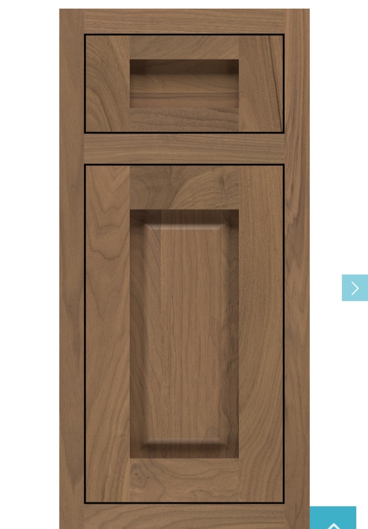

Tony
Similar to this pic if it will load:
