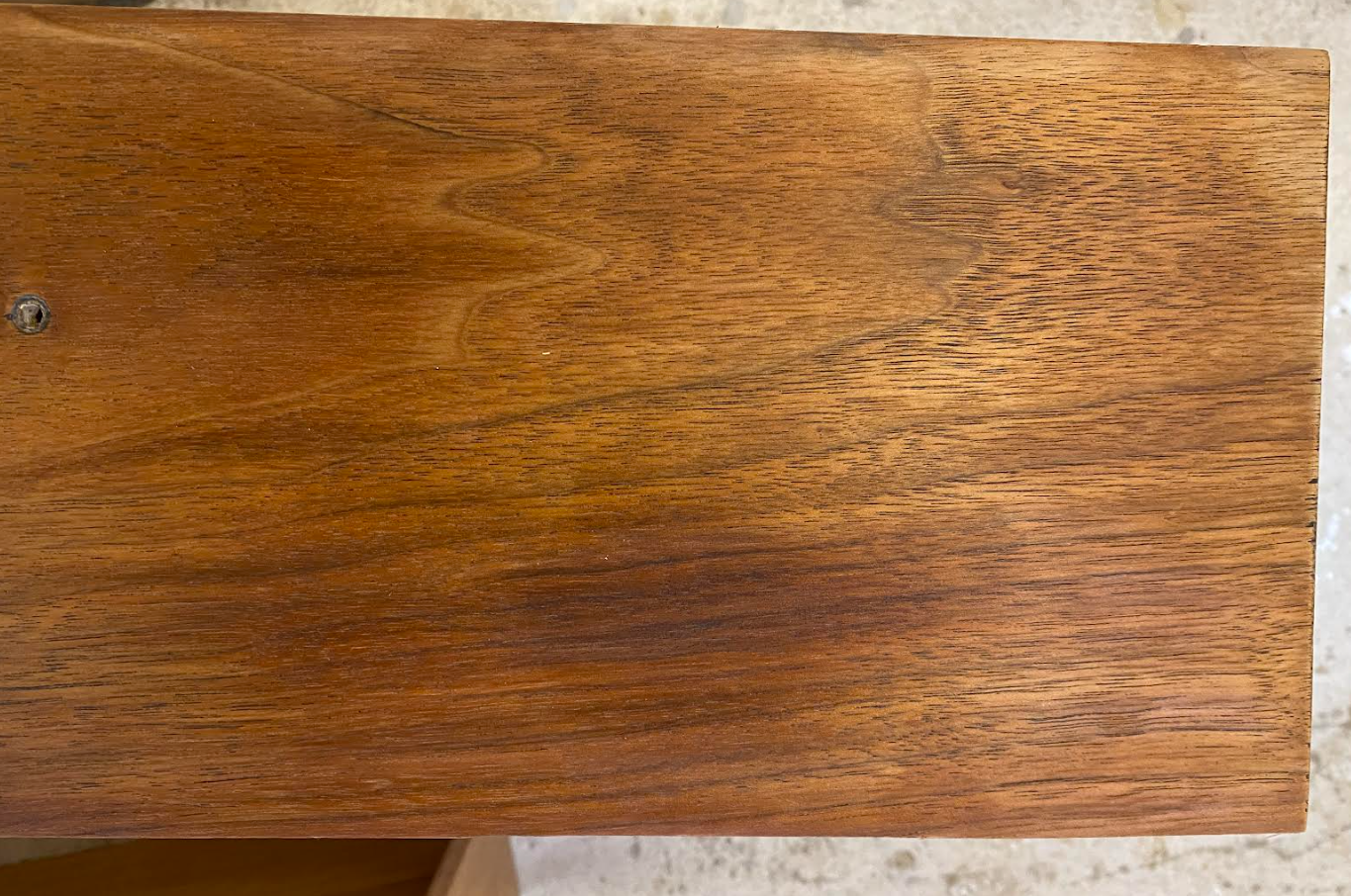

Hi,
After removing coats of shellac from an 1958 dresser and sanding with 120 this is what the drawer fronts look like. The dark areas are visible dry, but here I wiped the fron with a wet rag.
The dark areas are about 6th deeper than the rest of the front. Veneer is very thin , and further sanding does not help to lighten the areas anyway.
What is the recommended way to equalize the finish acros the drawers ?
(approx 2x6 front area)
All the best,
Lu
View higher quality, full size image (1365 X 906)
10/6/22       #2: Splotchy fronts ...
Looks like contamination and not a wood issue. Maybe try some lacquer thinner and Scotch-Brite? After that I think you will be looking at a thin layer of dye, spray on toner, or a glaze after the first coat of finish.
