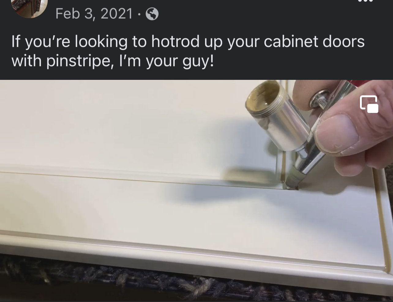

For speeding up the glazing process, as anyone seen this tool or something better? Know what it’s called and where to buy it?

It looks like a standard air brush spray gun?
CA Tech. Makes a glazing gun
It's like their Tjr mini gun but with a long nozzle
Don't need to hook up air line just let gravity do the work
Personally I don't like the look of that glazing technique
I like to apply by hand and wipe off excess

Eric Reason did a video a long time ago using just a squeeze bottle. Like Mastercab said, Ive seen the gun with no air before but it would seem pretty rough with just gravity but thats just a guess. The roller tools would see a better option but no good for the corners.
https://www.youtube.com/watch?v=81IjU5Zmb2Q

The idea of glazing is to provide a worn look or to show a depth effect with the color. That tool lays down what looks like a bead of caulk! Way too uniform looking!

Thats not true anymore Rich. Whether you like it or not its just not the case. All you have to do is google pinstripe cabinet door glaze and go to images, or just walk into any of the big box home centers, to see that "glazing" has become just a dark/dirty corner. There is no shadow effect. Its too much work for the mega cabinet manufacturers so, as always, they have recreated the customers concept of glazing to be a relatively sharp pinstripe.
Can kick and scream all you want.. its the new normal.

i use the cat glaze gun, with the pps cup set up , a no brainer..
good luck herb j

Hair color applicator bottle
