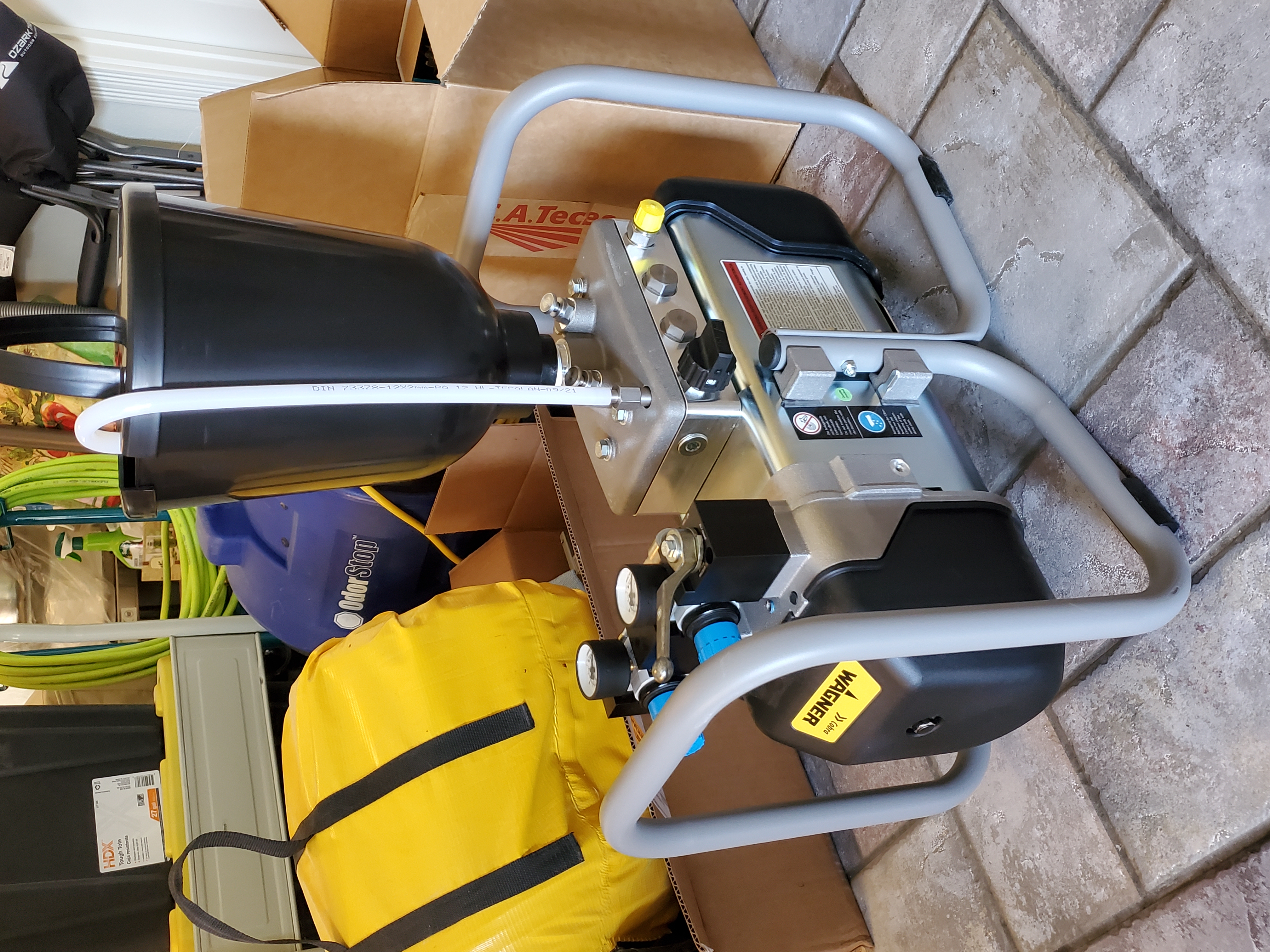

1 wish I could swing the Wagner cobra diaphanous pump but big bucks there

Yavuz Member
Definition of a beast.
Purchased a year or two ago from CET INC.
CA tech 14/1 and Cobra made great team since.
1/1/23       #10: Kremlin pump ...
herb johnson
they are virtually trouble free pump, main thing is to change the internal oil which is very easy. just don't run them dry , should be a lot of video's on them and very little to no support needed. pump will run easily on ten psi of air.
