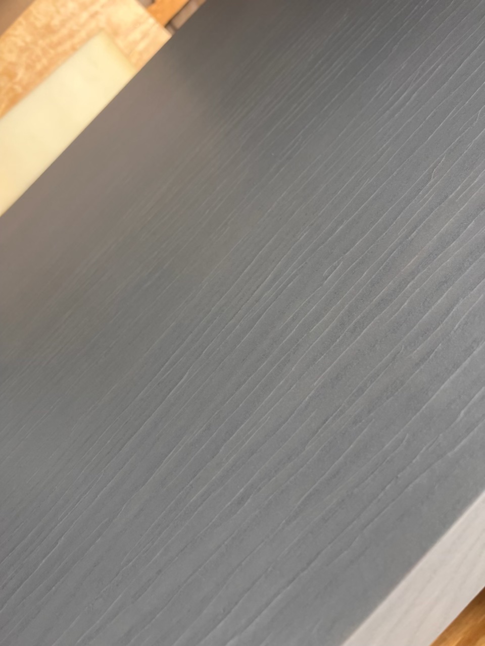

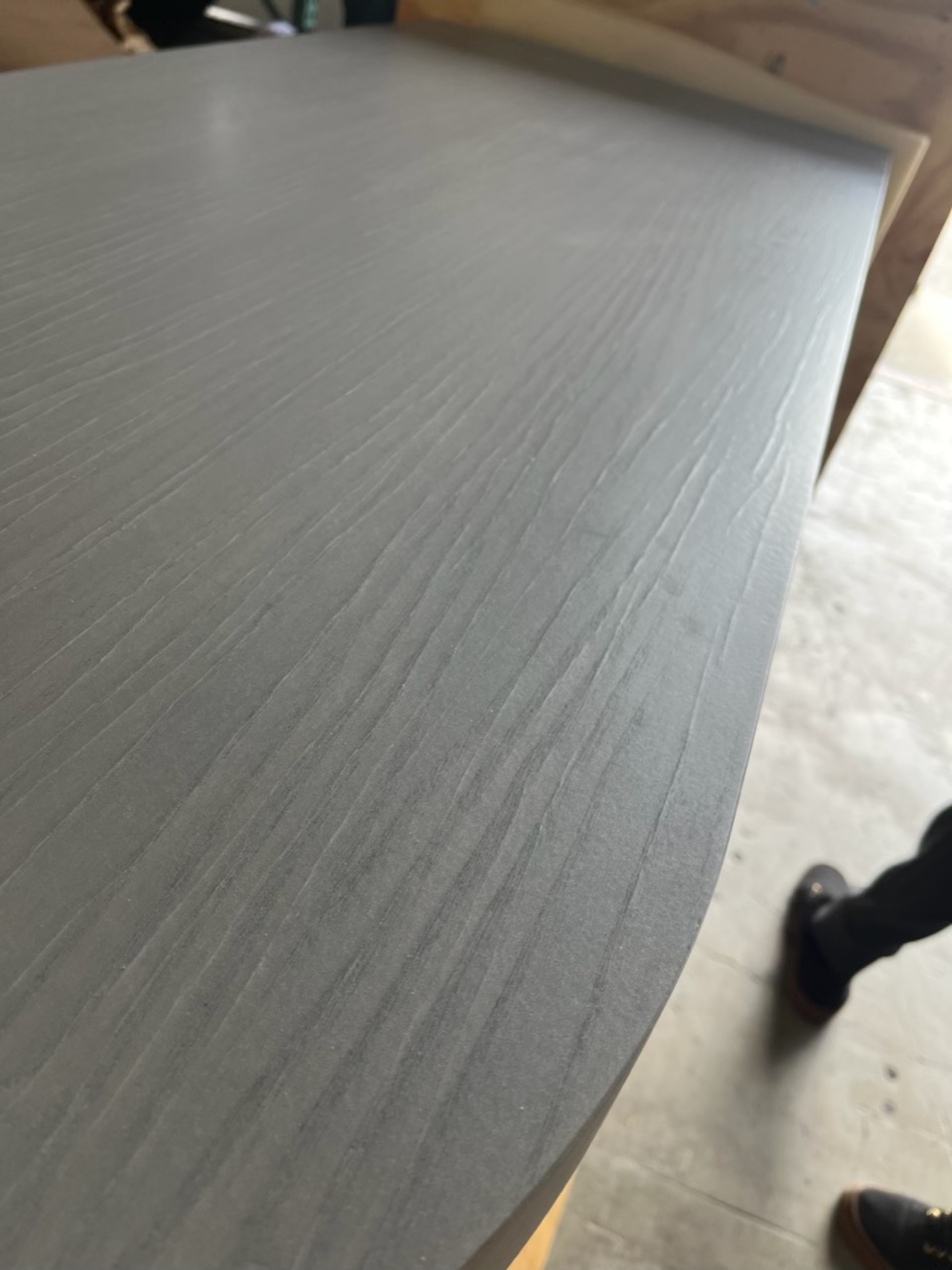

Hi All,
I am kind of at my wits end with a finishing issue we are having. I've had the issue occassionally in the past, but not as bad as the last few months.
The finish is cracking really badly within the first few weeks of the piece being done. This only happens on veneered pieces ... never on solid wood. It seems like the veneer is shrinking slightly after the finish is applied, but it does not seem to matter how long I let the veneer acclimate, or how long I wait after veneering to finish the piece.
The particulars are ...
20mil paper backed veneer
applied with 3m water based contact cement
Substrate: Usually MDF
Finish: Varicure Pre Cat 10 sheen matt
My business is located in Tucson ... an extremely dry place. Currently 12% humidity and will top out at about 30% sometimes during the rainy season in Summer. The problem seems to be worse in winter when the humidity is super low.
Any thoughts?
