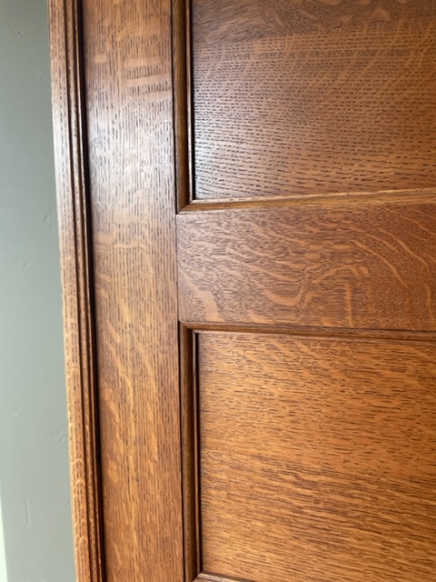

Any name brand random orbit sander with eight holes and vacuum attachment. The key to perfect stain job grain sanding BY HAND with a hard wood or melimine block. 180 grit for penetrating stain and 150 for gel stains.
After machine sanding repair any dings, chips, gaps (old or antique doors) by placing blue tape right on the edge of the repair to stop from filling adjacent wood pours. I like Elmer's wood filler as takes stain perfectly fill and remove tape when its still wet. Let the filler dry and while its drying put tape on one side the perpendicular grain style to rail interface line on all. Sand by hand on the un-taped side with the grain going fast with light pressure to remove any swirls from the sander. Switch the same tape to other, now sanded side of the line, and sand the grain by hand. Sand the panels with the grain by hand and use rubber sanding pads for moldings.
I did 13 100 yr old 8' six panel doors and grain sanding was less than 10 minutes a side not counting moldings.
