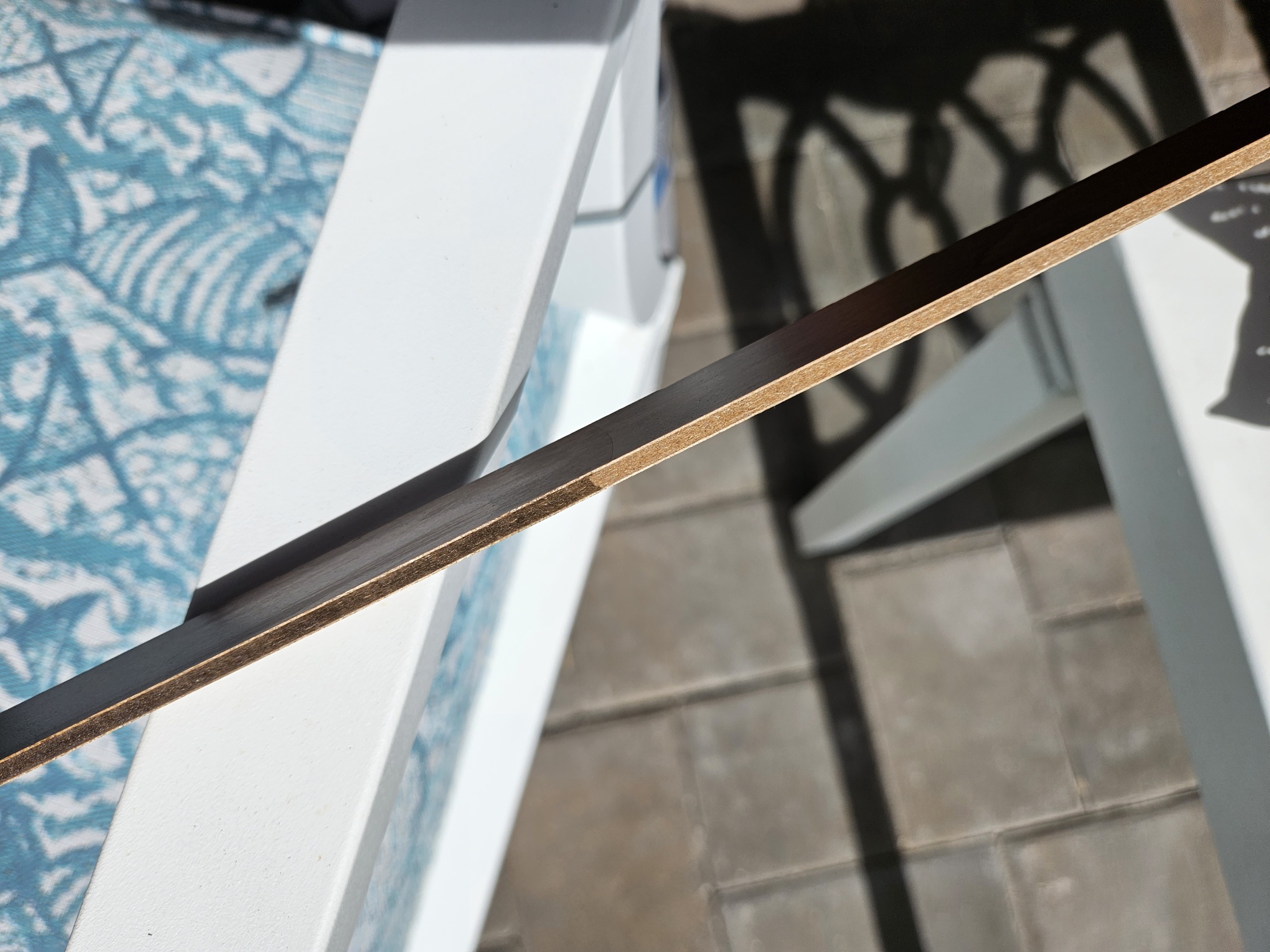

Question about finishing the edge of hardboard:

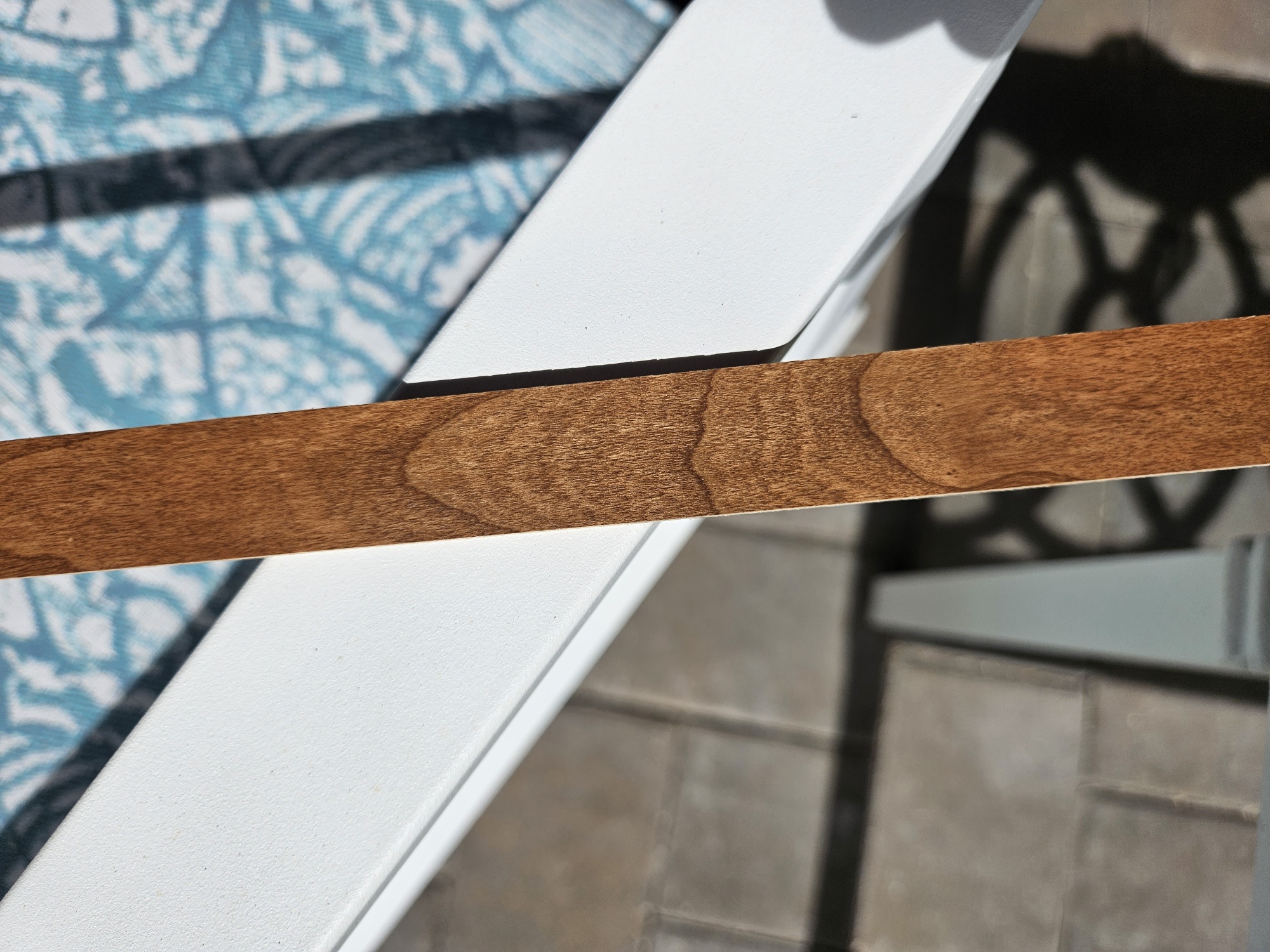

The cabinets came prefinished. They are made of cherry, stained "praline" and have a nice satin surface. The toe-kick is cherry veneered hardboard (first photo is a sample). One side of the toe-kick is finished. The edges and back are unfinished. In a few places, the edges of the toe-kick will show. Even worse, when the floor is washed, they could get wet, so must be sealed. I tested some stain on the edges and they soak it up worse than end grain, getting much darker than the expected stain color (second photo). Do you have any suggestions for finishing this edge? Should I just apply clear polyurethane and accept the color mismatch? If this were furniture, I'd veneer the edges, but can't do that for this job.
Thank you for your suggestions.
View higher quality, full size image (2000 X 1500)

The board is only 0.2" (5mm) thick.

Try painting the edge with a flat yellow color then stain that. Not a bright yellow but like mustard.

You're way over thinking this. Are they going to come in with a garden hose to clean up? If there is a cleaning/plumbing issue, a toe kick skin is the least of their problems. If you want use a stain pen on the miter cuts to blend the color.

Thank you for all of the tips. Al: I experimented with stain over yellow paint but couldn't get the hang of it. The stain just sat on top of the paint. Perhaps I needed a rougher paint or it's just an art that I haven't learned. Bart: You're right that I'm overthinking this. Polyurethane on my test scrap doesn't look bad, so I'm going to wipe on some poly and call it done.
