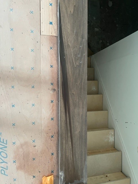

Normal wood grain or spill/defect??
8/21/23
Jeff Nielsen Member
Contractor says normal grain...i disagree...what do you think??
8/21/23       #2: Normal wood grain or spill/defect?? ...

8/21/23       #3: Normal wood grain or spill/defect?? ...
Tony
Poplar. Common

rick morehou Member
I agree with Tony on this. Question; What is going on with the bottom of this piece ?.

Matt Calnen
Looks like a bark intrusion to me.

Funny Matt! Maybe a bark inclusion? "That darned bark just keeps intruding in on my parties!"

It's very common to get batches of poplar that have long green & purple streaks. They turned dark after the stain was applied. When painting that flavor of poplar a stain blocking primer should be used. Normal.
